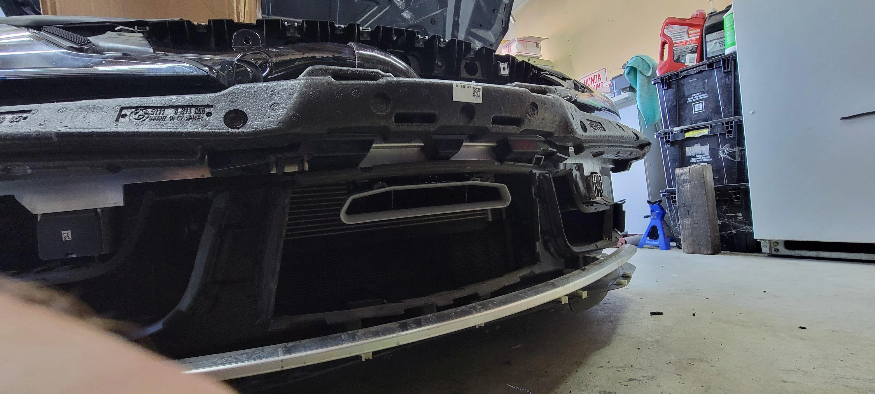

Im just shocked, from what I can see, that there is minimal areas on the front bumper that guides air to the intake, or am I missing something?
I had planned to purchase this as it seemed a good idea to ram air in that direction, however it is a shame it isn't fully closed!

Wagner/Kotte also makes a duct similar to this, but will require minor cutting. The front bumper definitely needs to come off. Here's the video

Damn their solution is way better looking than Velossa and Verus. YouTube video was very insightful, great info.
