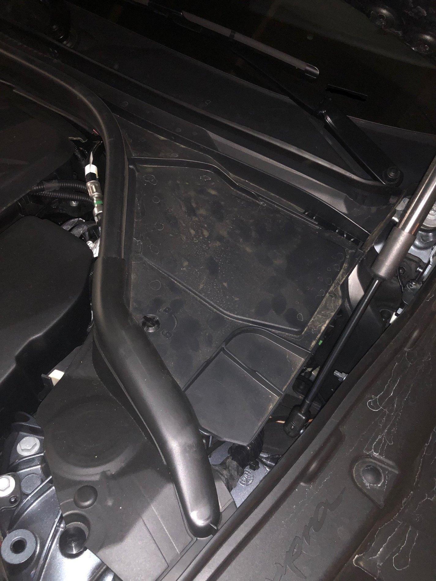

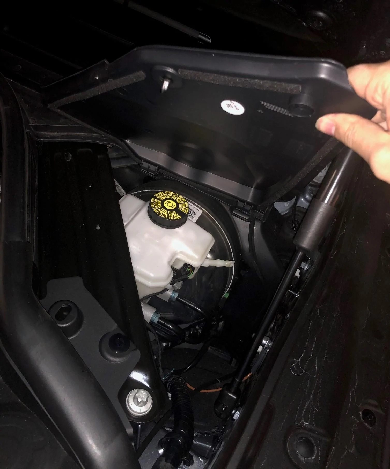

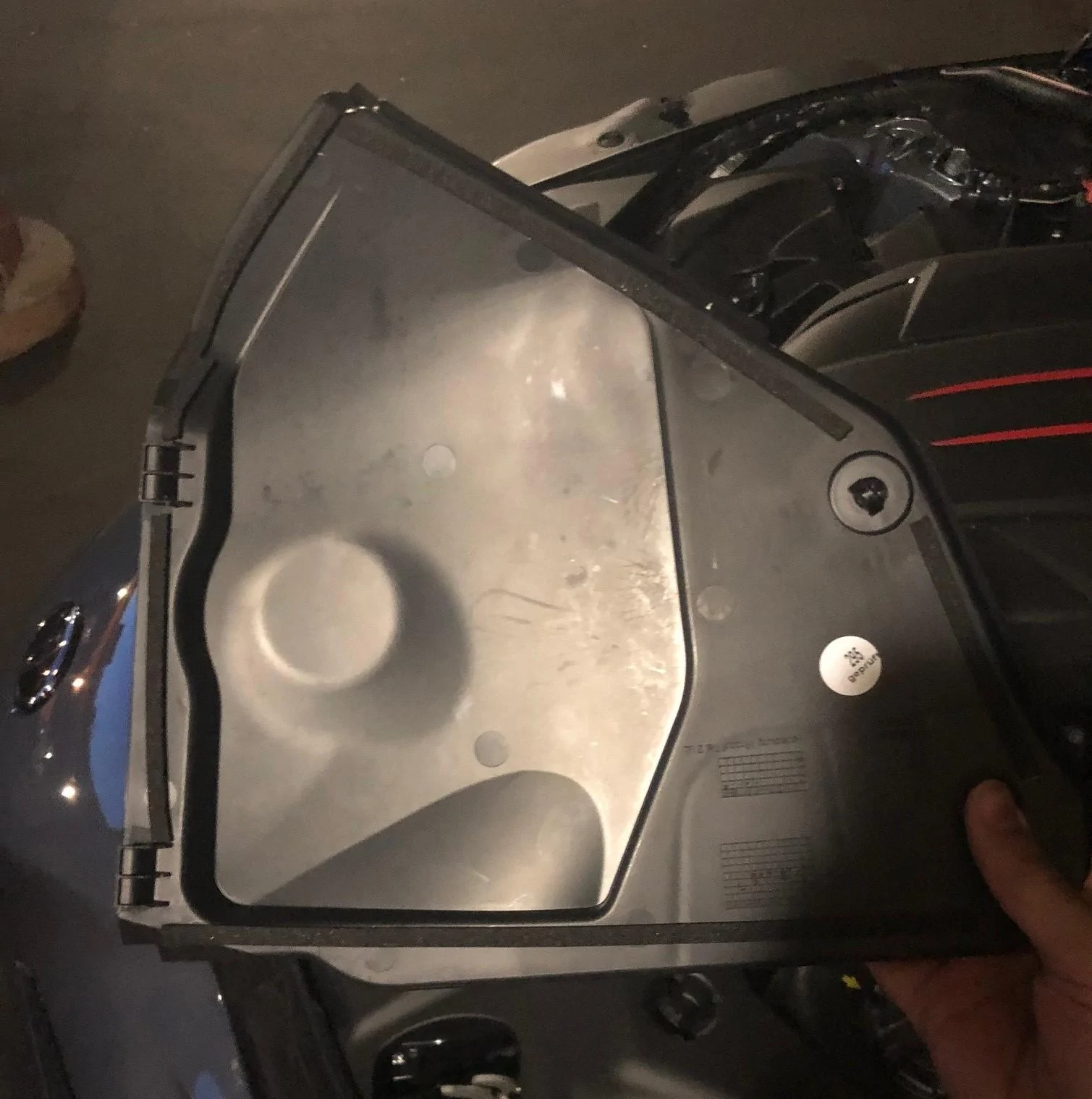

I've had rattles that sounded like it was coming from somewhere in the front of the cabin, sort of in the gauge cluster, so I tried adding some foam tape around a removable cover in the drivers side engine bay that rattled when I shook it around. I've only driven about 10 minutes with this done, but the rattle hasn't come back for me yet. I'll edit the post after I test this out more.
I'll definitely be giving that a test. Still think there's something in the steering column itself or around gauge cluster - to me it sounds like maybe a harness connector not solidly zip tied or sleeved maybe. Don't notice until rough road... then it gets annoying. However, your fix is dirt cheap anyway and can't hurt anything to try regardless! :thumbsup:
