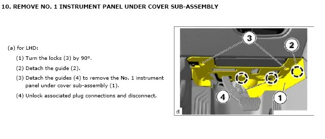

Still not having any luck hunting down the source of this soft tapping sound which seems to occur in the front cabin in the area between the steering wheel, center console, an above the accelerator pedal area ...There is definitely something lightly tapping against a panel ...This only occurs during initial cold startup and at a very narrow rpm range (600~650 rpm) ....Once I take it out for a short drive and return and park I can no longer replicate the tapping sound again at any low idle range...
I tried removing the plastic top cover under the drivers side footwell above the pedals and that did nothing to eliminate the soft tapping...

I tried removing the plastic top cover under the drivers side footwell above the pedals and unfortunately it did nothing to eliminate the soft tapping that I'm experiencing...
There is definitely something lightly tapping against a panel somewhere else...This only occurs during initial startup and at a very narrow rpm range (600~650 rpm) ....Once I take it out for a short drive and return and park I can no longer replicate the tapping sound again at any low idle range...

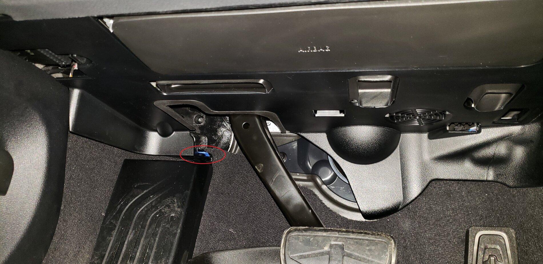

I had this occasional metal to metal rattle over sharp bumps on my Supra coming from the passenger side which I narrowed down to the passenger side seat belt. It did not matter whether a passenger wearing a seat belt was onboard or not.
Below is a picture of the anchor end of the buckle where the passenger would buckle up to between the passenger seat and passenger door. The plastic cover is pulled backwards to expose the metal parts.
I made a spacer shaped like the red line drawing with the blue dotted area cut out so that I could slide it between the metal parts. I used a polycarbonate sheet I had to make this (a little thicker than an over head transparency) to dampen the noise. I suppose one can try it using a note card.
Worked great, no more noise...!
