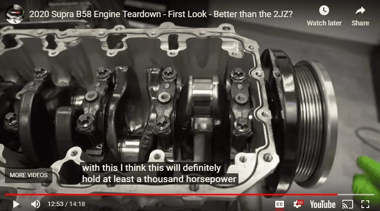

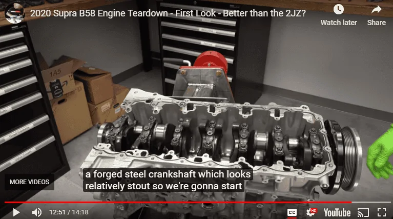

Time to put your critical thinking caps on. Here is the exact quote:
Only the crankshaft is referenced.
11:1 JE pistons
Carrillo Rods
Also of note: Goal is 1000HP on an engine dyno (not WHP)

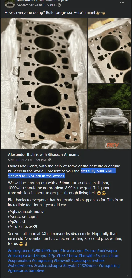

I guess it had to happen sometime.
A year and a half later, MKV Supra’s are making some crazy power figures. People have only begun to tap into this platforms potential. Once we see more secondary fuel systems out there or a complete DI swap, these cars will be in the 1500hp range (obviously with supporting mods). Super excited for the MKV, honestly never imagined it would be this good.

That’s very true. In this instance this was frequent drag car that was one of 3 cars that failed (from what most people think) because they leaned too much on meth as a fuel, and because of uneven meth distribution it leaned out on cylinder 1

FD? Also the response was pertaining to if someone would sleeve this block due to failure that causes shallow damage to the cylinder walls through its special coating.
