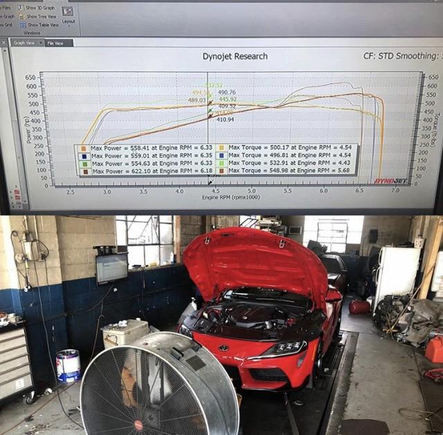

Good shit right herrrrrrr....
They will be replacing plugs soon and going for more power!
Hopefully it's simply a plug issue and not an overall ignition issue. n54's seem to get a lot of spark blowout above 23 psi and us bigger power guys convert to mercury marine coils or audi motorsport coils for stronger spark.
