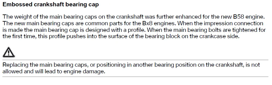

I don't have the metallurgy plug-in installed in my browser so can't say definitively, but those main caps certainly look like cast iron to me. Could also be steel, but impossible to say from the video (same goes for assessing power-holding..). Here is all the B58 tech doc says:
