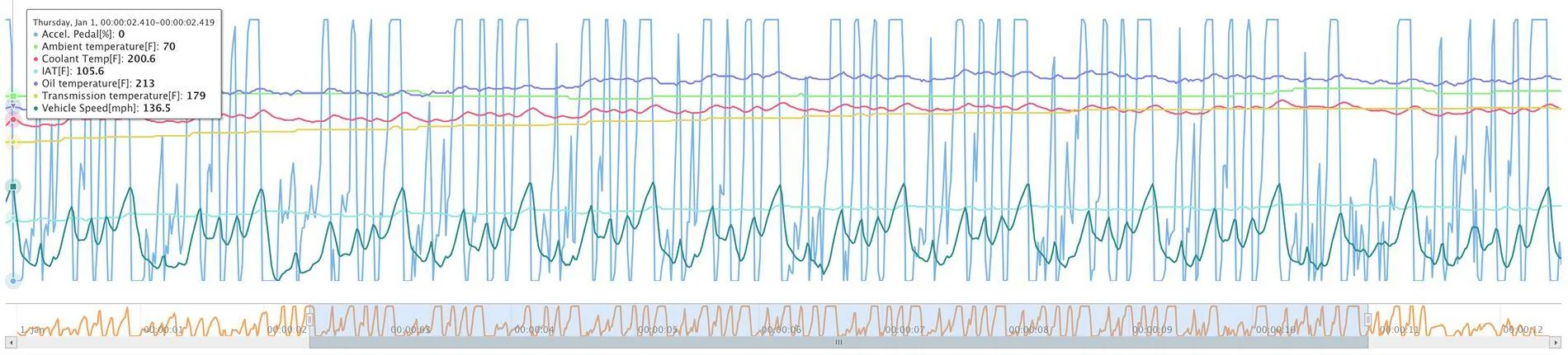

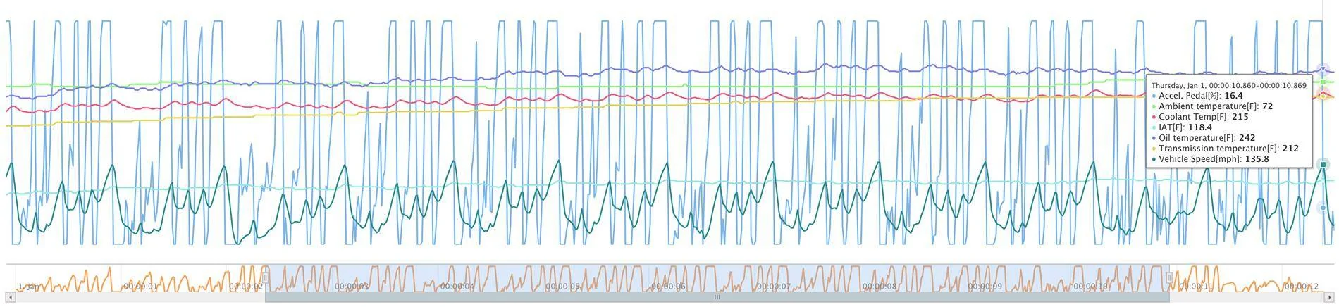

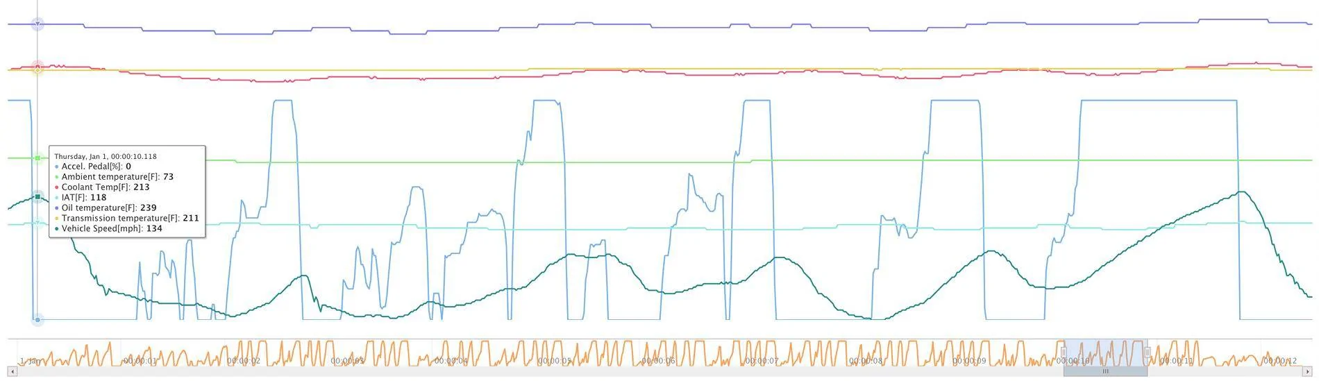

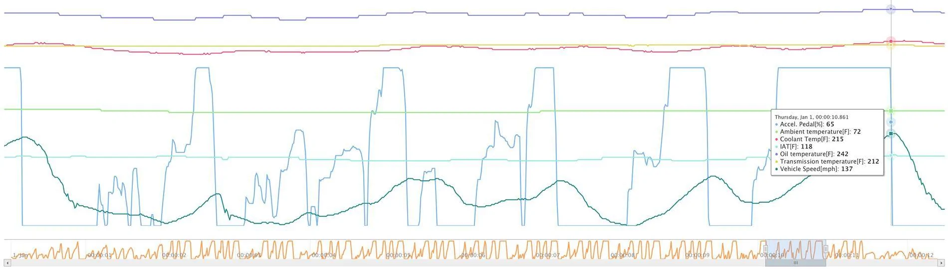

Here is another piece of data that shows what a good manifold can do.
13 laps in, every lap full effort because I was just staying out. Here is the FULL 13th lap.
IAT 118 at the end of the straight starting the 13th lap and IAT is 118 at the end of the straight after the full 13th lap.
And here is the FULL SESSION of 13 laps.
105 IAT at the beginning and 118 IAT at the end. A good manifold does this. Consistency.

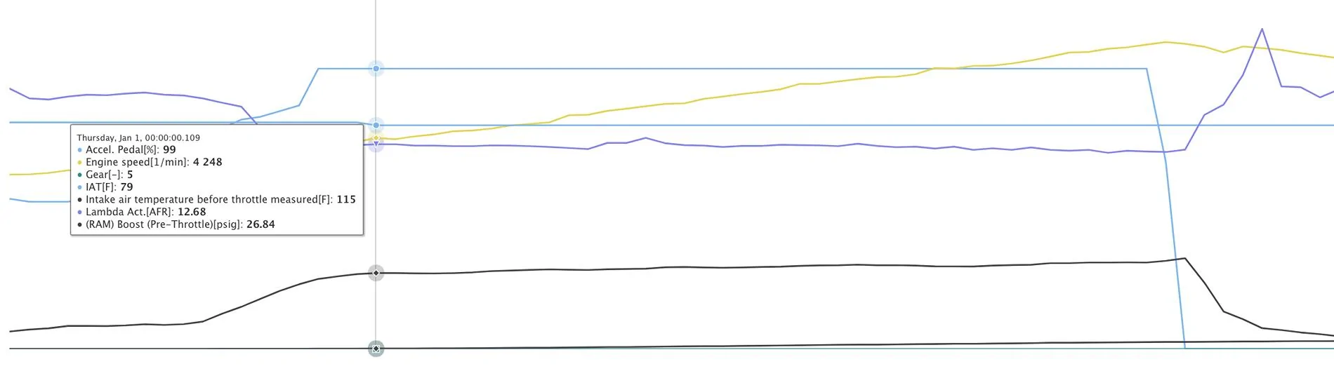

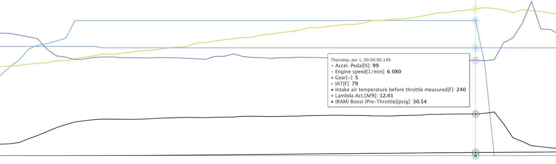

Def wasn't 87F ambient if your IAT's are below that. That is impossible unless you are running an ice chest.
Also, looks like you are maxing out your injector SOI in the higher rpm. (fill limit 8) and your AFR is a bit lean. Be careful!
IAT looks decent though, my wagner only goes up a degree or so during a single 5th gear pull.
This is in some cooler weather but same pattern in 80F+
Absolutely, I dropped the tuner months ago. Back on stage 2 OTS ATM. Definitely don't take Shawn's advice on which tuner to pick for his turbos lol
