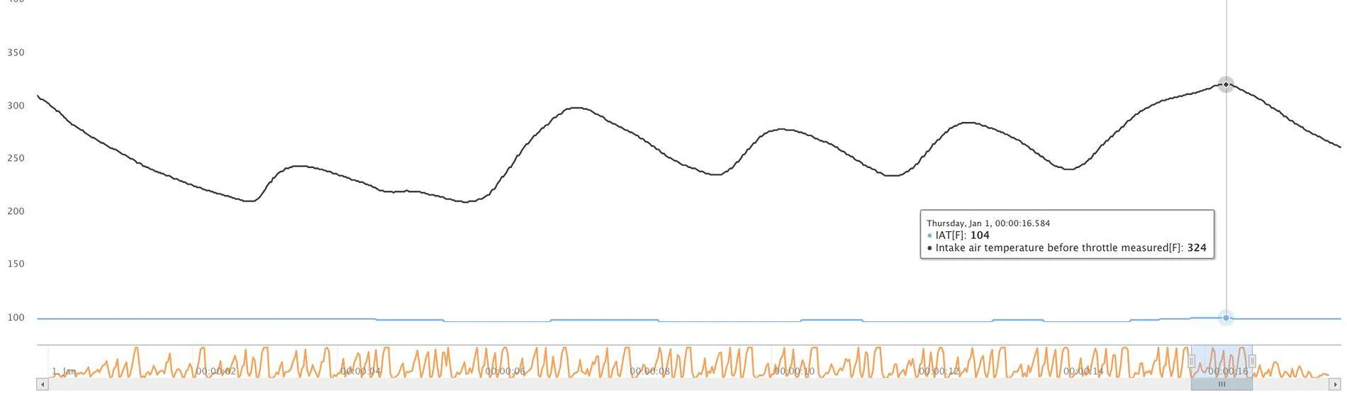

Can it still shed heat effectively lap after lap?
In this example, on lap 17, the manifold is still able to shed 220F worth of heat from the system.

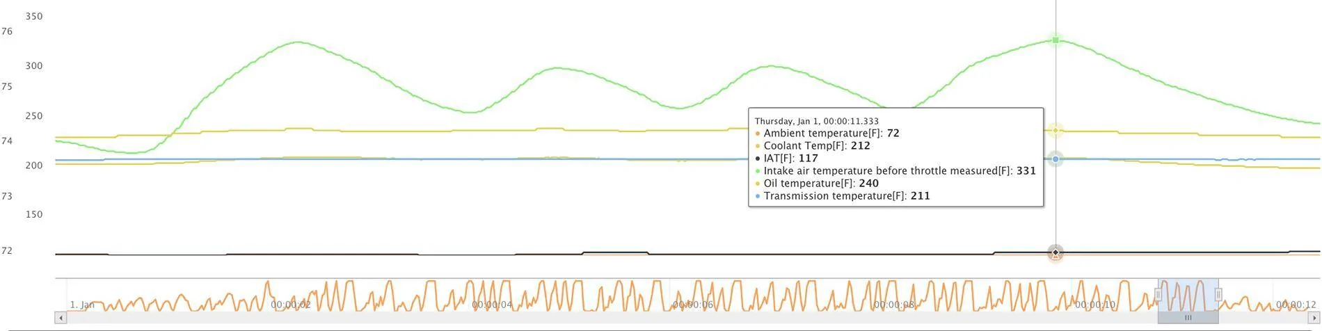

75*F Ambient. 12 laps in. 214*F heat shedding

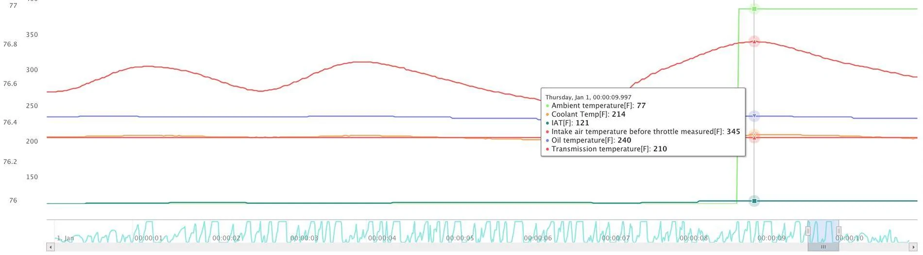

77*F Ambient. 11 laps in. 224*F heat shedding

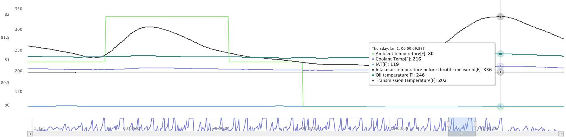

80*F Ambient. 11 laps in. 217*F heat shedding
