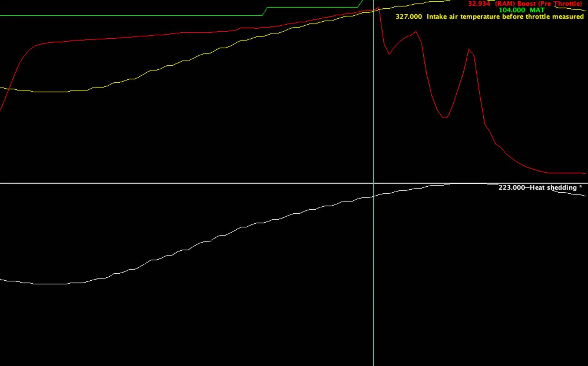

I can do a 40-140 pull with my wagner and iat doesn't move.
It works. Well.
MegaLogViewer makes it easy to setup a custom math channel that visualizes what you are talking about. I use it a bunch.
Here is an example that is Charge temp - IAT, which basically shows how much heat the Mani-cooler is shedding. It's shedding 223F in this instance:
