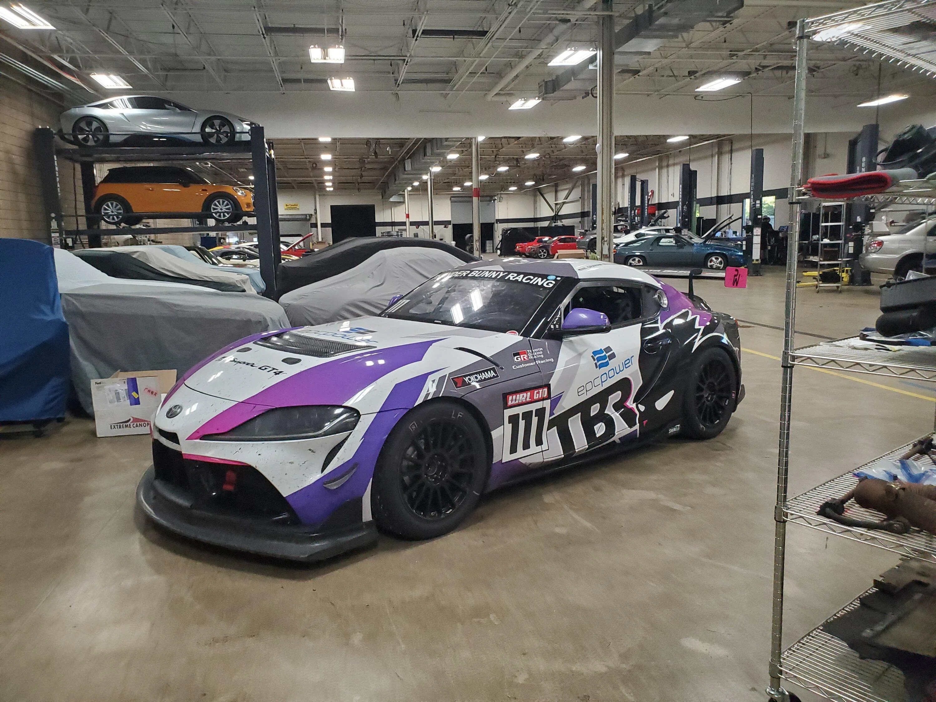

I will be back there for sure, but modding the car over the years is part of the fun! If you do it all up front you won't appreciate the upgrades as much. TBR threw my downpipe in too while it was in their shop. They mentioned that they recently got a Dyno, so I may be back for that once I get my JB4 tuned in.
That aside, definitely visit in like a year. They are in the process of a major renovation, but its going to be the coolest car club/simracing/showroom/raceshop/event venue in the Carolinas for sure.
And of course 2-3 Supra GT4s to drool over:
Love it! I’ve done the full blown race car thang. Got it out of my system. But would love to have access to their shop for coding and other ? Greenville SC is looking better and better for a 2nd home! Plus your’e close enough to drive to RA and VIR ?
