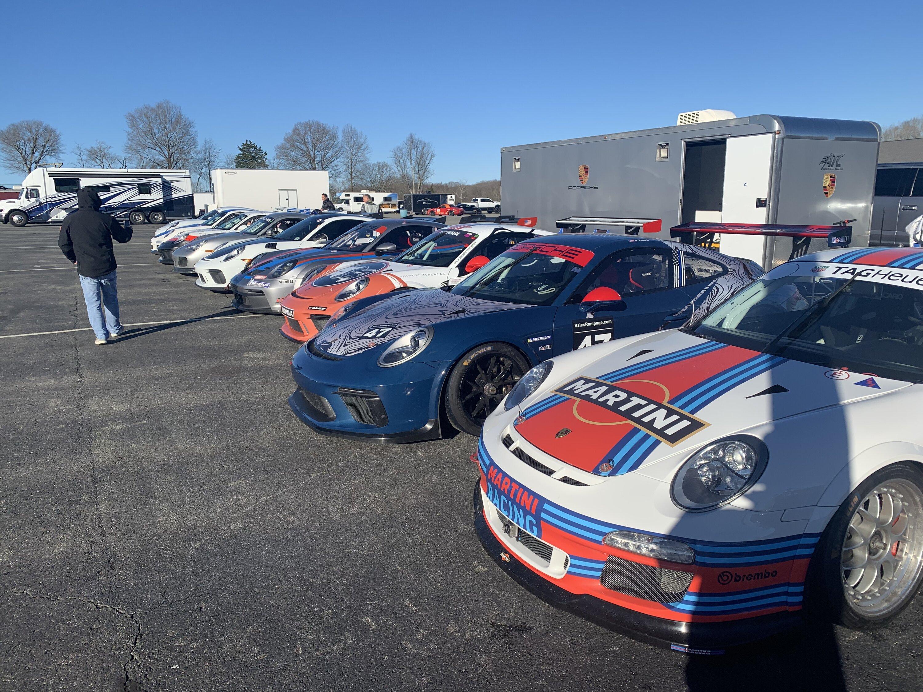

no…. I can’t afford the consumables on a gt3 CUP car!
this whole group of cup cars is fromFL. Next to me in paddock. They basically go to every chin event at every track.
