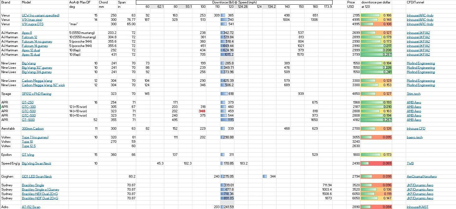

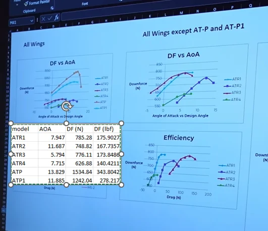

Updated spreadsheet with INGS (no data), and G-stream (questionably optimistic data). Notably G-stream was used on the Ford 302S factory racecar, but most of the links on forums (including a wind tunnel youtube video) are dead so there's no way to cross-validate this.

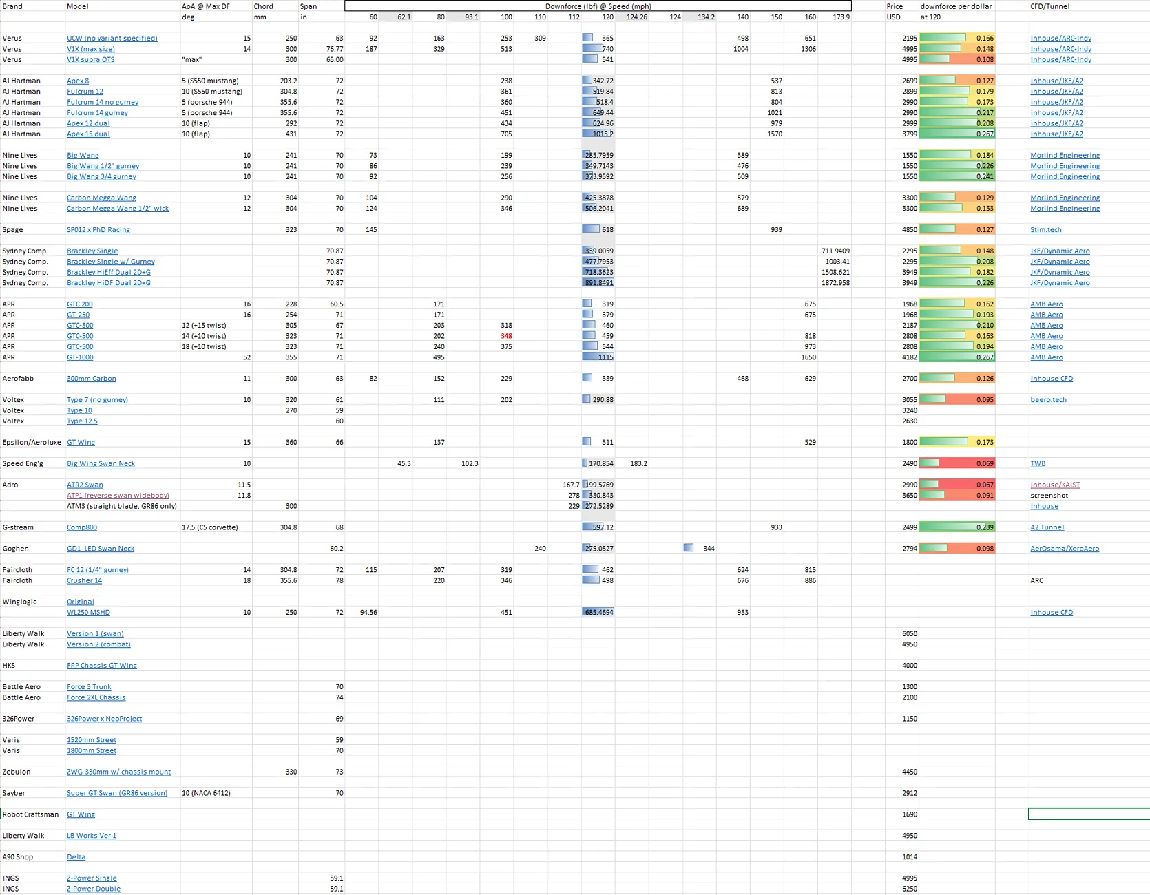

Updated with numbers for Adro widebody ATP1 (330 lbf @ 120mph) and racing division ATM3 (272 lbf @ 120mph, will update with supra-specific span when released)
