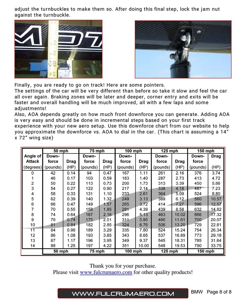

Updated with LED wing by Goghen Designs and included data sources and Lift Coeff Table. Remember, anything above 2.4 on a single element is likely bullshit if it doesn't have a gurney flap. Anything below 1.7 is seeing a ton of dirty air if on a car, or just plain sad if it's freestream.
AJ Hartman also says the full kit on the supra produced better downforce and less drag than his own personal mustang gt350, though he hasn't published numbers. He says the delta could be misrepresented due to compounding factors* - the order in which you add/remove part will change the apparent effect of a given part. Which is fair, if your audience is non-technical. My homies that work engine dyno cells can attest to the same effect when you're doing an engine stripdown test. But either way, it sounds like the ballparks can be trusted.
