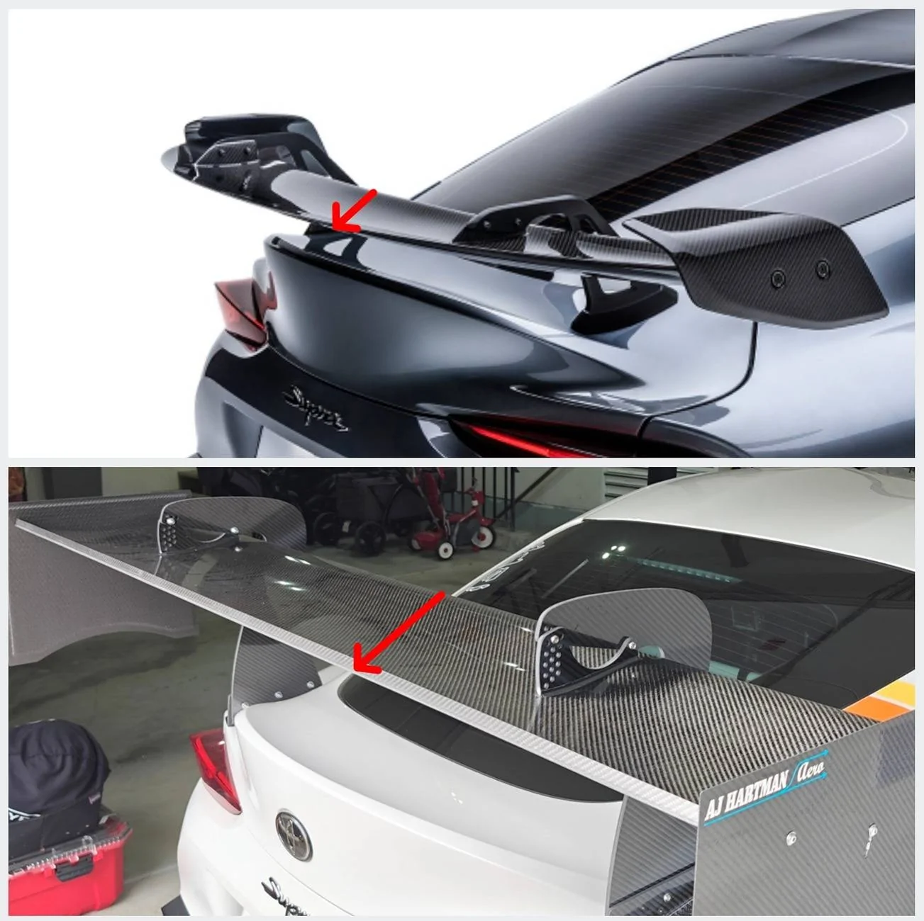

I'm I am rly interested Revozport wing,
What does the CL work out to be on the revozport wing when you back-calculate it?
As long as it's above 2.2-ish (and not into the 2.6+ bullshit territory) that's roughly what all the good profiles can hit. so it's just a matter of the manufacturer scaling up the airfoil area and supporting it properly.
Curious if this mounting position will produce relevant downforce unlike their original wing.
Highly doubt it would change things more than, say, 5%. The problem was never the mount or the airfoil shape that the adro folks picked, ALL single element wings (that dont suck) fall into a CL range between 2.0 and 2.4. You can get a small boost with a gurney flap, but so can your competitors, so that's awash.
Ultimately, the adro wing performs so poorly because they sized the damn thing so small. Wing area (chord*span) matters and you can see its approximately half of what the AJH wing is. You can't change the lift equation.
