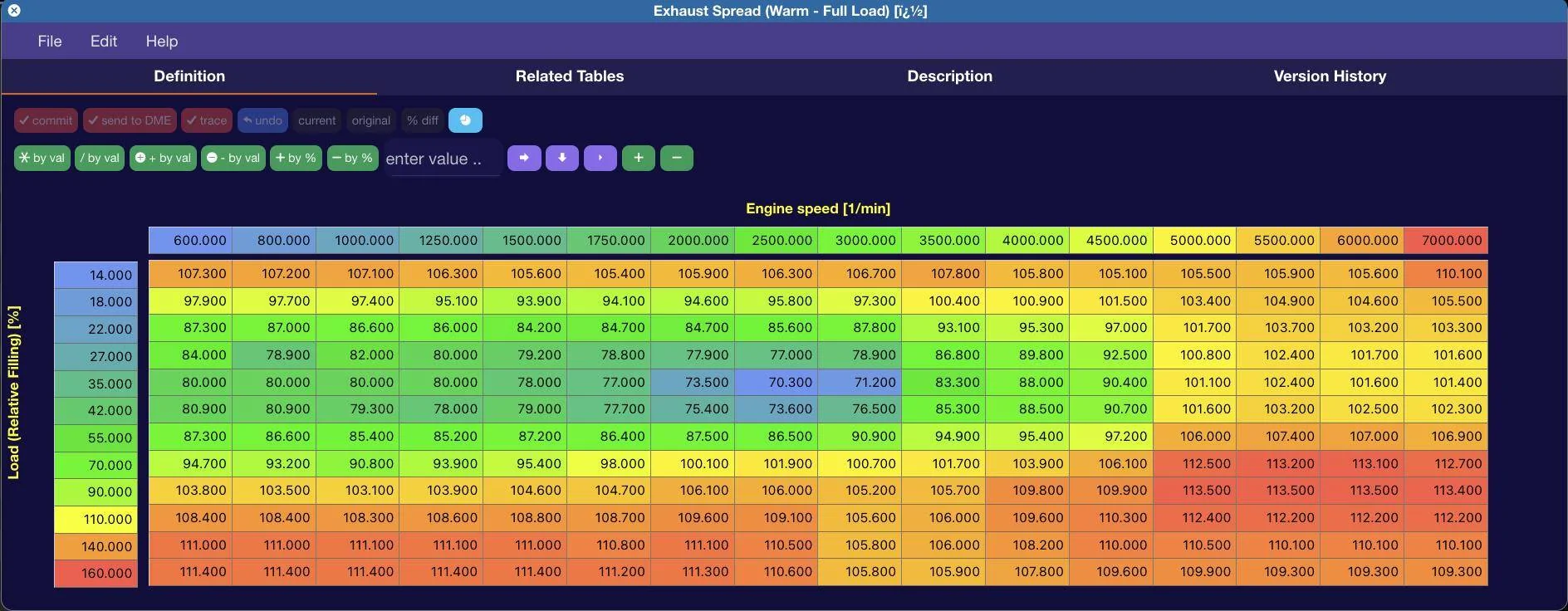

I think I know what might be happening here. I found an issue awhile back with the Max Boost Reading table. If you don't raise it, boost can spiral out of control and shoots for the moon. I noticed that it was easily provoked when I went to a track at higher elevation (Pocono) as well. That is where it really showed itself.
However, my boost target wouldn't change. This may or may not be the same issue you are having.
The fix was scaling this table from 3300 to 4000

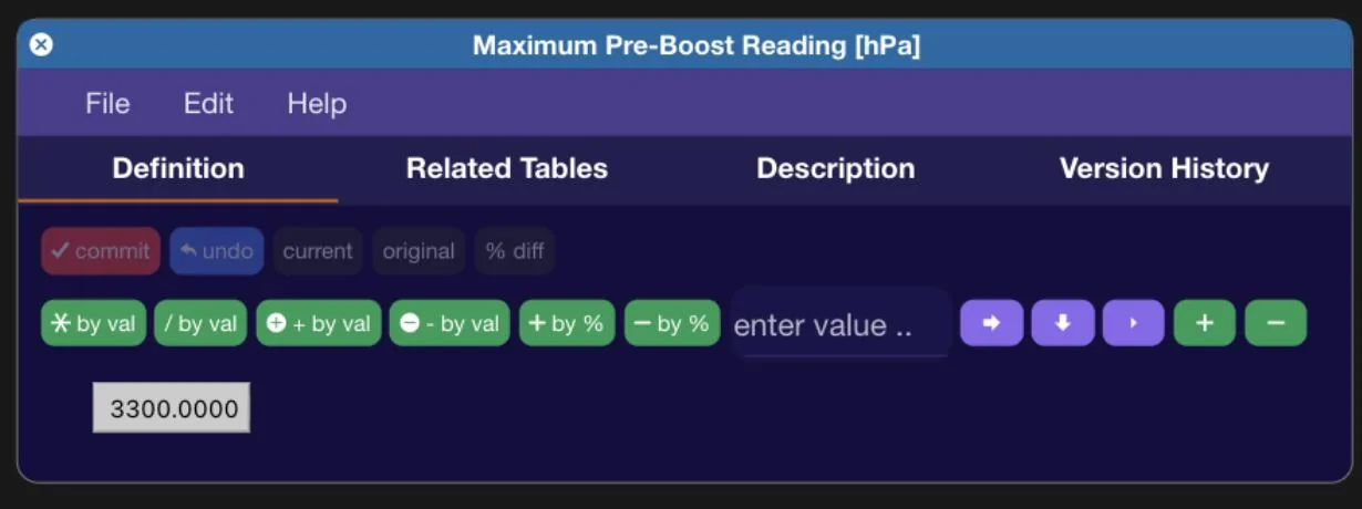

I passed that info along and the response was, "he's talking about PVDMX and that is set to 3500/35PSI so that should not be the issue".
Tuner is still under the impression that the boost spiking in 5th is related to "cam walk" which causes the VANOS Exhaust to come off target. We're bumping up the oil pressure a little more to see if that solves this- assuming that the VANOS actuator and bolt are okay. I'll be adding the Verus oil cooler this weekend and I'm curious how this further impacts this.

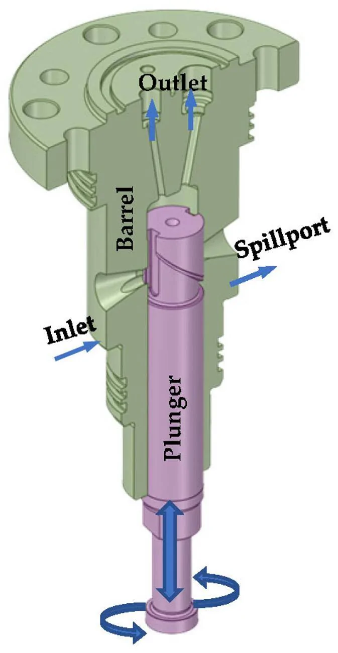

I'm still a little confused on the influence of HPFP, fuel rail and oil pressure (and now apparently boost pressure) and how it affects the Exhaust VANOS... and even more confused about what the Exhaust Vanos value in the log is measuring.
The high pressure fuel pump is on the exhaust cam. During every pumping event, error will build depending on the injected volume (scales with rail pressure, pump plunger diameter, pump lift, injection duration). Unlike stiffer valve springs, the energy to drive the fuel pump is not returned to the cam when the plunger returns to base radius.
vanos is a cam phaser system. it uses oil pressure to either make chamber A bigger or chamber B bigger. that's all it is. Think of it this way: suppose the entire assembly (green and yellow) is spinning clockwise. When the high pressure fuel pump is lifting, it's puts a CCW torque on the yellow body. This squeezes some fluid out of chamber B due to leakage paths. The oil pump has to refill chamber B before the next pumping event. If not, B is too small and now you have retard/delay error. the exhaust cams, which are also on the yellow body, now open the valves way too late.
Increasing oil pump pressure allows you to attempt to refill chamber B faster. However, this only treats the symptom, the error is still accumulating with each lift event.
Other methods to treat this include running a lower rail pressure with larger injectors so that you can achieve the same injected volume but with less torque load coming from the pump. Or, God forbid, an aftermarket company doing some actual engineering work to change the internal phaser geometry.

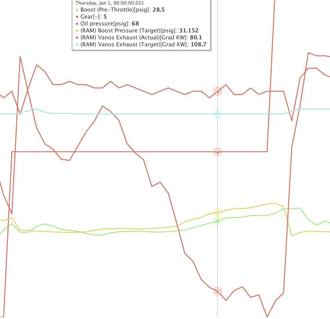

Yea I called out the exhaust cam deviation in the log before.
HPFP is driven off the cam, which can be affected by a stiffer/upgraded HPFP. Oil pressure controls the VANOS adjustment.
The measurement is angle.

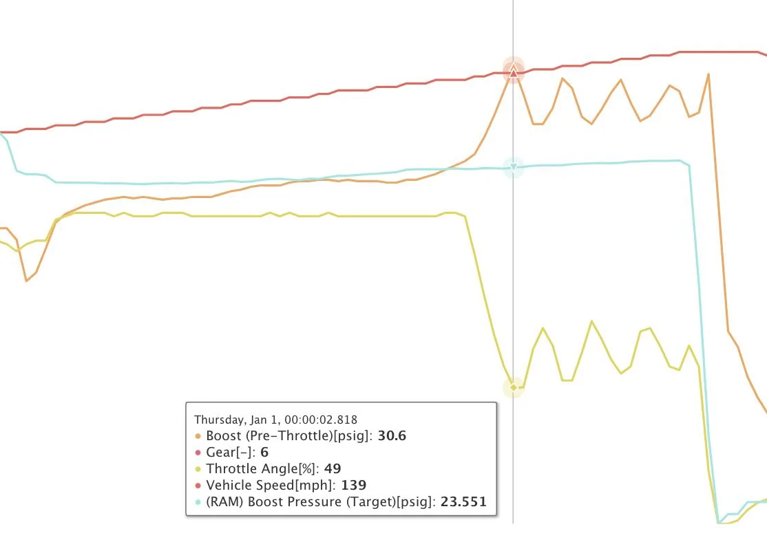

The only counter I have to that is that your boost target is ALSO changing. If it was just boost going over target, I would say his hypothesis could be correct.
Also, the logged oil pressure is also not changing when the exhaust cam deviates from target.

@razorlab agree with you on the oil pressure not deviating so the proposed solution seems a little sus. I compared oil pressure on all logs and oil pressure doesn’t fall off . I don’t know why boost target would change if BM3 doesn’t do boost by gear; however, he says it apparently can happen when the exhaust target is off and sees it often when it does.
What would make since in this case- exhaust vanos is falling off which is influencing the boost, or boost is shooting up and influencing the vanos to fall off?
