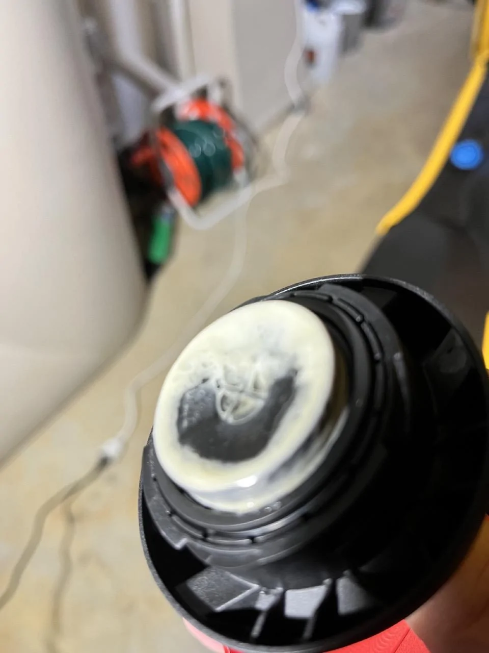

I drove mine home from being PPF'd and there was a lot of white smoke.. but as it was a cold night I didn't think much of it. Also it was only about a 15km drive so I figured the engine probably didn't get a chance to warm up.
I popped the oil cap today (hadn't driven it since) and well, it didn't look great.
Hopefully it's just a build up of condensation from sitting around for weeks on a boat. ?

likely condensation. What does it smell like

Probably condensation. I have about half that amount when my Supra sits for 3-4 months during winter. You'll see that same type of thing in catch cans.
Thanks gentlemen. @zrk Didn't smell like anything. Wiped it off and waiting for weather to clear up so I can go for a spin.
