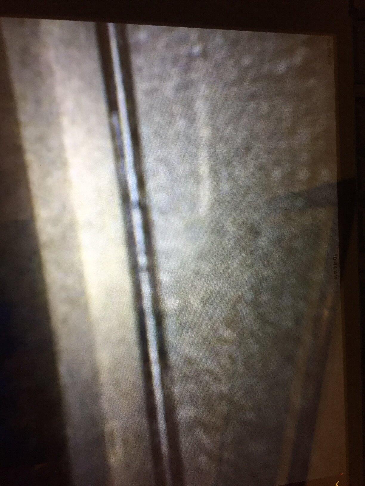

This is what coolant leaking into the combustion chamber looks like exhaust wise on cold start. Coolant leaks into the chamber during the cool down cycle and is burnt on start up. Anyway it shows the colour of the exhaust discharge and the concentration when it's chronic. You can also hear it misfiring for a while as well. The image is a borescope image of the same engine type Focus RS 2.3Litre turbo and you can see the beginning of the leakage at the bore bridge location. You can see the cylinder head and cylinder wall and the head gasket clamped between them both. Not chronic at this point but "on the way". Second image from my engine and nil leaks evident.

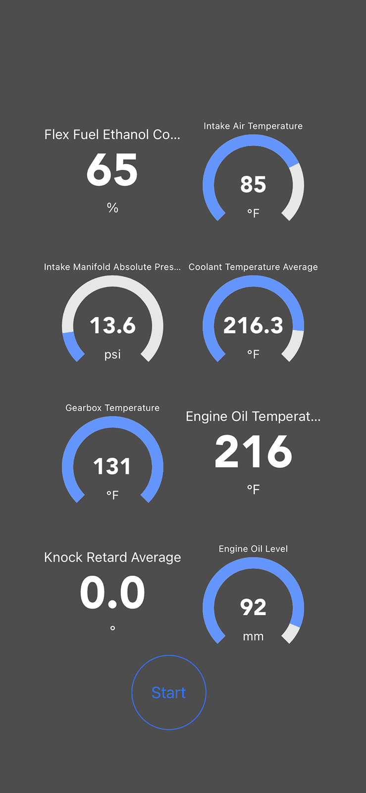

An OBD dongle will give you the exact measurement of your oil, and help you understand your situation a little better.
This is ECUTek but I know the parameter is available on BM3 and a few other platforms.
At the least, this should help you understand your oil level before going to a dealership.

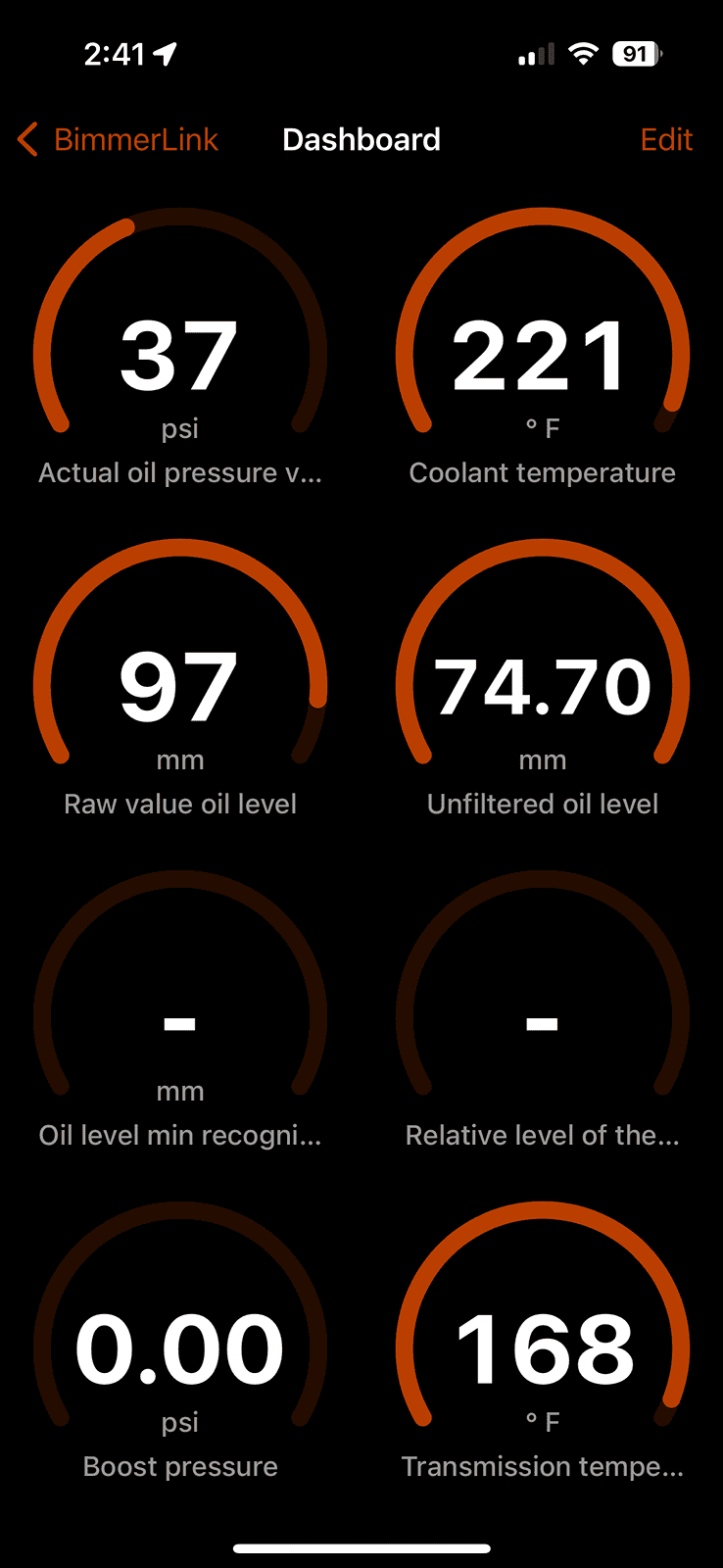

Bimmerlink will show this as well and for reference:
- 100% (6.6 liters) = 97mm
- 100% (iDrive max) = 97-85mm
- 75% = 84mm
- 50% = 82mm
- 25% = 81mm
- 0% (iDrive min) = 78mm
