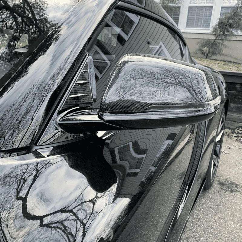

I just posted a thread on my fix. Installed the Verus Engineering carbon fiber wind deflectors.
Here is a link to the thread: https://www.supramkv.com/threads/fixing-the-wind-buffeting-issue-on-the-a90.5118/
Link to video:
I absolutely love this product. It completely cures the wind buffeting issue for me.
Cheers,
-V
I initially got the Amazon Hypersonic door guards as a fix, but I couldn't drive over 55 without a lot of buffeting (crosswind made it terrible; maybe I didn't put them on right?), but wanted to cruise through the country with my windows down so ended up splurging on the Verus Engineering deflectors. They work significantly better with no buffeting up to about 75mph which works for when I'm cruisin, but now with the windows up I get strong wind noise at both windows...I kind of just deal with it, but does anyone else notice increased wind noise with windows up with Verus wind deflectors?
