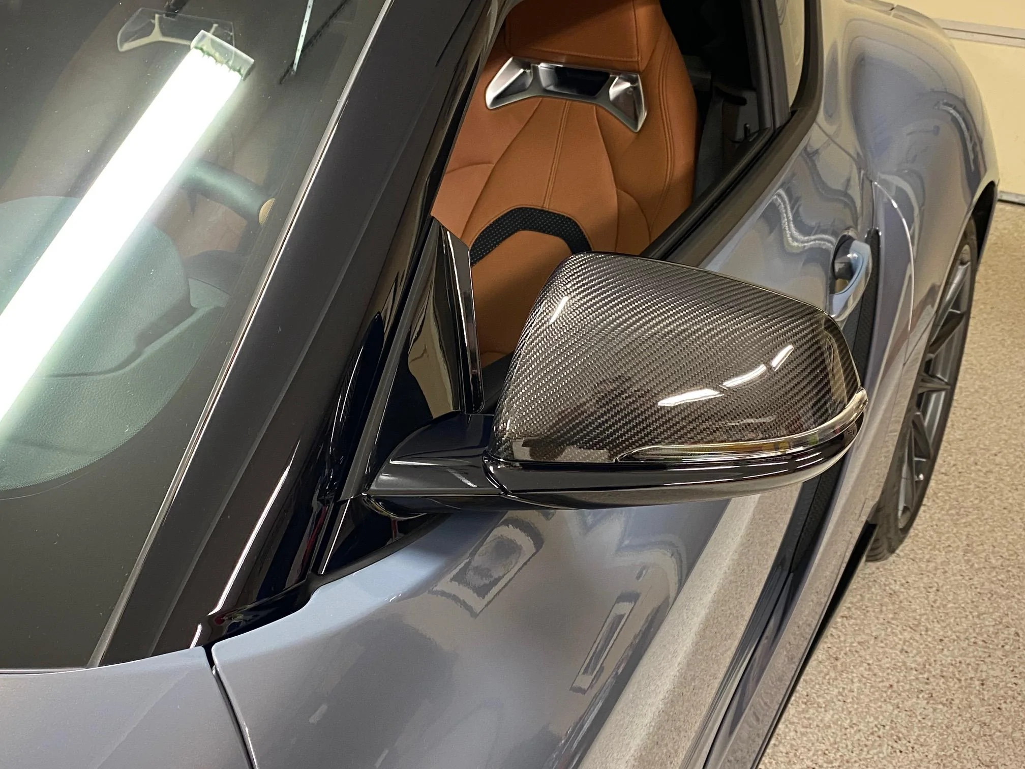

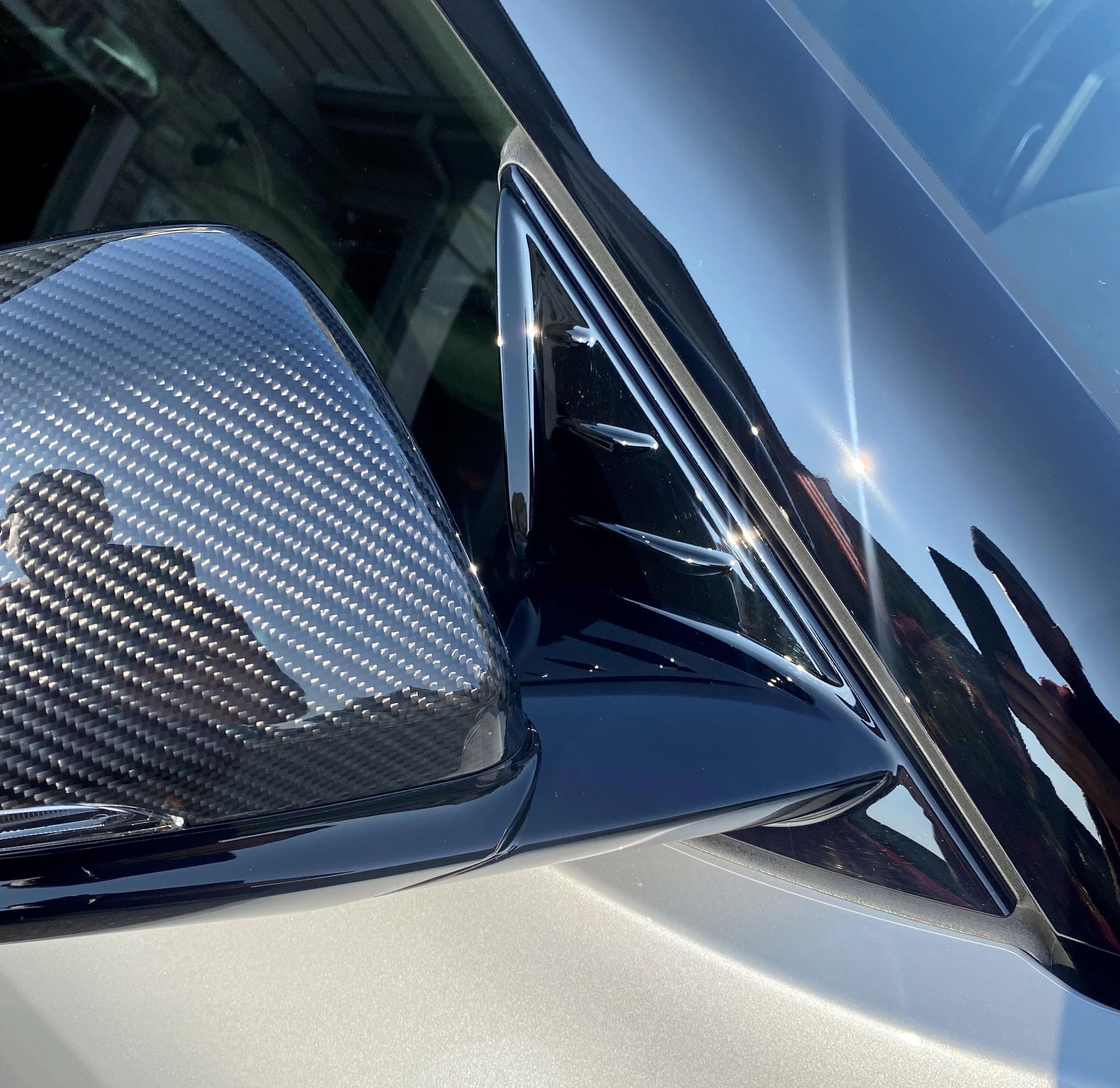

I really only heard the wind around 50mph on my A91-CF. My A90 was brutal at many speeds like everyone has experienced. I have the mirror triangles with the 3 small fins on both of my cars and they work well and don’t look bad either.

I had it in my 23 but I was much less dramatic than everyone had made it out to be. I just slapped on the AMS gloss black and noticed a large improvement.

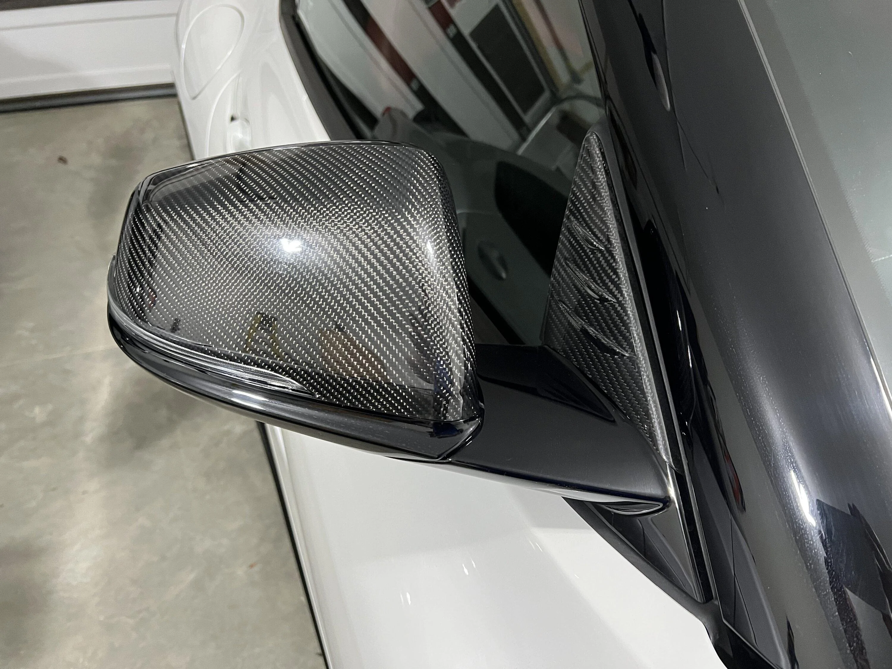

~ I started with this route (photo below) but was less than impressed… still buffeting at certain speeds.

I'm going to add some of those little vortex generator shark fins to the A pillar, should fix it.
You have nothing breaking up the airflow from that flat pillar, so anything to disrupt it should do the trick.
