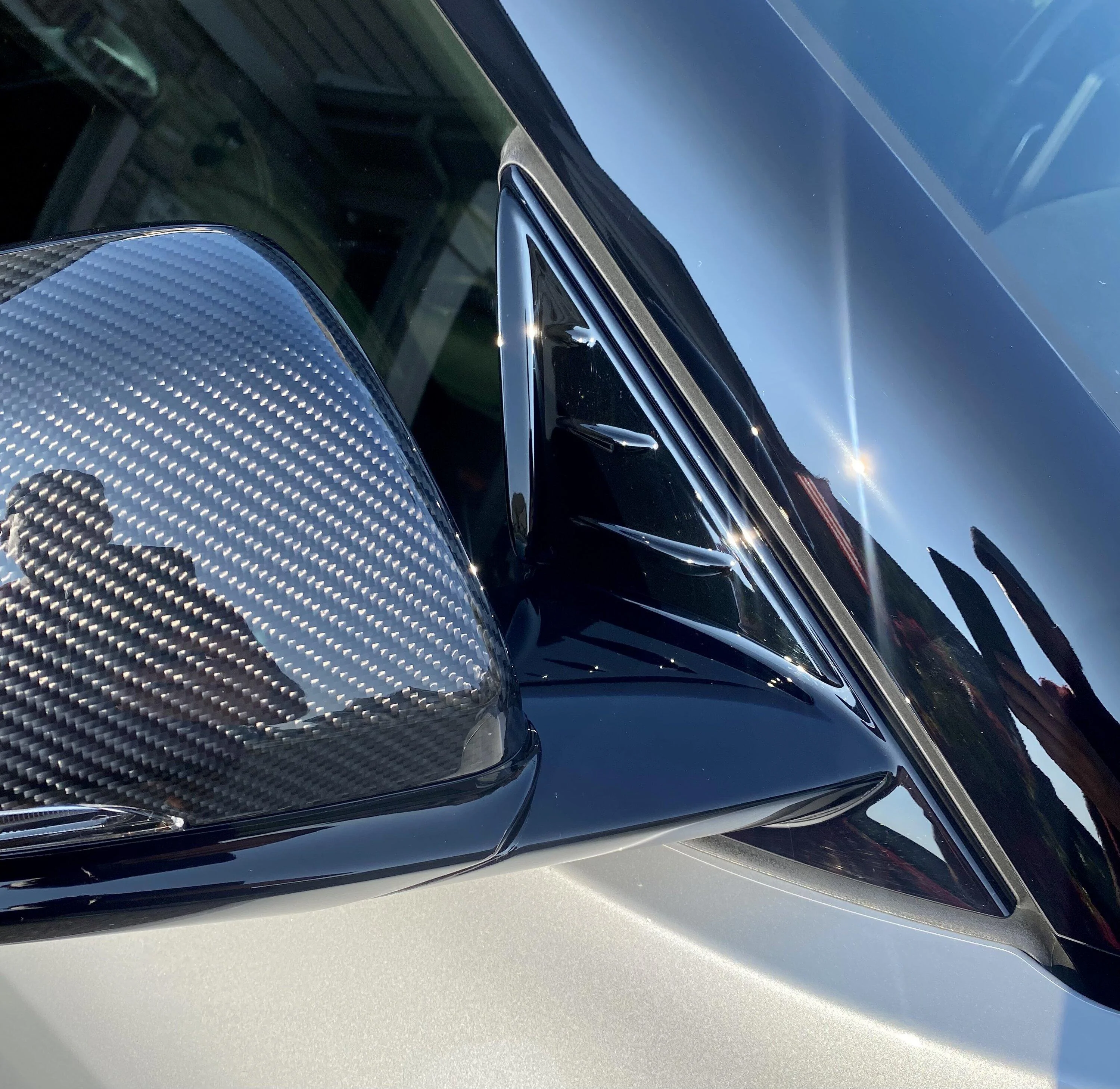

I have a 2023 premium and there is very little buffeting at almost any speed. At least no more than my CRV daily. I had already bought the little cheap triangles to put on but don’t think I need them. I don’t have the carbon caps on the mirrors so maybe something different there.
@Supraluv @MrNobody Post a picture so we can compare to earlier models.

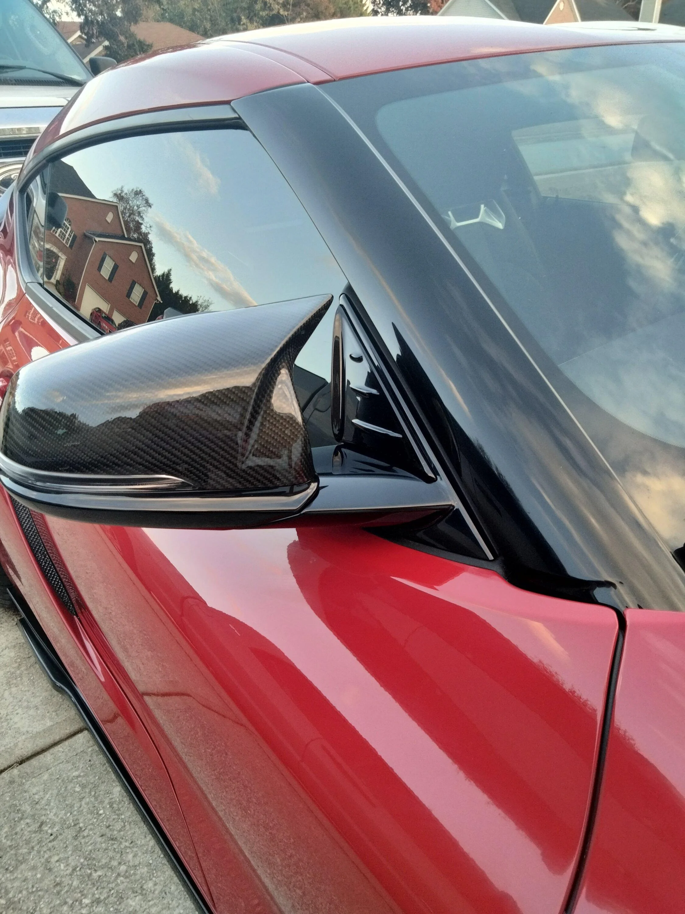

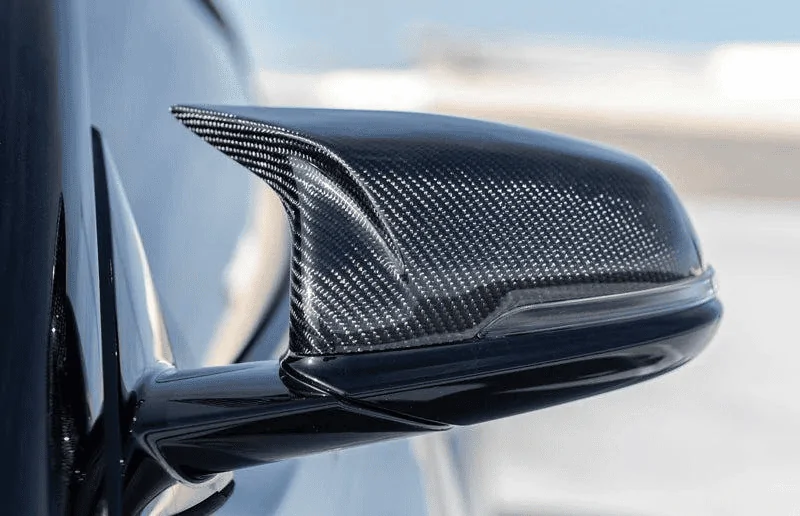

I installed M-style mirror caps (sharp edged, not blunt) on mine which fixed the buffeting.
Mine are factory installed oem carbon fiber blunt style. Same style caps as the photo that mushx posted.

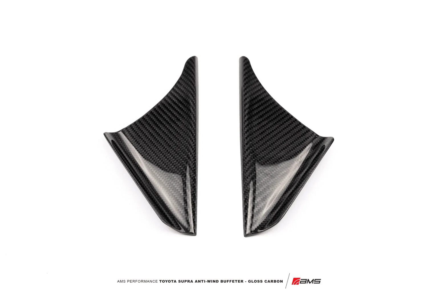

My head feels like it's going to explode above 40 mph in my '23. I installed anti-wind buffeting add-ons the 2nd day I had the car and it almost eliminated it.

Here is a coupe of pictures of my caps.

I installed the above pictured CF M style aftermarket mirror caps a week ago and they reduce the wind buffetting. I previously installed the AMS CF windbuffetting kit above, before that. Both are easy installs. I found the AMS pieces reduce but do not eliminate the Wind buffetting by themselves, especially at speeds over 65mph. They are costly but I wanted to retain the CF for my CF edition.
