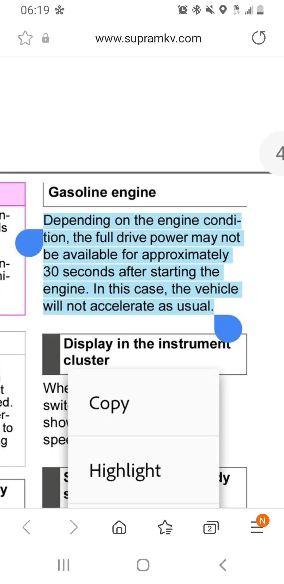

Old models, old tech. It's a "BMW thing" because the manual says it's normal. Just because your 10 year old BMW doesn't do it, doesn't mean new ones won't. It's just an engine protection that won't allow you to freely rev it unless conditions are right.

That's why I'd like specifics. Engine, chassis code, anything more than "its a bmw thing". This seems problematic with the MKV that everyone has had in every real world condition while driving come up that's posted in this thread or the other, hot, cold, rain, snow, dry, best warm temps for the perfect drive, cold start, warm engine, stand still, while driving, stopped car for a second, started car from sitting all night, so "just because it's not the right condition" Well, what condition is the "right" one? That answer would solve both threads on the matter. From those owning "newer" BMWs, by saying "its a BMW thing" kind of clumps ALL BMWs. If we had say, if this happens in 3 series from 2017-2021 that'd be a bit more to go on, than "it's a BMW thing" The F30 328 that my nephew has is a 2013 so under the 10 year mark with 30kish for miles. So under a decade of a car with not the same issue.
Don't get me wrong I still want a MKV one day so I'm not bashing the car by any means, but with this on going issue it's lead me to believe that there's a gremlin somewhere. Maybe someone living in either Germany or Japan could shed the light on "perfect" conditions for there to not be this issue.
Edit: I know you'll know better than me where to look, here's the 2021 z4 manual, where should I look in regard to this circumstance in the two thread's we're talking about? I wasn't able to find it skimming 332 pages that it is: https://www.bmwusa.com/owners-manuals.html I just took a vin from car gurus and pasted it to look it up, if it doesn't come up for you.
Here

I was hoping you'd be able to find that statement in the 2021 bmw z4 owners manual and tell me what page rather than what you posted previously from the supra manual you found. In the entire "driving" section starting on page 118 of the 2021 z4 manual, nor is it in the safety, or things to remember section, nor refueling or fuel section detailing approved fuels to use. I don't see what you've posted mentioned in the 2021 Z4 manual. That way maybe we could say instead of "it's a BMW thing" I'd be more happy to oblige it's a "NEW BMW thing". And this makes sense ONLY if it was consistently within a 30sec or so window from start up. People are having issues after they've been driving, pull up to a stop light, then try and go and nothing much past the 30secish window.
Nobody has had that randomly during driving. Only right after startup. It can happen hot or cold engine. But it goes away shortly after putting the car in gear.
It's in the Supra manual, because that's what we drive. But I've read about it on BMW forums too, so it's definitely a "BMW thing"
