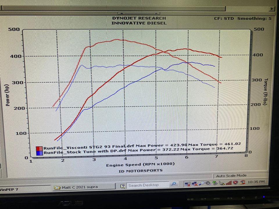

Here's a typical stage 2 Supra (red curve):
https://www.supramkv.com/attachments/116018576_10223923560464001_9077036699959649122_o-jpg.28602/
The goal is to maximize power, which means keeping the car around that hump at 6000 RPM. We have a very tight ratio transmission, which means it only drops maybe 1000 RPM when shifting. This means in order to keep it centered on that hump, you'd want to shift at about 6500 so it falls down to 5500 in the next gear. If you shift at 7000 and drop to 6000, you'll be spending all of your time above the meat of the powerband.

That's -really- high. Stock turbo is dead at ~5700.
Depends on mods and the tune. For people running E50/meth you're right, the stock turbo just can't keep up with those boost levels up top and the peak is at more like 53-5500 RPM, so you probably want to be shifting before 6k. For basic stage 1-2 on 93 octane it can hold out higher though. The best idea would be to dyno your car to see what the powerband looks like and set the shift points appropriately.

Theory vs practice. Analyzing compressor maps is great when planning out a build, but there are way too many unknowns and estimates for it to match reality 100%. You never know the true answer until you strap the end result to a dyno and measure it.
Sure- but the math is generally right (manufacturing variances aside). Nearly any dyno curve is going to show the stock turbo dead in the water at ~1.7bar and also dead around 5700+ RPMSs.
The one you posted above follows this nearly to a T.
Peaking at 5700 is not the same thing as dead at 5700. You don't shift at the peak, you shift after the peak in order to maximize the power under the curve.
