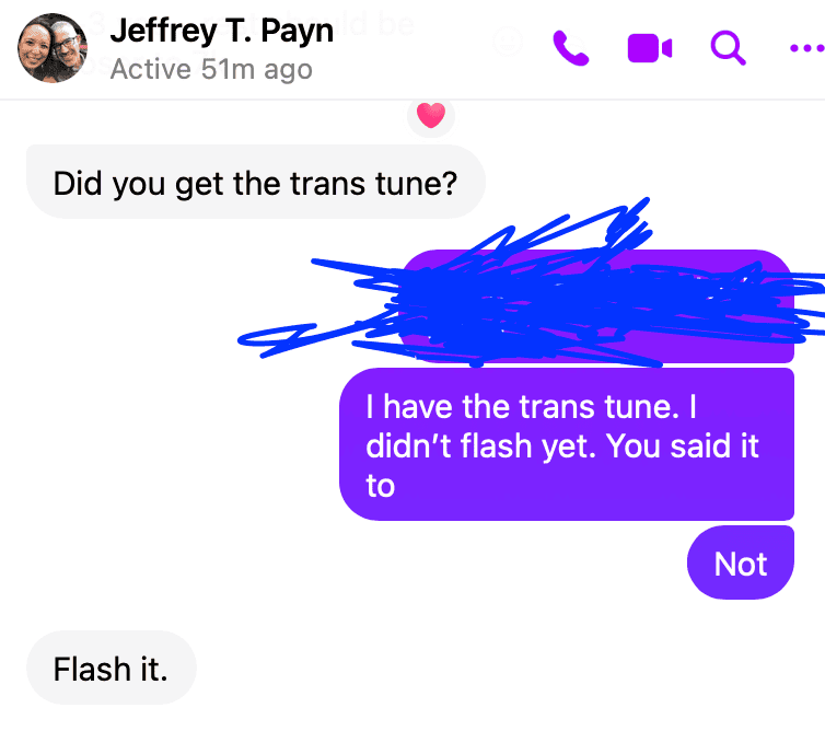

If Payn says its time to get busy then its time to get busy. ?
Awaiting your feedback.
-RJM
Flashed it. My arms are too stiff from the insane sunburns I got at the track yesterday to even attempt to go outside until the sun goes down. I'll report back tonight.
