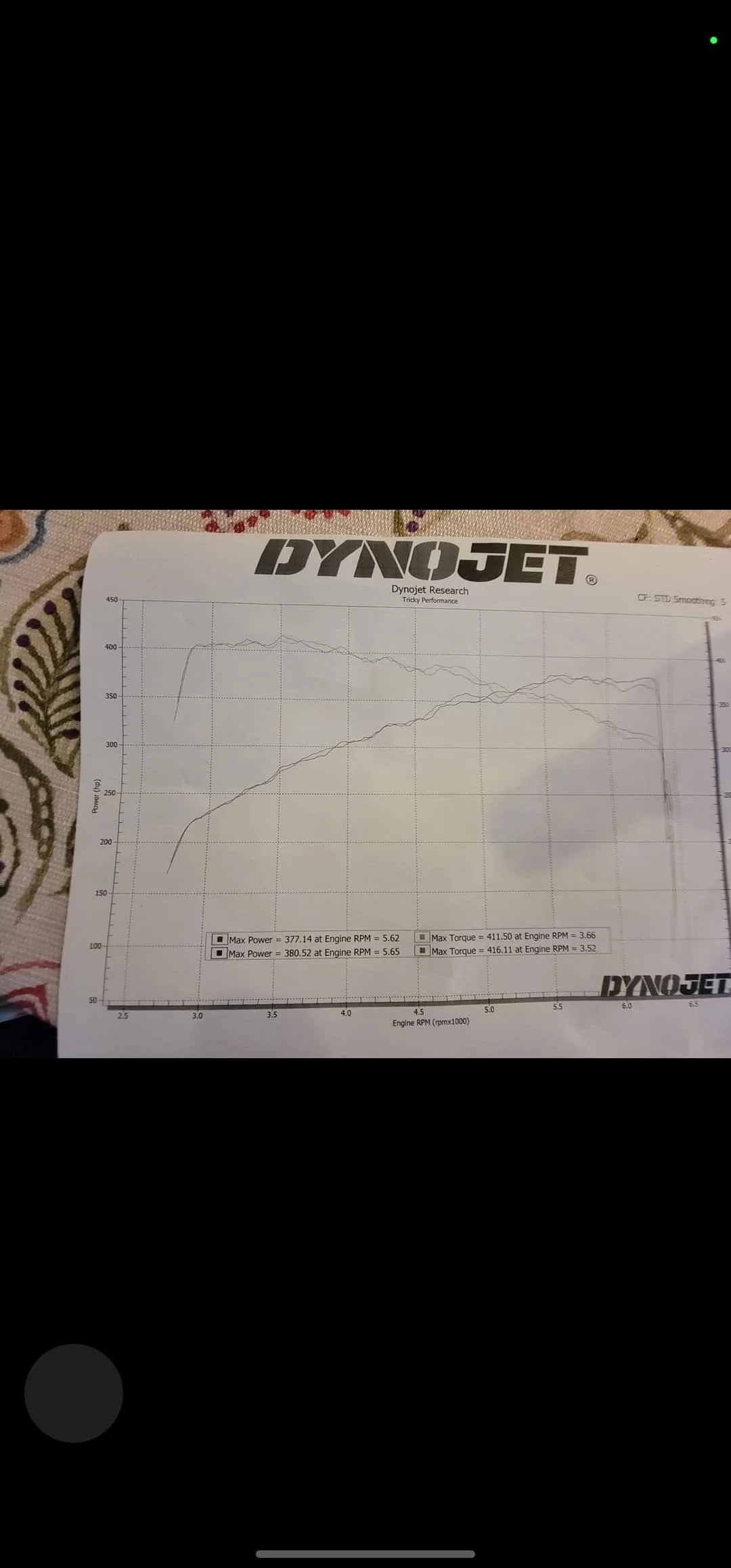

That's -really- high. Stock turbo is dead at ~5700.
Looking at my stock dyno, power fell flat at 6400rpms.
Now I'm on 93/e30, intake and downpipe. Haven't dynoed yet to see the power curve

If I read this right or I assume so. The power dies off at 6400rpms and thats where it needs to shift right?

The curve falls off a cliff like that because the tester let off the gas at 6400 and so everything dropped to 0. But it was pretty flat up there anyway, so that's probably a fine time to shift.

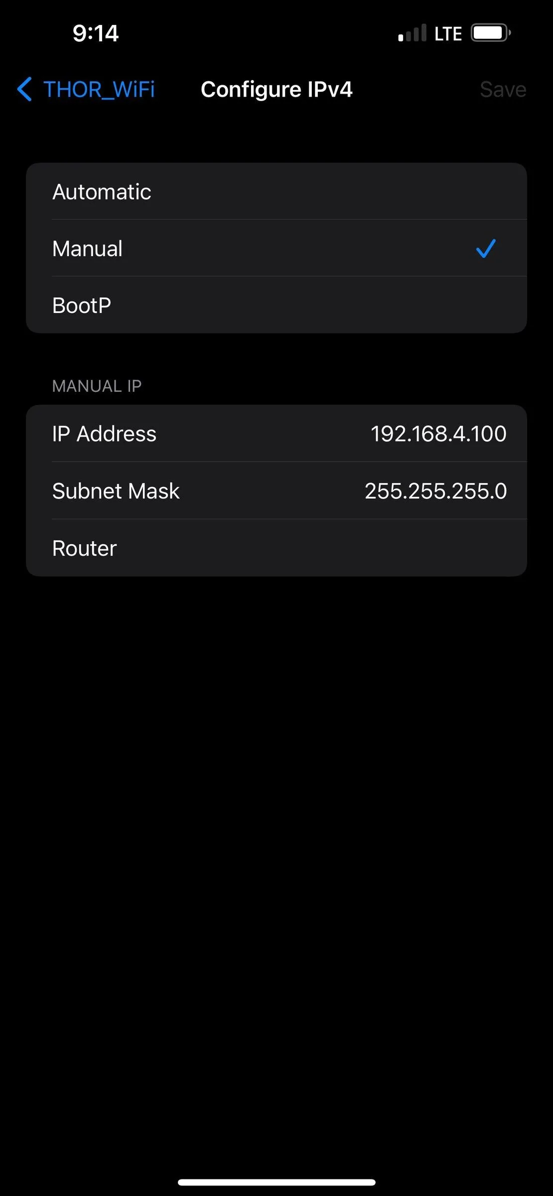

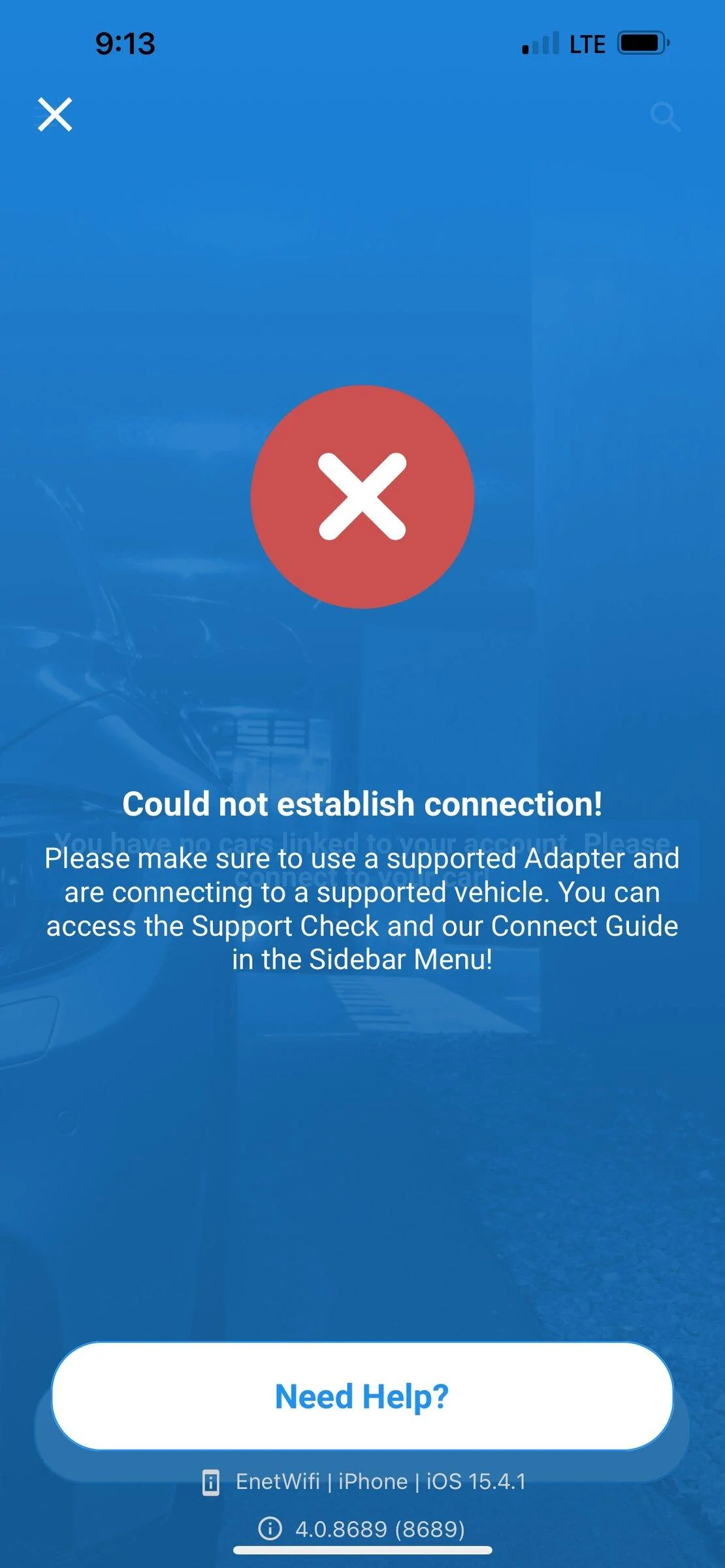

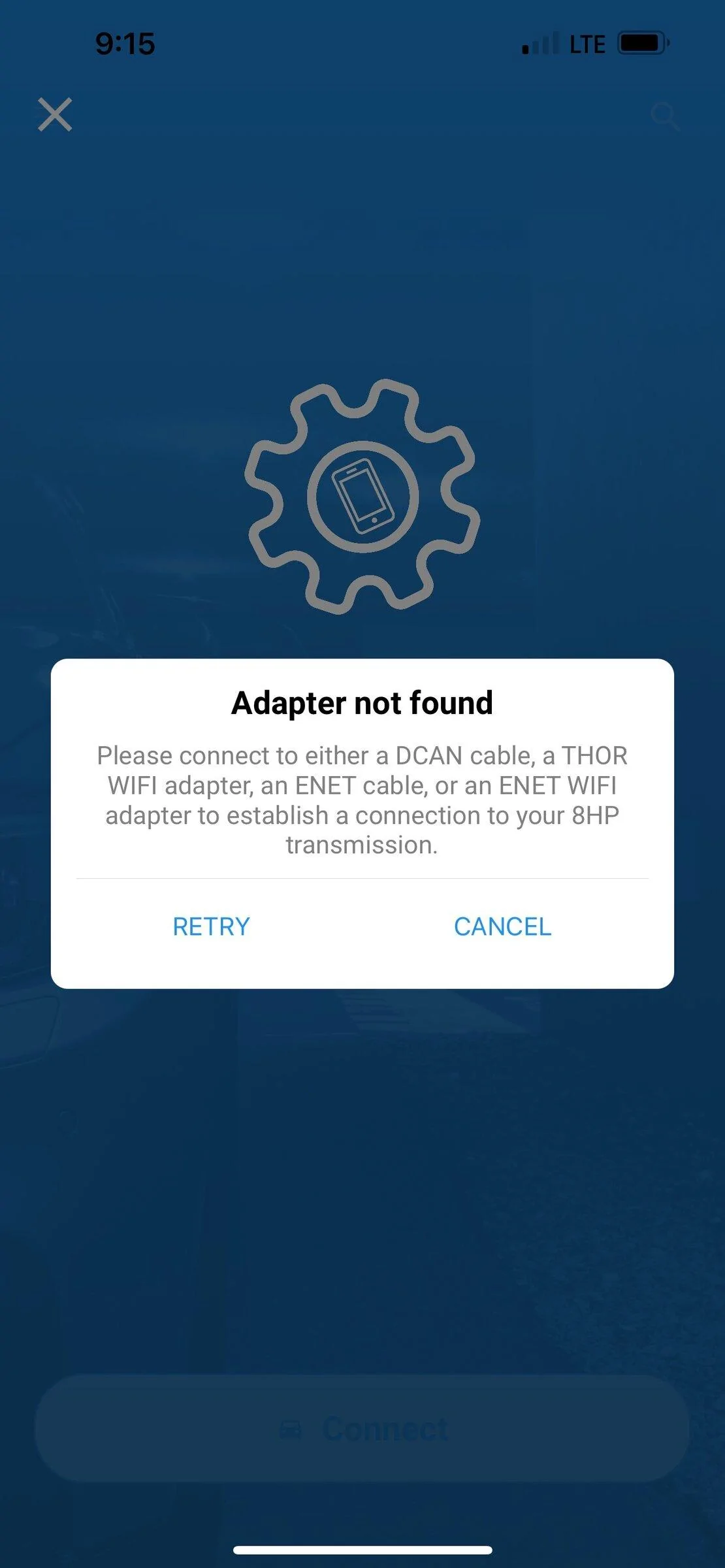

Those that used the Thor dongle, did you have issues with it connecting on iOS. It will find the WiFi network but will not detect it in the xhp software.

I used the Thor dongle and a problem that I kept running into is that the wifi would auto reconnect back to my car. After I turned the auto reconnect off it stayed connected to the Thor dongle.

Well after getting irritated with the phone, went out and attempted with the IPad and it hooked right up with no issue. Less then 10 minutes start to finish including adjusting throttle blip, and rpm limits.
