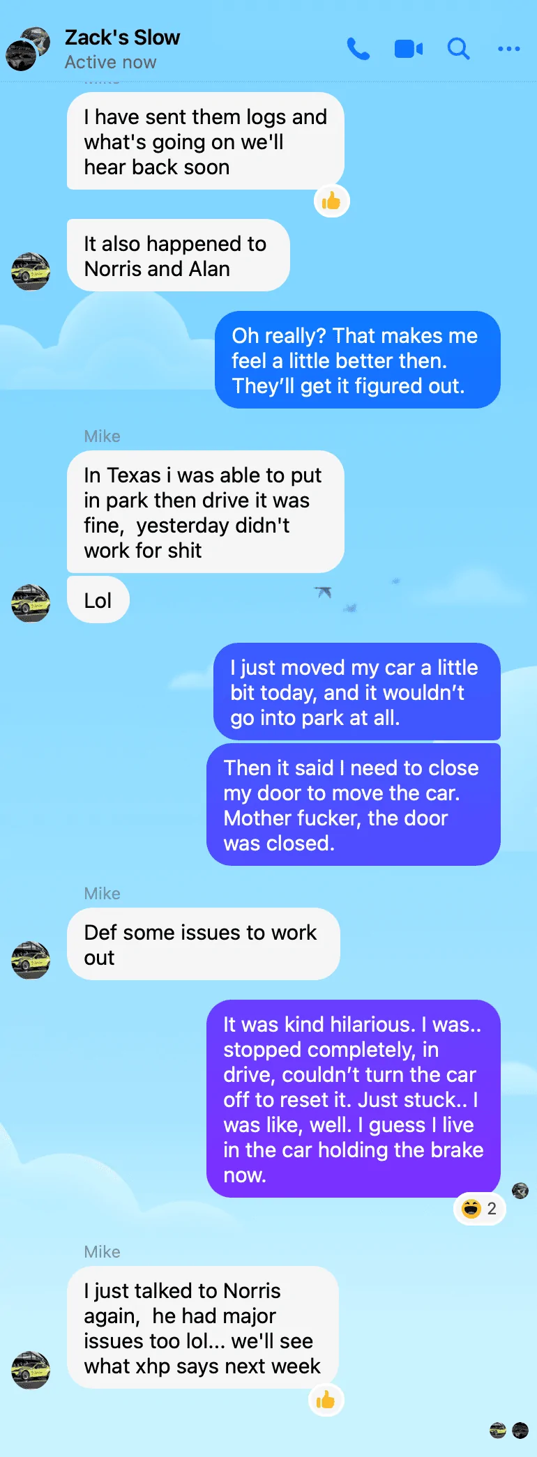

Unsure. A lot of us track guys are having some serious trouble this XHP.
8,472
14,122
We're seeing weird behavior at high rpm shifts, including hitting the limiter, getting stuck in first after the burnout, even when 'always start in 2nd' is selected, and other trouble. We've all sent logs over to XHP, so hopefully we'll get some more data soon and a bugfix.
Interesting. That all sounds bad. I'm not pushing the car at the moment - haven't had it on any kind of track with the transmission flashed - but it sounds like there are some bugs to work out. I haven't experienced any. This isn't their first rodeo so I'm sure they'll get it fixed. Still surprises me a company rushed a product to market then spent the subsequent months rolling out fixes to ensure it functions as it should have on day one. ?
