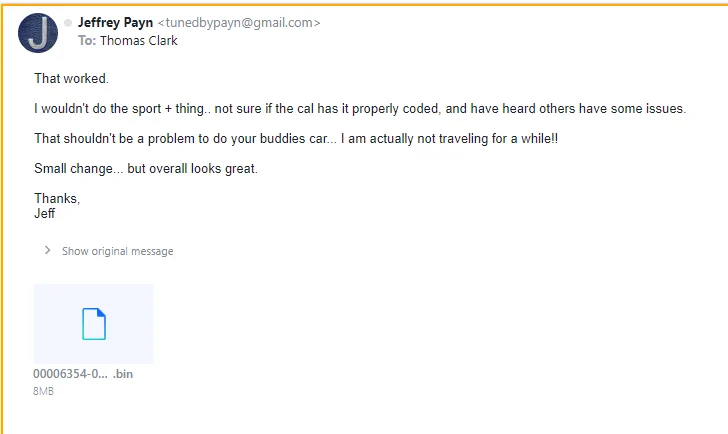

ive used both with it, but i dont really use Sport+, I sent a log to Payn he saw that and asked me if i was on sport+ and told me not to use it. So i havent really used it at all since. but on V1.0 sport+ freaking rips with everything off lol.

When payn was tuning my car I sent a log that I did right after I coded sport+, he knew something was up and asked me. Told me not to run it in sport + something about it never intended for the Supra or whatever. I don't really run his tune as the Visconti tune that was on the car when I get it is significantly stronger and faster. like more than 3/4 second 60-130 times and over .5 sec and 6mph faster in the 1/4 so unless I'm running 91 pump gas when traveling I use the Visconti flex tune that was on the car. And I have sport+ coded I just don't run it that often. Especially on Payn's tune since he asked me not to.
Oh and I think the only real difference is the throttle mapping, even in regular sport mode with everything off it still rips hard, just sport+ with everything so touchy I guess it just adds to the feeling. I honestly don't know if sport+ and spot make a difference in any other way acceleration wise.

I dont know, The way i understood it when speaking to Malen at speed industy is the car was never suppose to have Sport+ so the calibration/oem tune or the calibration they use doesnt have the proper mapping for it???? I dont know, when i run my Payn tune i dont use sport+, when i run the Visconti tune i do sometimes, but not often. Some times when im out having fun i like the throttle mapping better on Sport+. Regular daily driving it stays/starts in Sport with steering and suspension in normal trans and engine in sport.

The car wasn't designed for Sport+, it's a remnant from BMW B58s. Just like Comfort+ or Eco mode or whatever it's called. It'll likely work, but when doing things like adjusting timing in the calibration or godevenknowswhat with the trans tuning, it's going to be using calibration maps that aren't familiar to the tuners. If you're tuned, I'd avoid Sport+ like the plague. Could have some unintended consequences.
