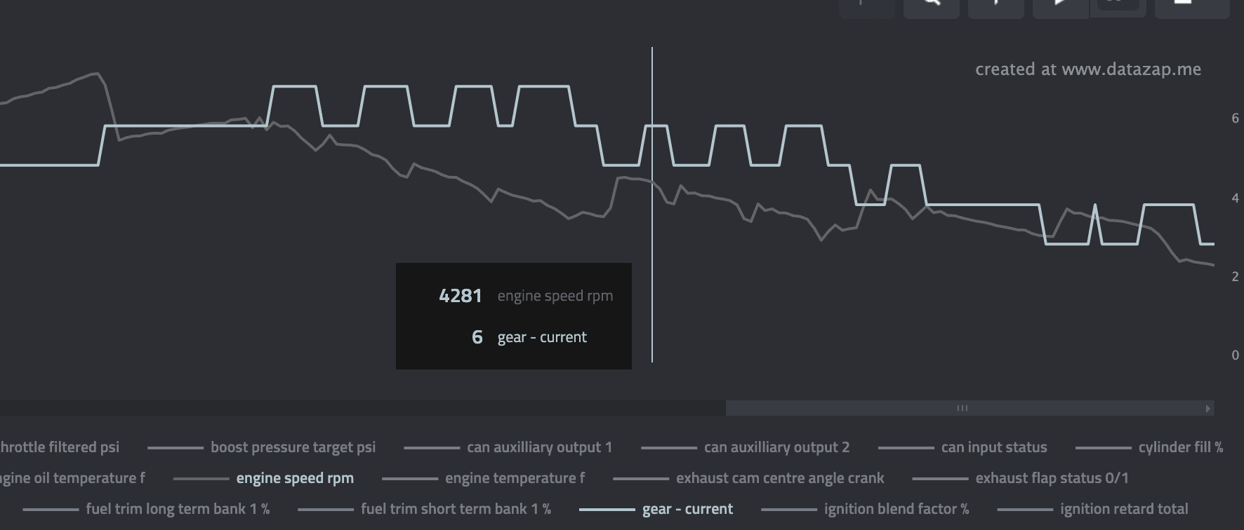

Here's XHP shifting during a shutdown at the end of the track...
light gray is RPMs, the step functions are 'current gear.'
I’m confused. Was it gear searching after you let off the pedal and coasted?
So there is obviously issues when using on the track. Street driving seems to be fine atm.
-RJM
Yuppp. Up and down and up and down and up and down and up and down and up and down then Drivetrain Malfunction. lol.
WTF…the algorithm needs some serious work.
Here's more context. Thing does bonkerses then drivetrain malfunctions. It's pretty nuts. lol.
Okay would love to see this on video if you have it. I am wondering what this "feels" like in real time. surely it's not blasting numbers all over your screen as it freaks out hunting for a gear?
It absolutely is. The car is shifting up and down and up and down.
