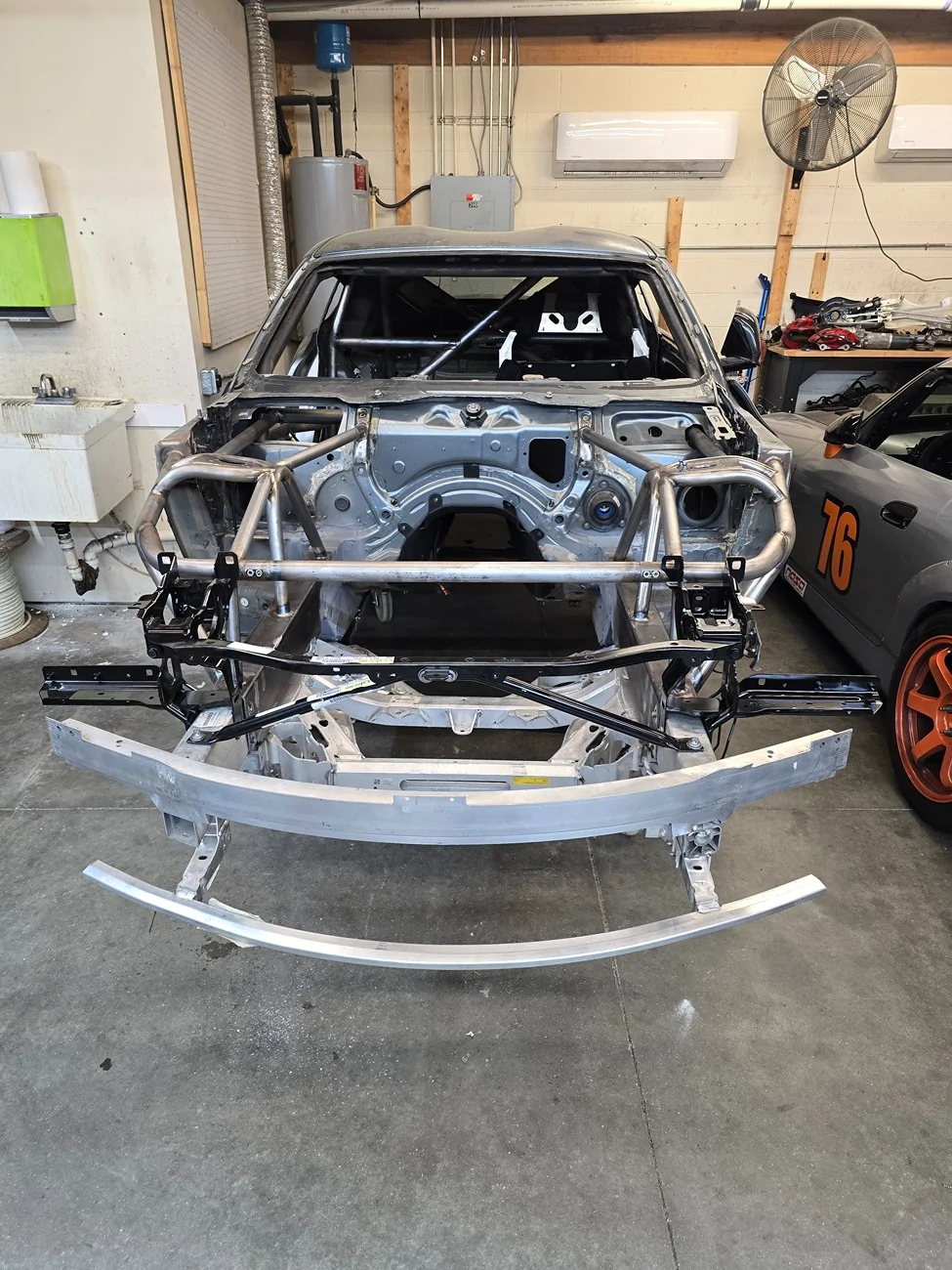

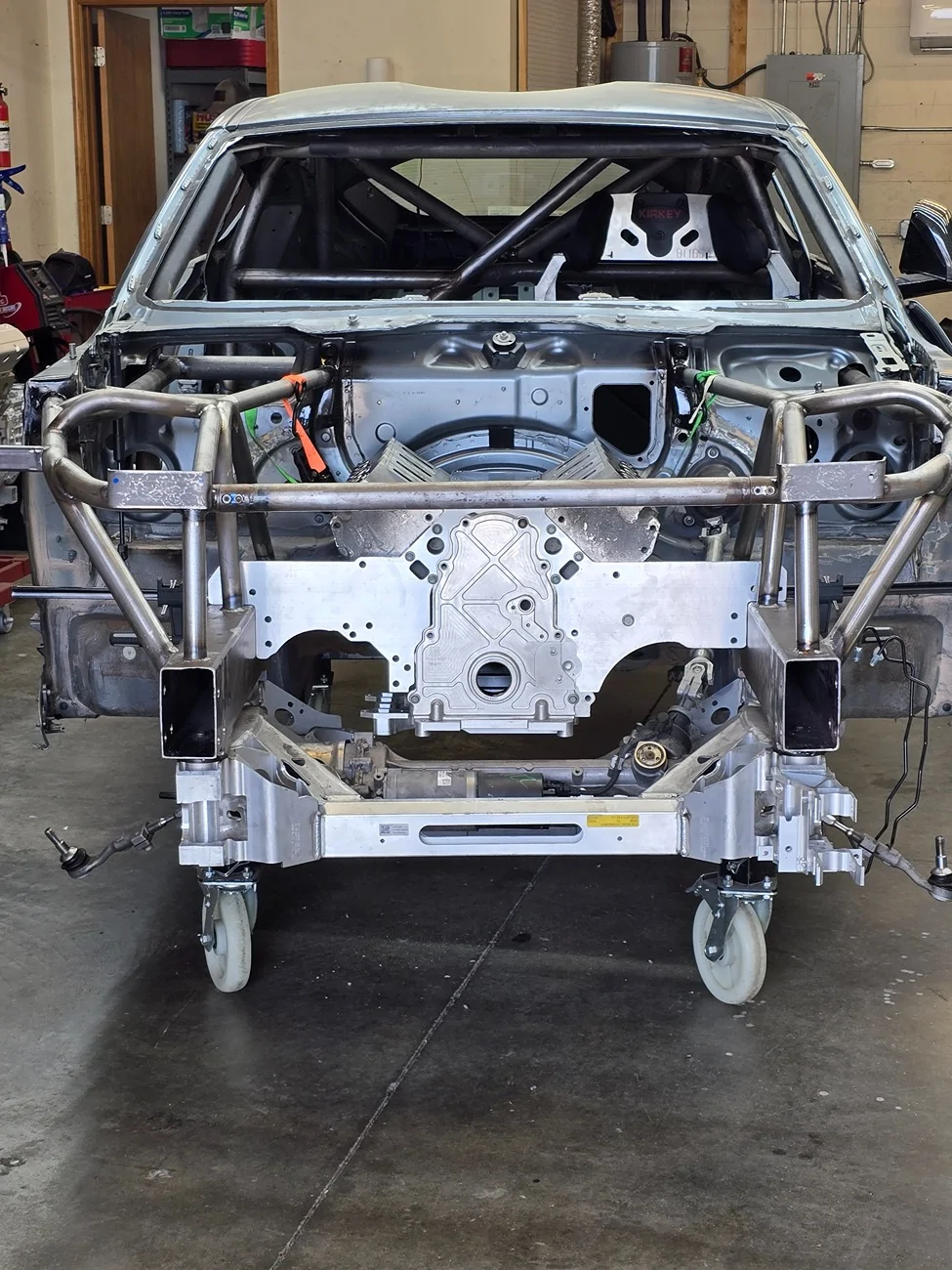

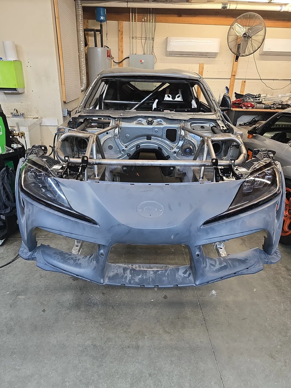

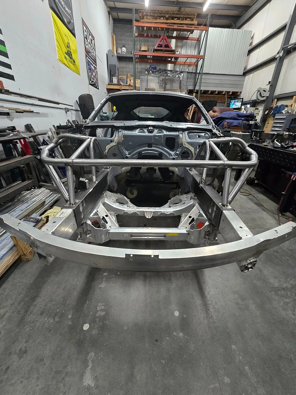

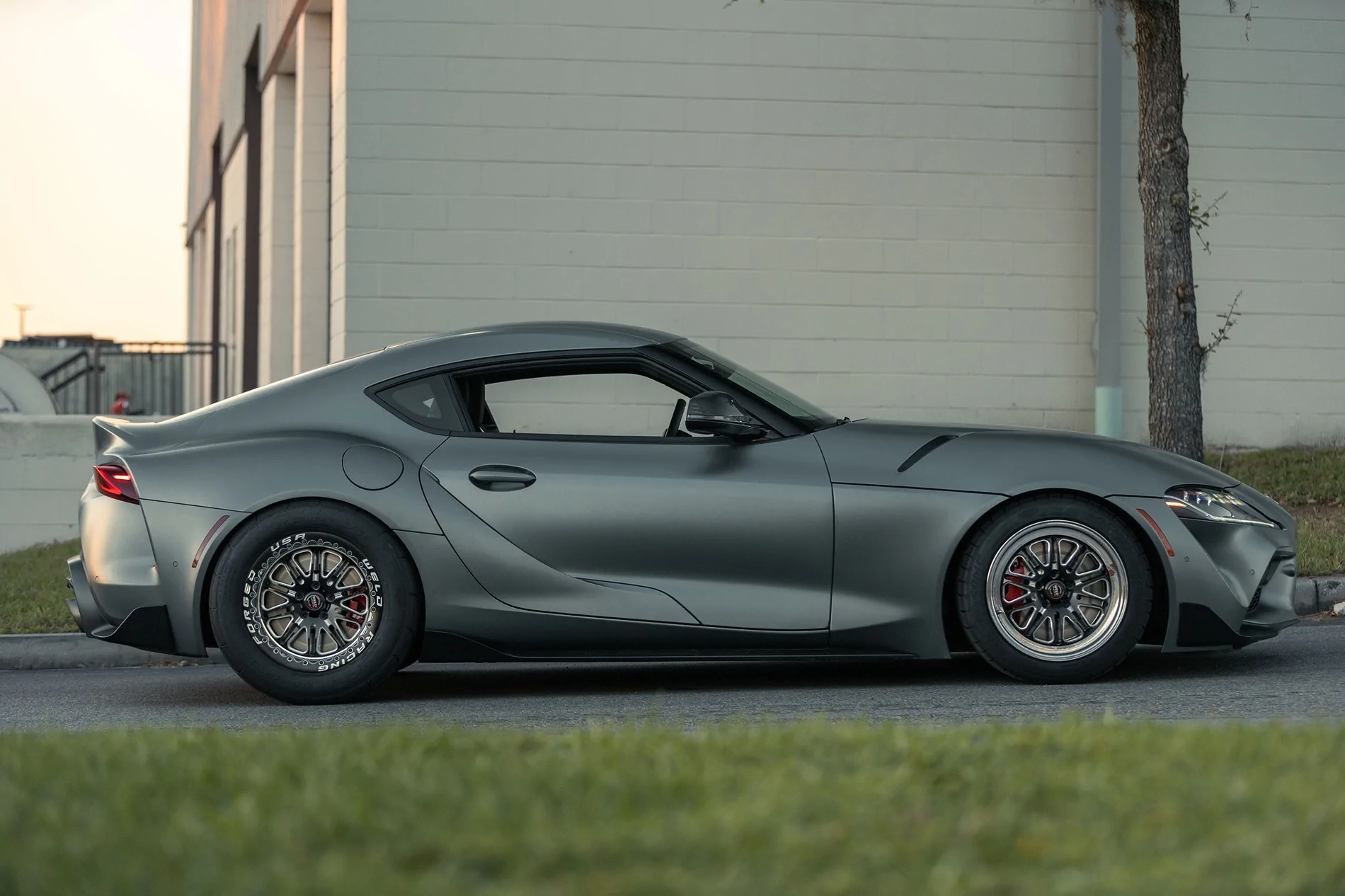

Decided to make a build thread to maybe keep me accountable and give me some motivation since life, moving, work, etc. seem to always get in the way of working on this project.
Top picture is how the car looked at one point in its life.

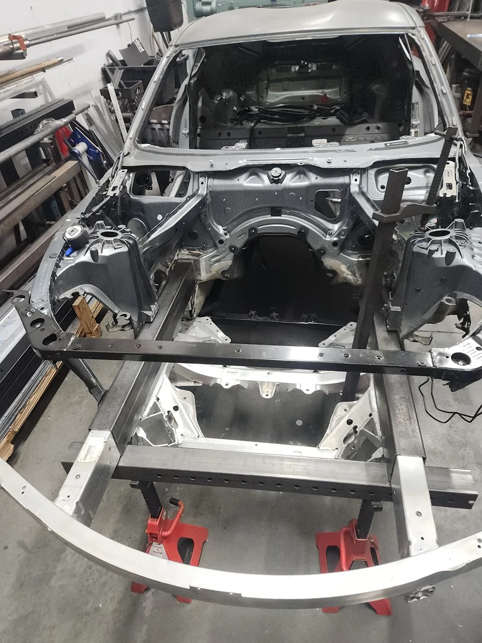

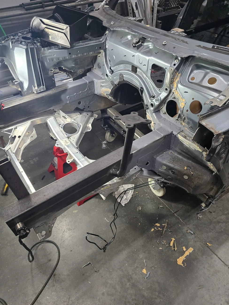

In a nutshell, what it looked like when I got it. Car had been wrecked pretty bad in the left front, bent frame, pushed the shock tower up and back. Bit of a mess.
Made plans to fix the damage and slowly realized, while it was fixable, I wanted to do something a little different. So a plan was forming and a friend, after several beers, mentioned engine swapping it. The concept wasn't unheard of, and we had the parts and know how so we set out to do it.

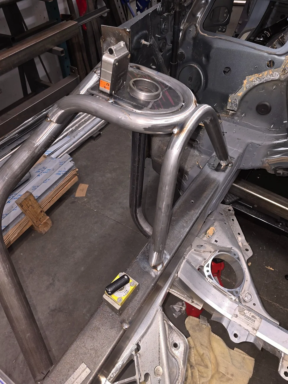

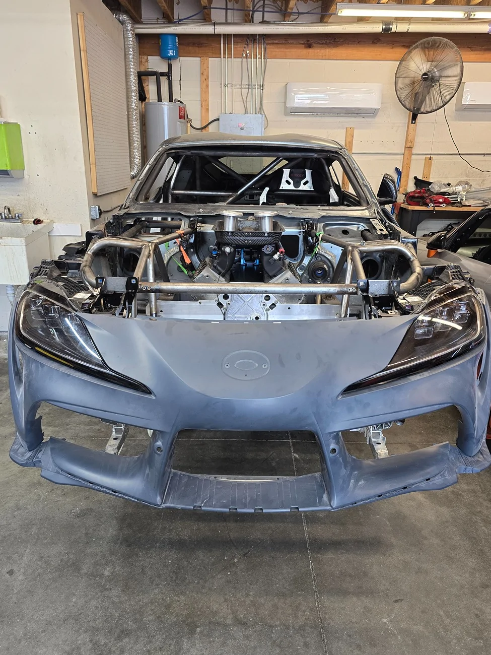

Mocking some things up

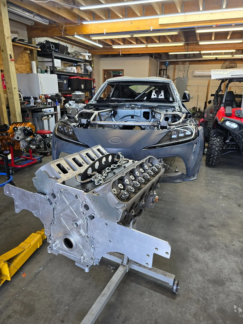

Mocking the engine up for the first time.
Obviously everything is a work in progress and constantly evolving. I sometimes get idea ADD and hyperfocus on doing one small detail just to scrap it because I didnt end up liking it.
Im always open for discussion on ideas and suggestions as well.
The car will be track focused, and more of a time trial car. I had my fill of wheel to wheel over the years and have sort of lost interest in that aspect but racing myself, in a way, is always a good motivator.
I'm looking forward to sharing the ups and downs of journey along the way.

The engine setup will be NA. I actually am sourcing an engine from an older daytona prototype that my friend had sitting on a shelf at his shop. We are going to go through it and refresh it and get it hooked up with a quaife sequential transmission.
It being an older DP engine means its about a 5.5L destroked LS, dailey dry sump, kinsler itbs, jesel valvetrain, custom solid roller cam, callies billet crank etc. etc.
Should be a fun screamer at 8500rpm:drive::drive::drive:

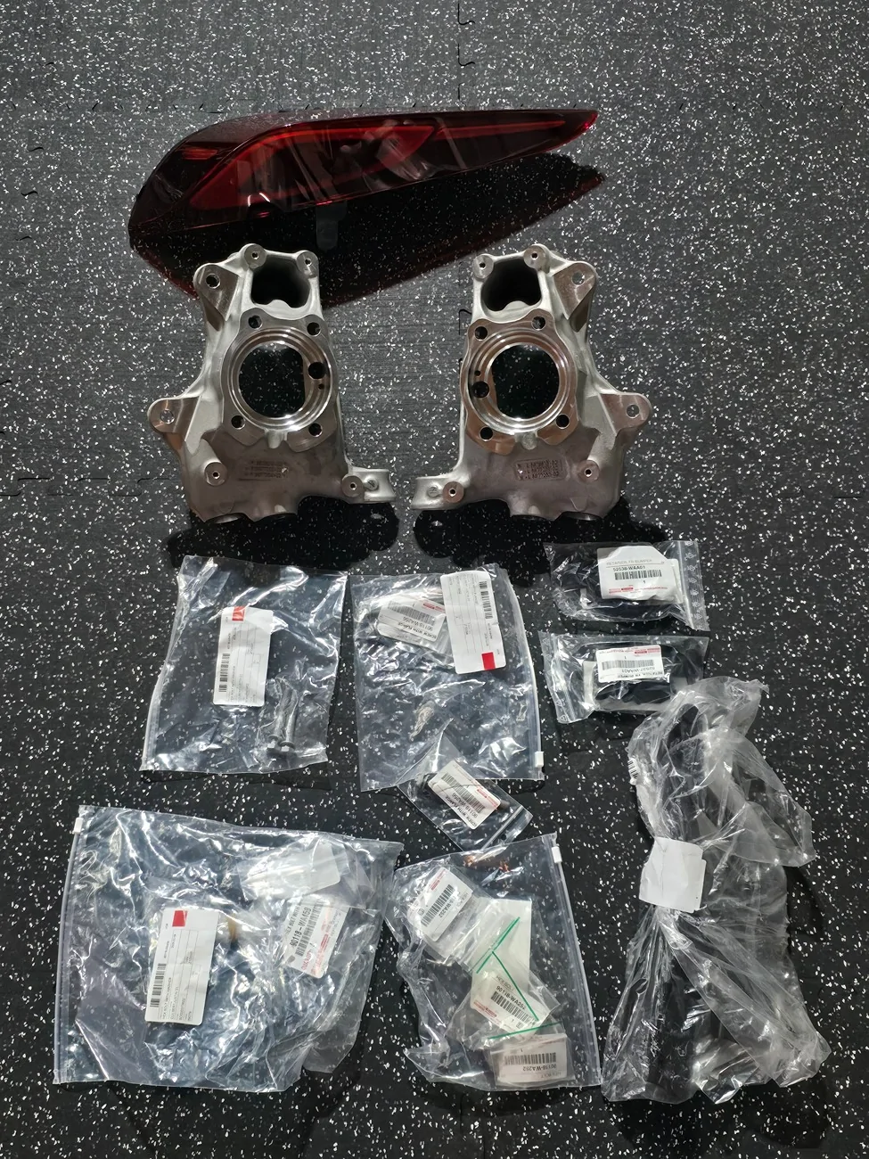

Gotta love when the Toyota parts fairy shows up on Valentines Day.
Just some things I have been needing to get for awhile and finally sat down and organized a small order.
I saw where some guys were saying the (-) camber knuckles were unavailable; well these are them and the dealer didnt have an issue getting them as far as I know. So maybe orders caught up or something?
So, the more you know at the end of the day.
