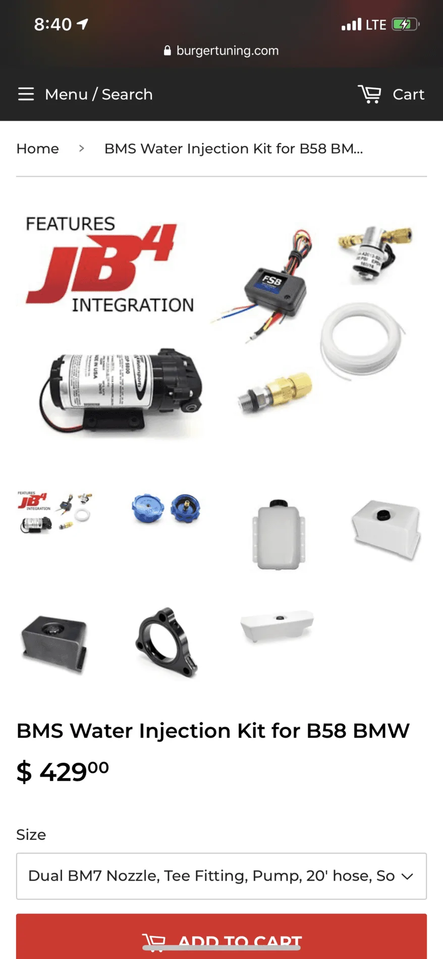

How are you tying in the meth injection to the JB4? What meth kit you using? Burger hasn’t released a kit for the Supra yet. I was thinking about going with AEM meth.
Burger WMI kit for B58 engine full control on JB4 and you could check on logs

Burger said the intake was different on Supra and kit doesn’t bolt right up. Did you have to modify?

very simple installation, is good to use a shop with experience installing WMI. Burger WMI is #1 for N54, N55, B58 and S55.

Is this the kit?
