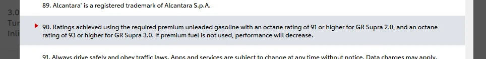

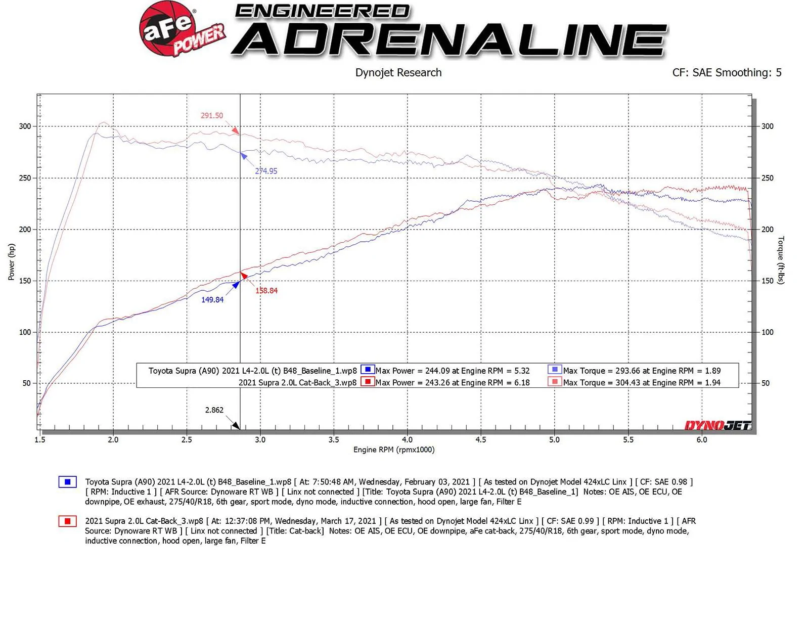

Video states Supra 2.0 is also underrated.... norm measurement to be 280 HP & ~306 ft-lb. Up from 255HP & 295 ft-lb
Conflicting data from DSPORT & video. Hopefully we can get more data points to determine if 2.0 are really underrated
*Edit: Wondering if the difference in gas octane has to do with difference in results. California only has 91 octane. DSPORT is based in California

I think the DSport car was suffering from heat related timing issues that many boosted cars have. Here's another dyno from California I found on here.
