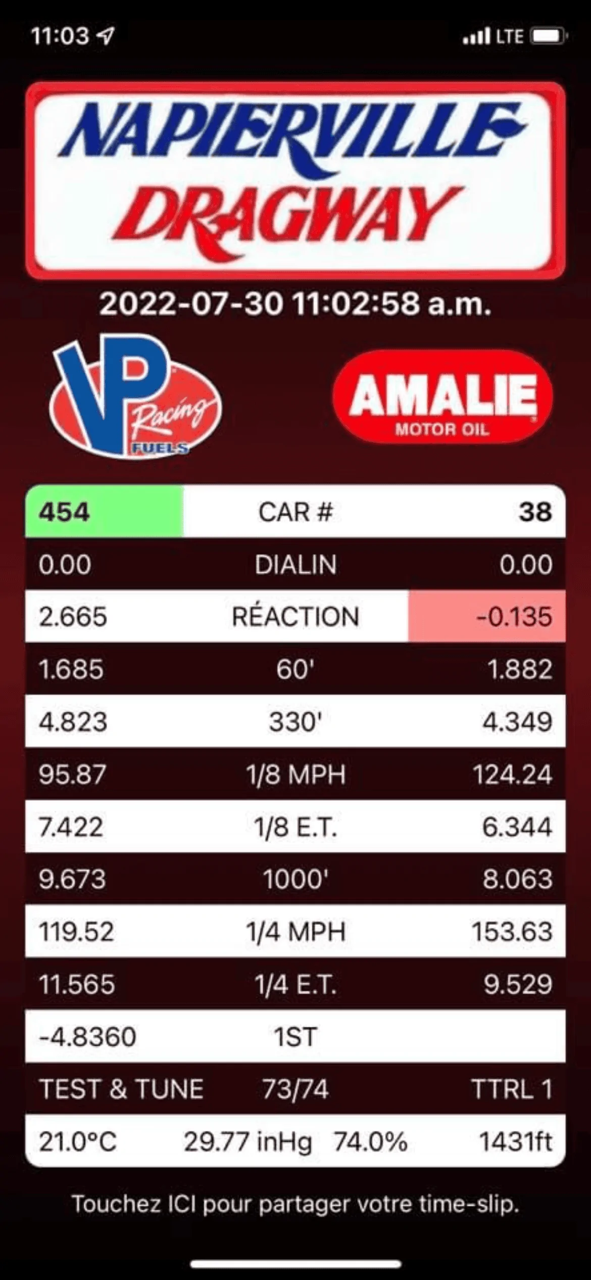

Stock supra doesn't trap 120 anywhere.. That's like 6-8mph faster than any stock supra I've seen. MPH/Trap is a function of horsepower, nothing else. Not driver ability, not 60', nothing. A stock supra doesn't go that fast, especially in 3000 DA, where you had on that day.
Stock 2022 3.0 with a drag pack.. 11.565 @ 119.52
No parts added
