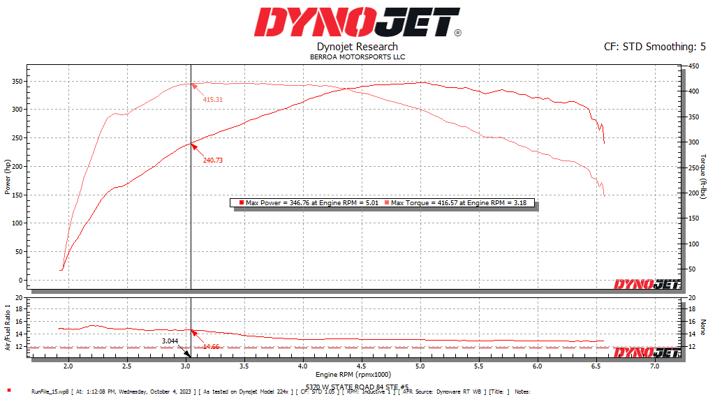

Hey guys wanted to share this here to show the potential of the B48s in the 2.0 Supras. There seems to be misconceptions of what the car is capable of since most just run JB4s or downplay it because its a 4-cylinder. I have some super respectable results to show on the stock turbocharger. This car will be getting an IM450 turbo upgrade soon for 450whp STOCK ENGINE.
Build List:
2021 Toyota Supra 2.0 B46TU
IPOS Motorsport True 4 Inch Downpipe
IPOS Motorsport Upgraded Intake Manifold
IPOS Motorsport Icebox Kit
Takeda AFE Intake
E85 Map from NavardiTuned
Stock Turbocharger/Engine
346whp / 416 lbs-ft
Video of the dyno: https://www.youtube.com/watch?v=vvY-qZyKTIw
I will have dragy numbers soon!
Any questions feel free to hit me up on insta @i4.f30
