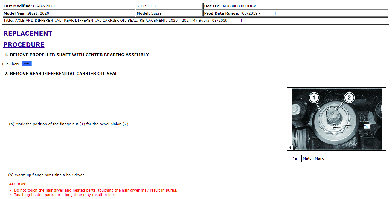

No backlash needs to be adjusted for a seal replacement on this setup.
The tech didn't go into details about the tools that he ordered, but for sure, I'll pay attention to anything out of the ordinary when I get the car back.
Yeah, that's part of the delay with fixing these, as the tech needs to request certain tools that Toyota North America will loan out to the dealership, on a case by case basis. I just read the directions for replacing the seal, and one of the "tools" involved is..a hair dryer. :rofl:
I mean, I understand the need for heat guns, and we all have them, but it's funny to me that instead of a professional heat gun, they actually use the term "hair dryer." Heat guns must be too strong for this particular need.
So the nut needs to be enlarged by heat application to be able to spin on the threads?

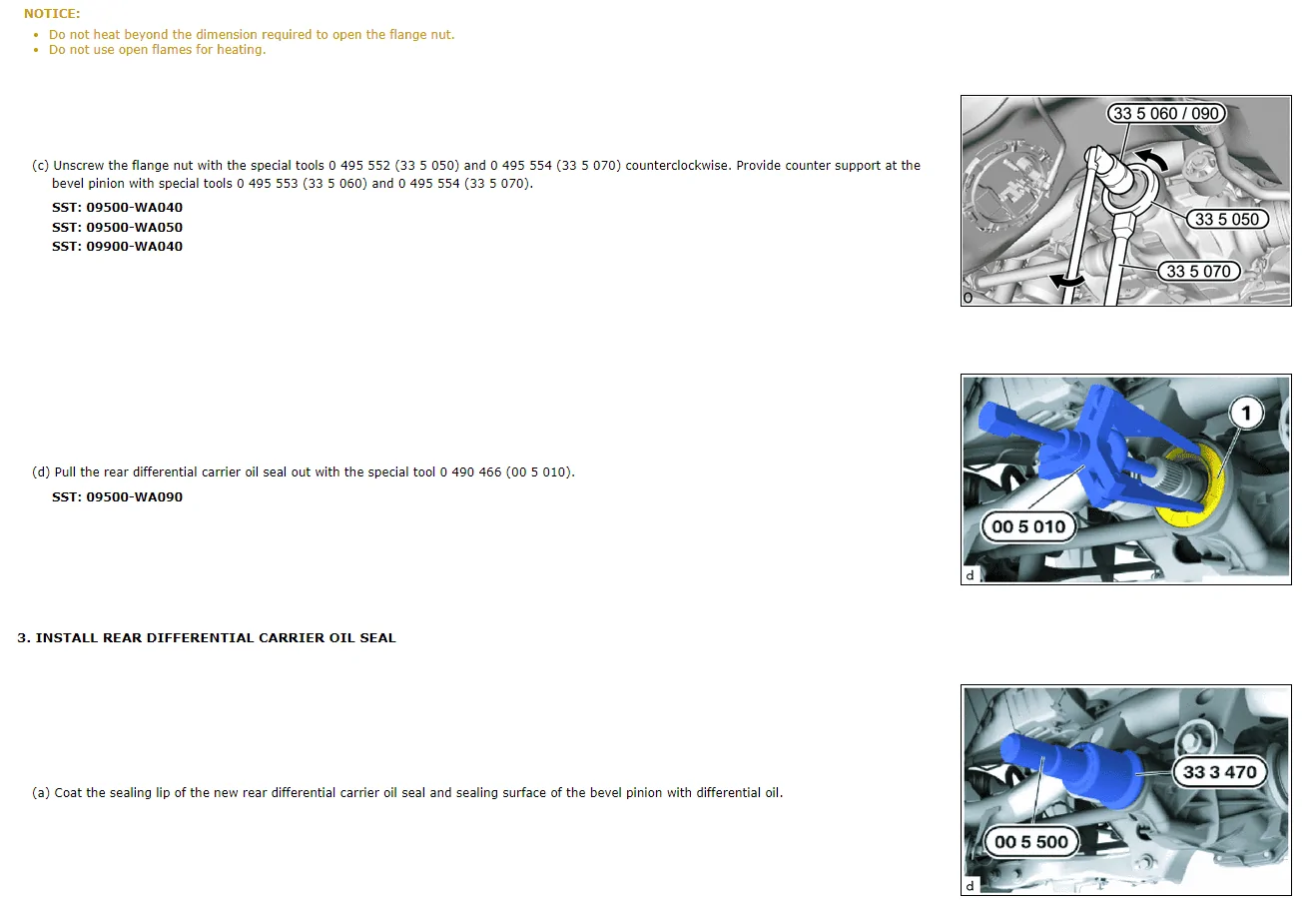

Yeah. Here's the directions directly beneath the page posted above.

Those do look like special tools!
