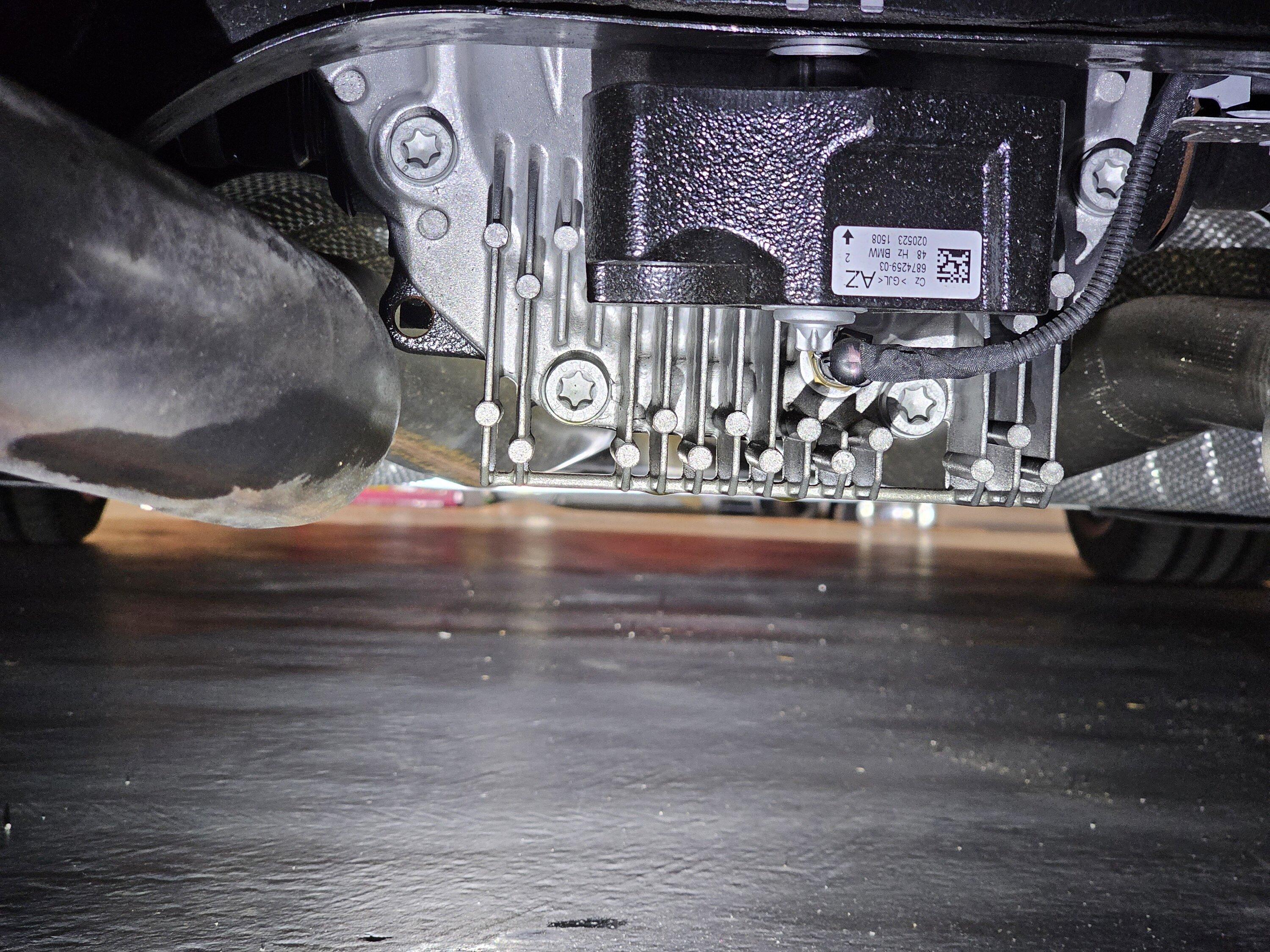

Phil, did you happen to see this photo I took before I brought my car in for inspection? Any thoughts about it?
Other than the fact it has an obvious but not catastrophic leak no, sorry.

Okay, I may have to drive to the dealership in order to talk to one of the service advisors about the simple test you mentioned. I will also try to get a copy of the photo(s) the Supra tech took before documenting his diagnosis.
