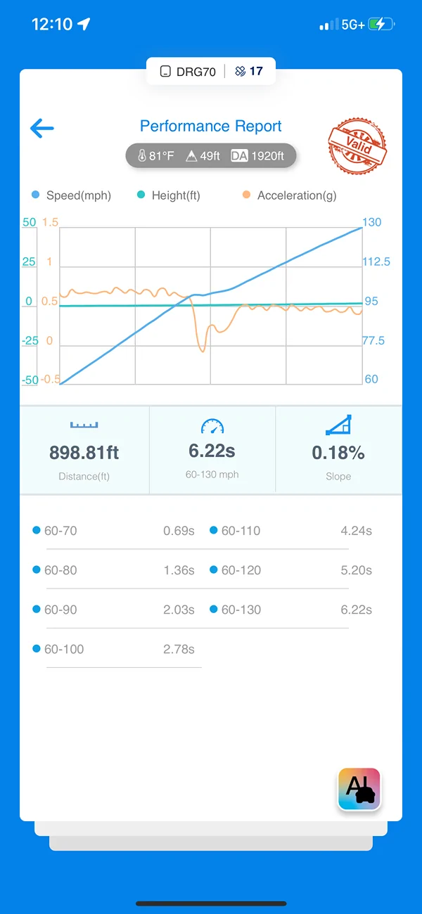

holy smokes, is that on stock motor? Any dragy done yet?
How does the 7275 feel on the street?
It feels great, there's some lag but it's nothing that brake boosting or anti lag can't fix. It's stock motor, only at about 29 psi for now as we're still getting this map dialed in. Next map will be 36psi. I haven't done any dragy yet because the maps aren't finished, and I'm at 7500 DA so the times are gonna be trash regardless lol

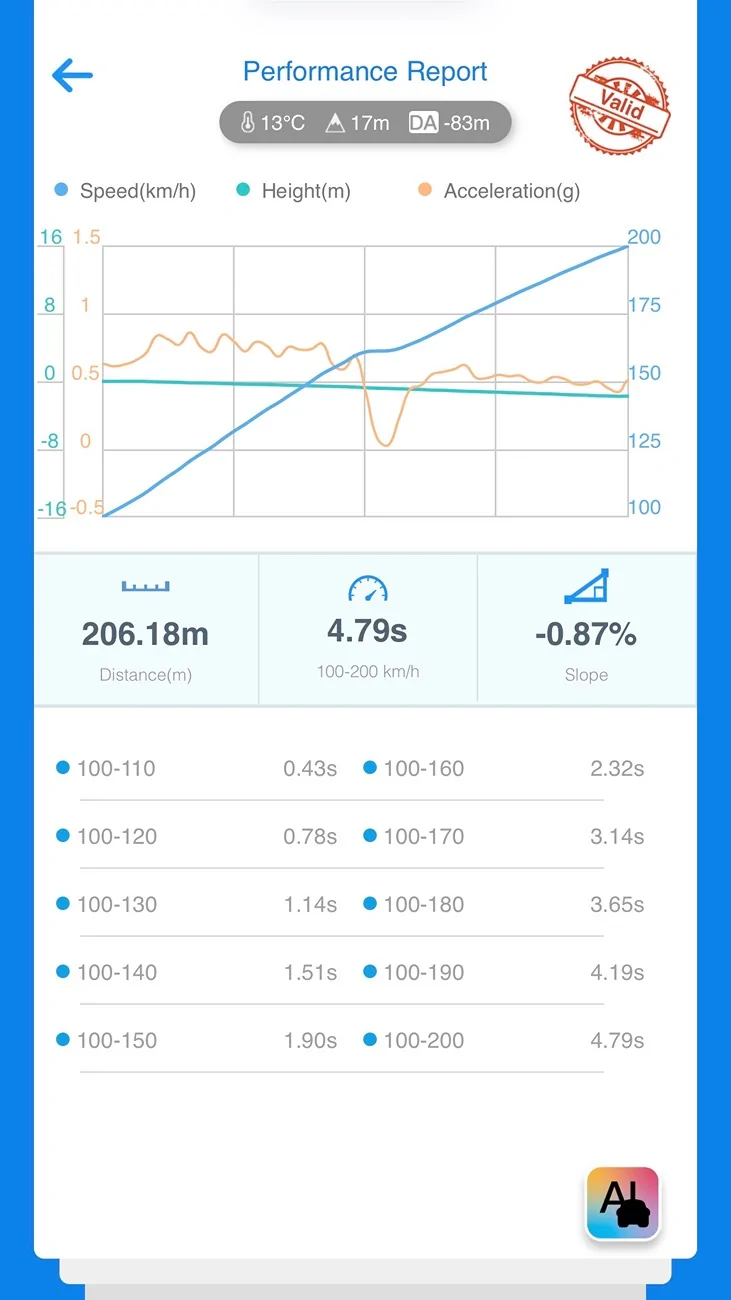

Slowly itching towards the 5’s in this insane Florida heat, felt like it pulled power on the shift, does anyone know why it does that? It builds immediately and then goes down then back up and continues the run, i seen another big turbo manual do that too. Tuner wants me to get a log tonight for him of me shifting see if there’s anything he can do. (this is a 5.4 100-200kmh)

Are you running PI or just upgraded DI? What e mix?

are you using NLS? post a shifting log
Yeah this is NLS,i don’t have a shifting log but i will soon. car must’ve popped the chargepipe yesterday it’s parked right now till i get time to fix it
If its losing too much boost mid shift you can have your tuner raise the "wgdc during blow off" table

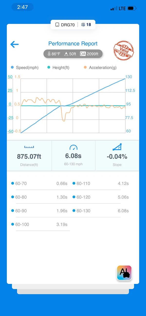

Got rid of the pure900, went top mount 6870. First pass on map 2 on the way to work. not ideal conditions at all but honestly not bad. 34-35 psi 11-13.5 timing throughout the pull. Wastegate dump sounds so crazy
It’s moving but should be faster on 35 psi with a 6870
Yeah i agree but the timing is pretty conservative honestly, only 11-13.5 most people on Ethanol run 14-17 up top.
