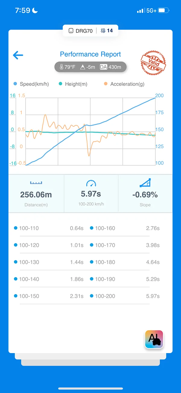

Tune is fine, boost target is over 20psi, the timing is there but the turbo still just won’t spool how they claim it should. Atleast on manuals, i have a few friends with manual omega and we all have the same late spool target boost being hit around 4500-4700. Here is the 100-200, and a datazap log. https://datazap.me/u/pxtra/logs/cmr...0x3-4&sizes=50x50&sc=3-5-20-33-35&axes=shared
Raise your oil pressure to keep Vanos Ex on target. May help a little with spool up. I just did an M240 with omega 65 and it is spooling up a couple hundred rpm sooner. Its possible your wastegate arm is still not quite right and "100 wgdc" isn't really fully closed. I've never seen a difference between manual or auto for spool tbh.

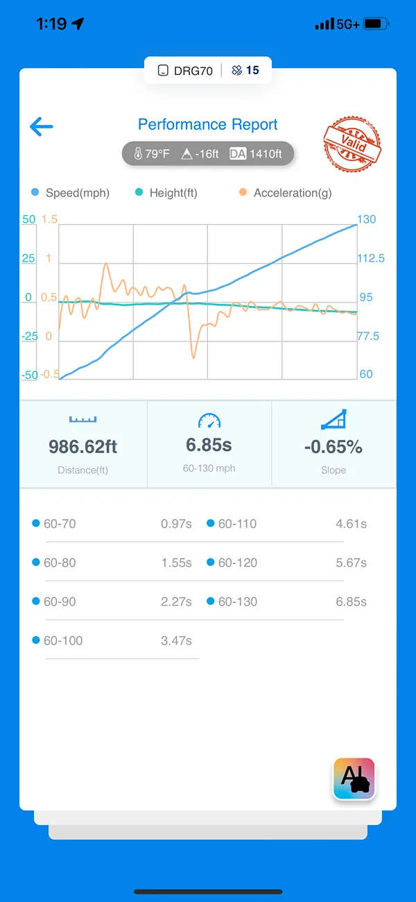

thanks man, mine is the same my 60-70 is almost a full second and then it hits boost target. As you can see with my acceleration.
Swapped to the remnant V2 housing without a revision and did this run on 94 off the bat without NLS. problem is the V2 doesn't spool until 105-110 even with a roll in as you can see in acceleration (g). with a revision it might do a 6.1x or a 6.0x
Haven't done the log yet, but as you can see on my 93 map 100-200. im spooling earlier than you and holding gs. Were you spinning when the boost hit because it looks like the car was either having trouble spooling up or was spinning based on g-force
100-110 is 0.49
