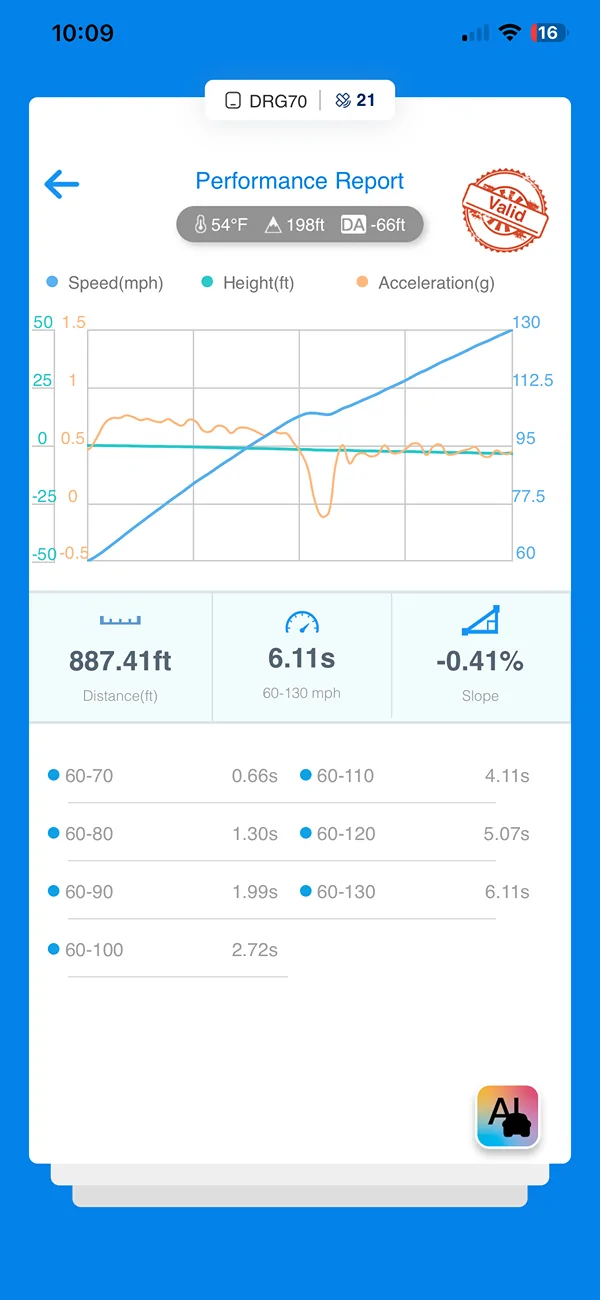

so far it’s fine with 14K miles on the tune and a lot of track time. I asked Shoup to save the rods so my E40 tune has the torque pushed later in the powerband.
feels stock until I get on it which is nice.
Does it feel a little sluggish down low because of that? I assume you are rolling into 80kmh in 3rd game when doing your 100-200kmh run.. Must kick you in the guts once its at like 4krpm+ lol.
Also please post another time once youve kicked it up to 35psi! I am very interested to see, are you using NLS as well?

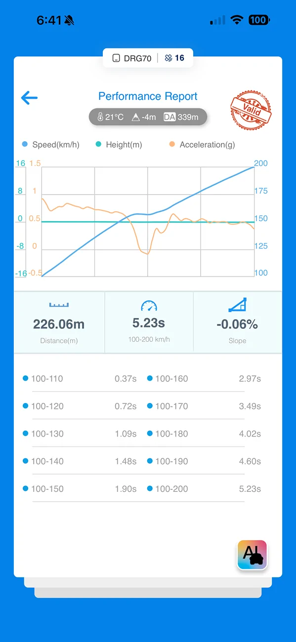

E65 on this run
started at around 80km/h rolling into it and WOT by 95km-ish
no NLS and shift was terrible
still using 275 continental SC7 tyres, lost a bit of traction on initial hit and during 3rd-4th shift, got MT street R in 305/45/17 to be put on my 17" bead locks very soon.
I think with the stickier / taller tyres and a much cleaner shift with a tiny bit of better traction, could possibly break into the high 4s.
I also shifted close to red line when i should probably shift at 6krpm as that would put me at 4.2krpm in 4th which is right at the start of my peak torque and power curve on the dyno.
still tryirng to figure out the BEST way to start the run, whether its 80km/h and rolling onto throttle to build boost OR just start at 90-95kmh and use rolling anti lag..
any feedback or advice/tips would be appreciated!

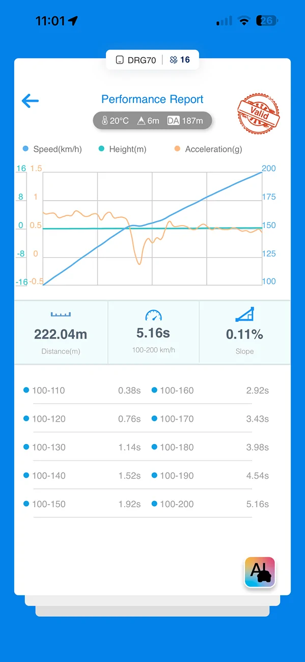

Finally managed to do away with the 275 contis and put on the 305 MT street R's and manage to shave nearly a tenth but my shift is still so slow.. anyone here experimented with MHD's NLS and whether its actually worth using?

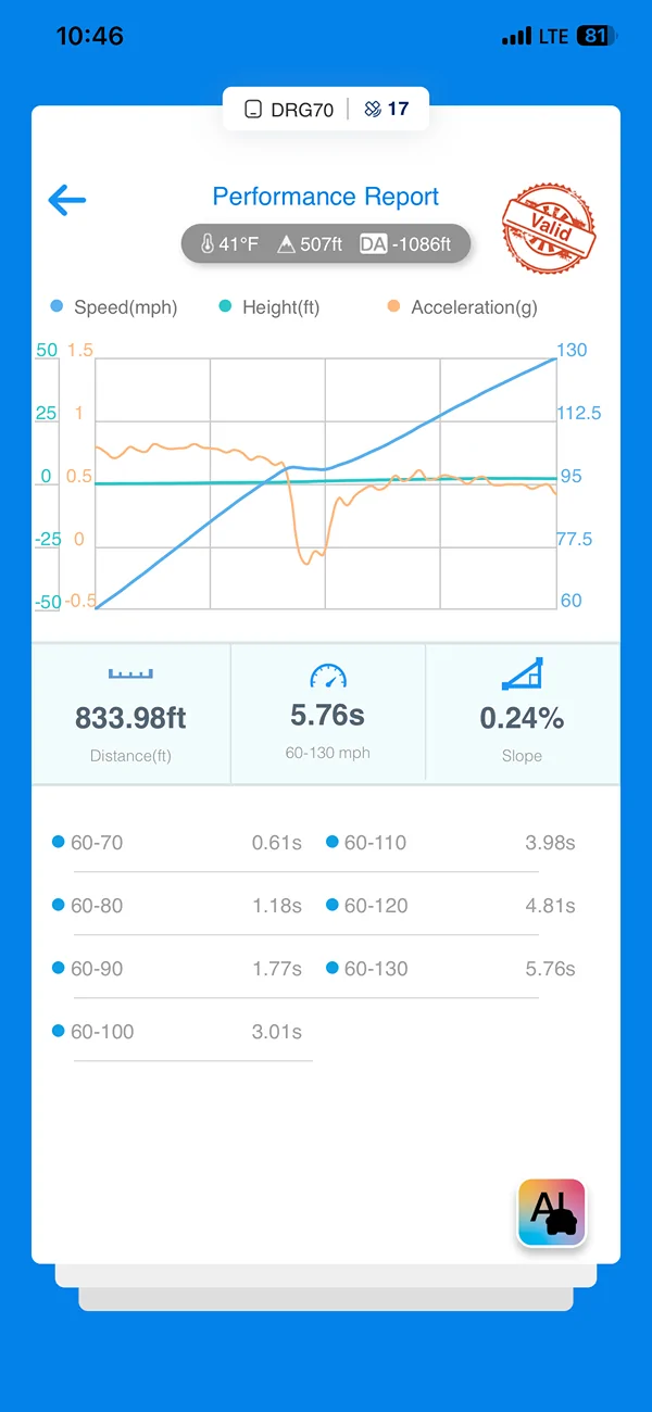

I use it … there isn’t too mic difference it’s just smoother typically … here is my graph 100-200 stock turbo

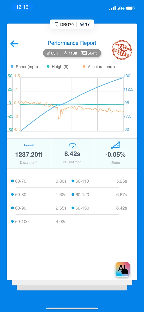

Same map as the 6.3 but this time with 18x5 front runners and I finally put an aftermarket exhaust on. Turning it up the next time it’s nice out and might use NLS
Man that is a way cleaner graph compared to mine lol.. i really need to work on my shifting because i reckon it has a high 4s with some better DA.
I wonder if tuners can refine the NLS in MHD so that its even smoother or holds boost better.
What's your NLS rpm limit set to? And what RPM are you shifting from 3-4?

5k limit and 6500
