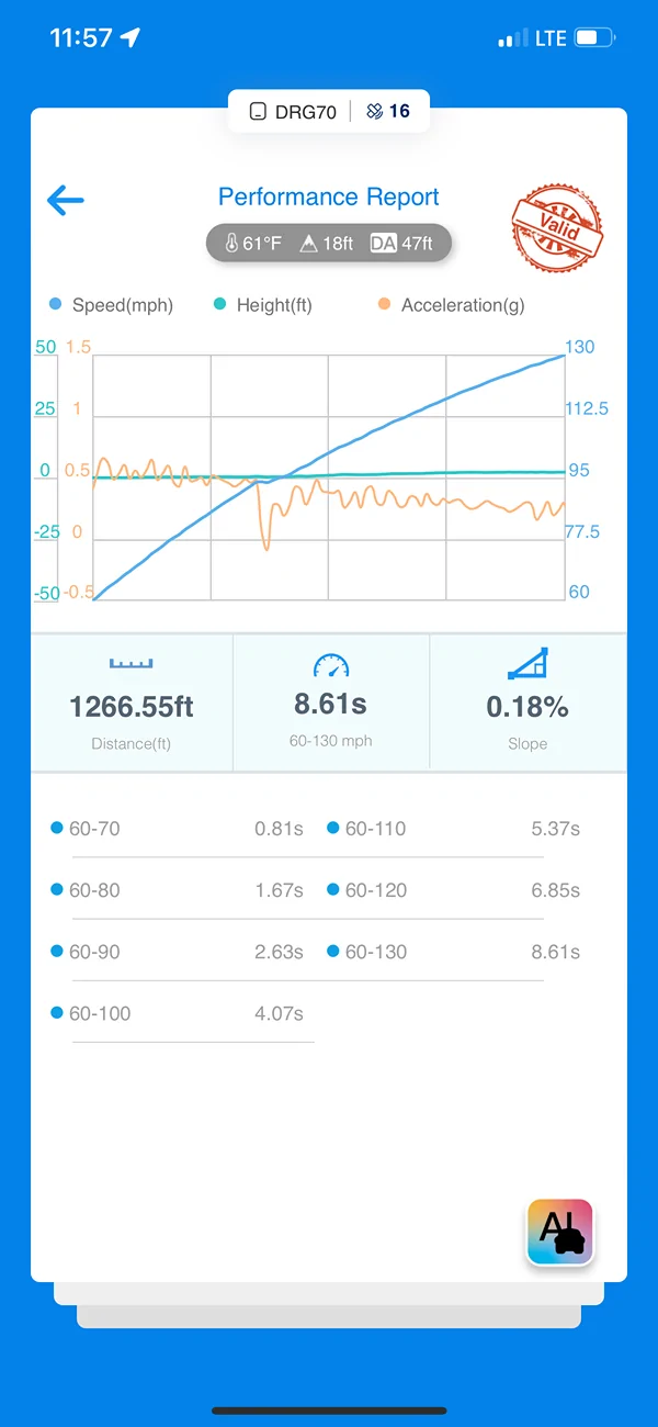

This might be the fastest time I've seen for 6MT.. How much power are you making with your setup on 28 psi?
That pull was probably upper 6’s
I really should get a 60-130 in. This specific run was at 1800 ish da temp was 80f
boost 31 psi rolling in to the run.
Fuel is e40
Tune is conservative
Should be equivalent to a 5.9-6.1 60-130.
gonna do a run on 35 psi in the spring.

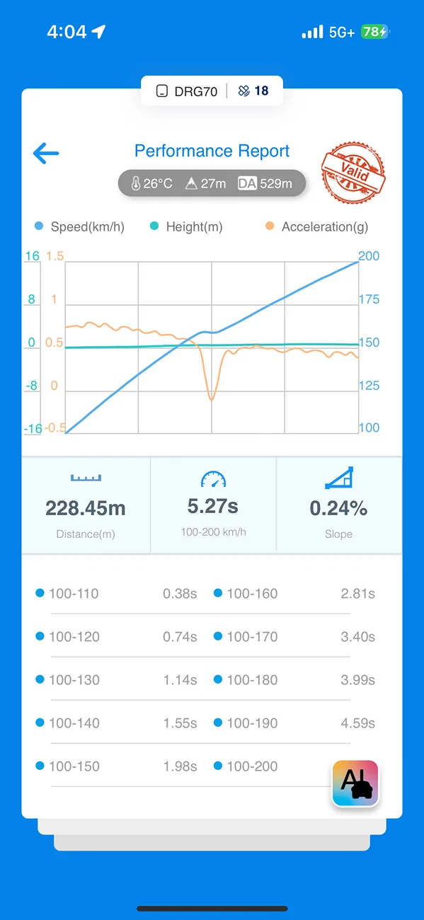

Fuel is e40
I’m from Australia so 100-200kmph is more relatable for me lol, 5.2sec for manual transmission is insane.. and you’re saying this was only 31 psi vs 35psi that you’re capable of? How much power are you pushing at 35psi and how much faster do you think you’ll get compared to 5.2?
Not to sure tbh, with better da and temp I’m sure the car could do 5.0 on 31. So maybe 4.5 in perfect conditions on 35psi. I’ll play around with NLS, better tires and boost by gear this summer and find out.

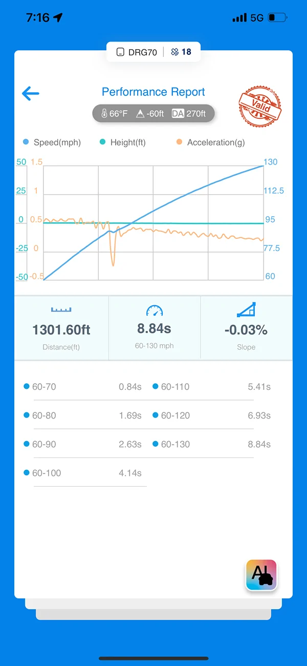

First pass with PTB clutch and trying NLS
E40 OTS tune
