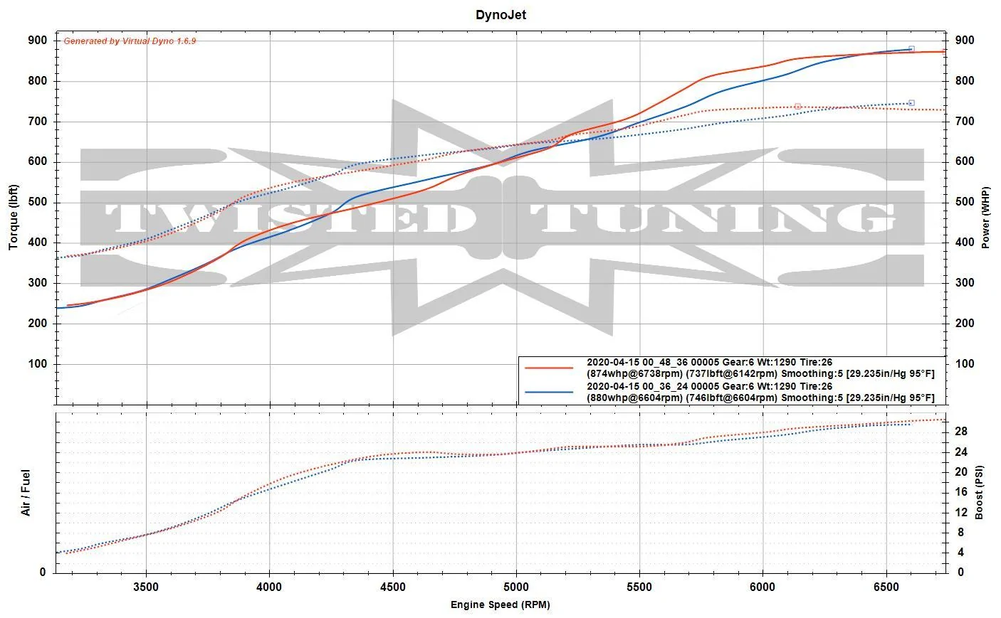

Side by side of our 767whp dyno pull with just plugging the log in from the same dyno pull.
Weight is different as car was on dyno so changed weight to roller wieghts and etc. Look how spot on. torque is a tad high. 640 VD vs 620 on actual dyno. But not bad.

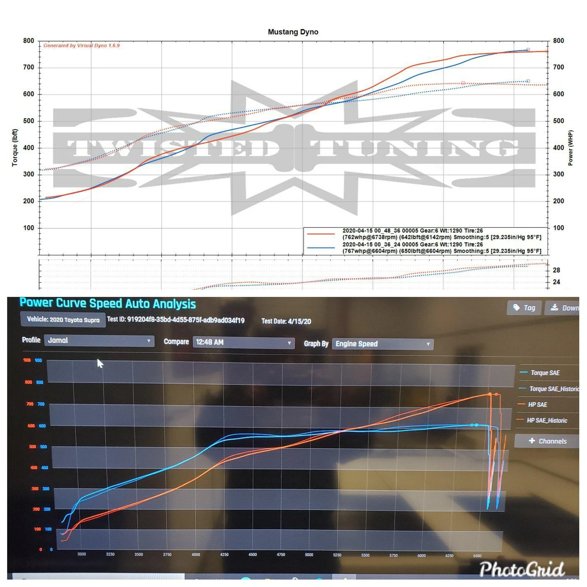

For shits and giggles. I switched the VD from above to dynojet correction. Lol
Damn!!!
obviously something is wrong with my VD file, it reads lower powered cars nearly spot on, but anything over 5-600 and the numbers don’t seem nearly as close

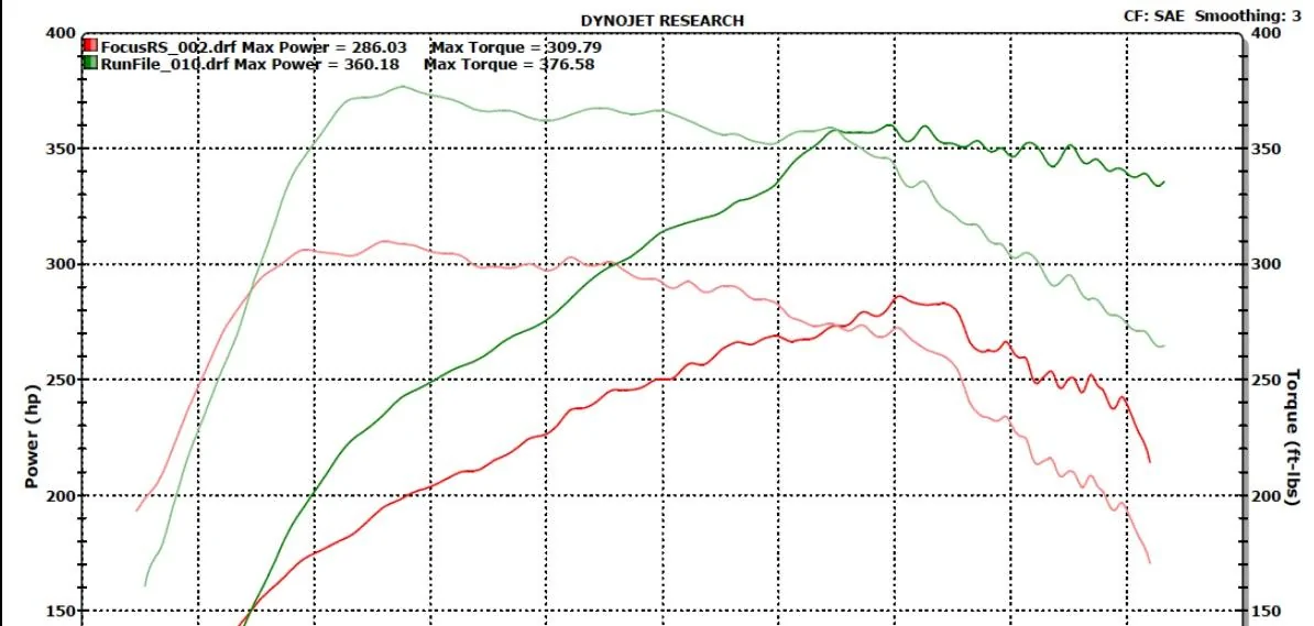

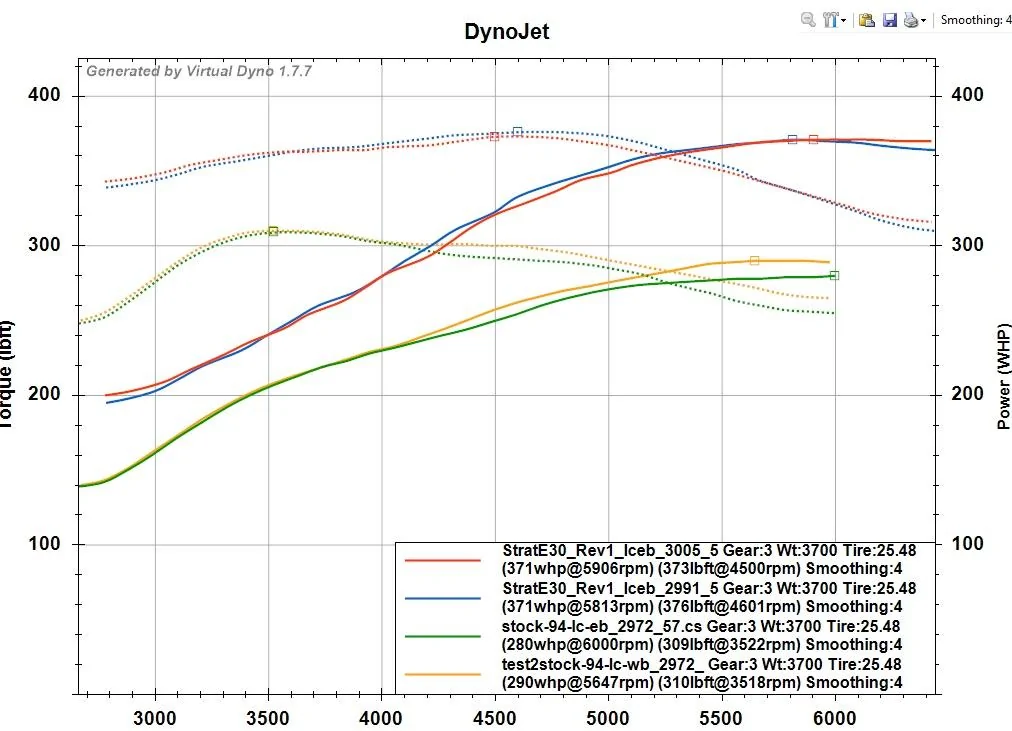

I've seen claims form a FocusRS tuner that vdyno is grossly inaccurate because they used their dyno run as the log source, and it wasn't even close to what the dyno showed, therefore VD is worthless. Trying to hack the parameters in vdyno to get an accurate result misses the point & design of vdyno though, so it's not really the way to validate it. Not meaning to discredit the effort of Twisted Tuning especially since I agree that vdyno is pretty accurate, just illustrating the like for like comparison would be dyno-on-the-rollers vs VD-on-flat-pavement rather than trying to massage the input parameters in the app to get matching results.
I'm just about to start the process in the Supra, but here's how I validated vdyno when using my FocusRS. Repeatability was key to me, and this sated my skepticism enough to trust vdyno to feed the data junkie within.
First is the dynojet results of stock compared to tuned:
Second is the vdyno version of those same setups, two runs each (opposite directions, same stretch of road):
Hacking up the parameters is necessary to make it accurate with any new platform that doesn’t have a profile and all dynos read differently and will give a different reading day to day. Most tuners adjust their VD settings to closely resemble the dyno they use in house. There is nothing wrong with using this tool if it’s adjusted properly, it’s been used for years in the evo community and gives relatively close results.
I think we're ultimately saying the same thing...without published aerodynamic figures (Cd & frontal area) there's no way to avoid estimating those profile settings. What I mean by 'hacking', logging while spinning the rollers which skips chassis aero drag altogether and then trying to tweak the profile to make the log produced during that run jive with what the rollers said.
In short, my view:
Dyno chart from rollers = good
Vdyno chart from (flat/level) street = good
Vdyno chart from rollers = bad
I only mean to contribute my effort in validating vdyno as a useful tool since it was brought up in post #293
For me the logs will be taken from a 3rd gear pull for a couple reasons, mostly the speed on public roads, and also the faster we're going the greater the error if our aero estimates are off.
