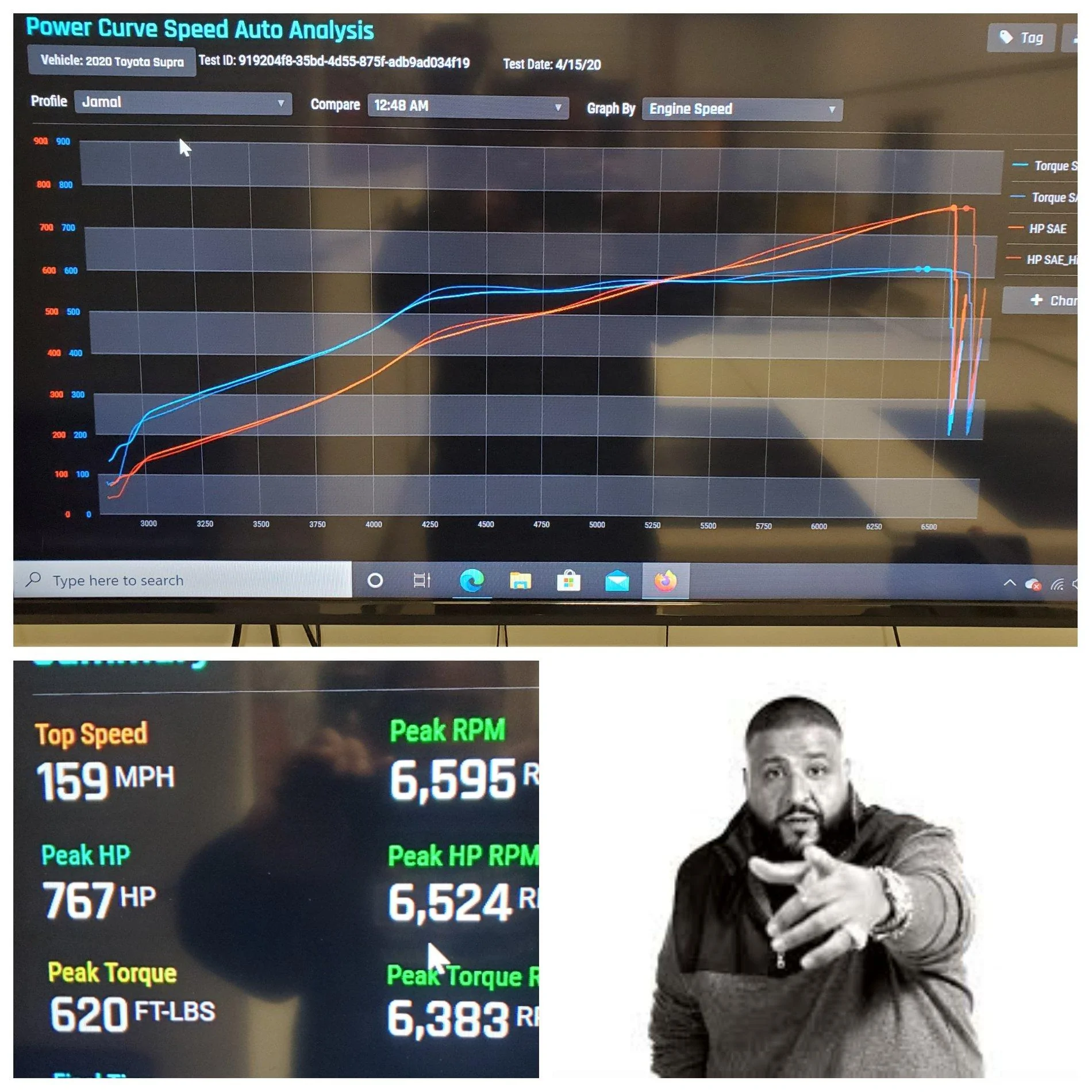

Tossed Her back on the dyno around 12-1am forna late night... or would that be an early jam session. Tossed up some more boogie.
767whp, 620wtq (mustang dyno)
