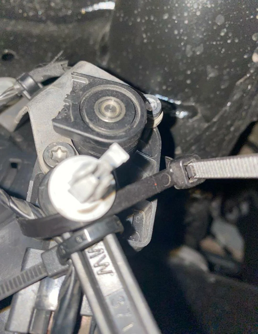

Tried to do a dyno run today with a friend
2 different Supra's followed video instructions
Car does not hold gear, multiple codes after..
Tried clearing and kept getting chassis error back on both cars after a short drive
Disconnected battery and code went away
Now headlight is out of alignment :(

Headlight is easy. There is a sensor that clips into the driver's side control arm and is probably knocked out from them strapping it down.
Are you not putting the car in manual mode on the dyno? Are you in dyno mode when on the dyno?

Sensor is in place.. Even unplugged it and plugged back again. Still pointing upwards
Yes, dyno mode, dsc off and manual
On both cars

Rear headlight level senor was broken
Zipped tied it until I could order one tomorrow
No more chassis code

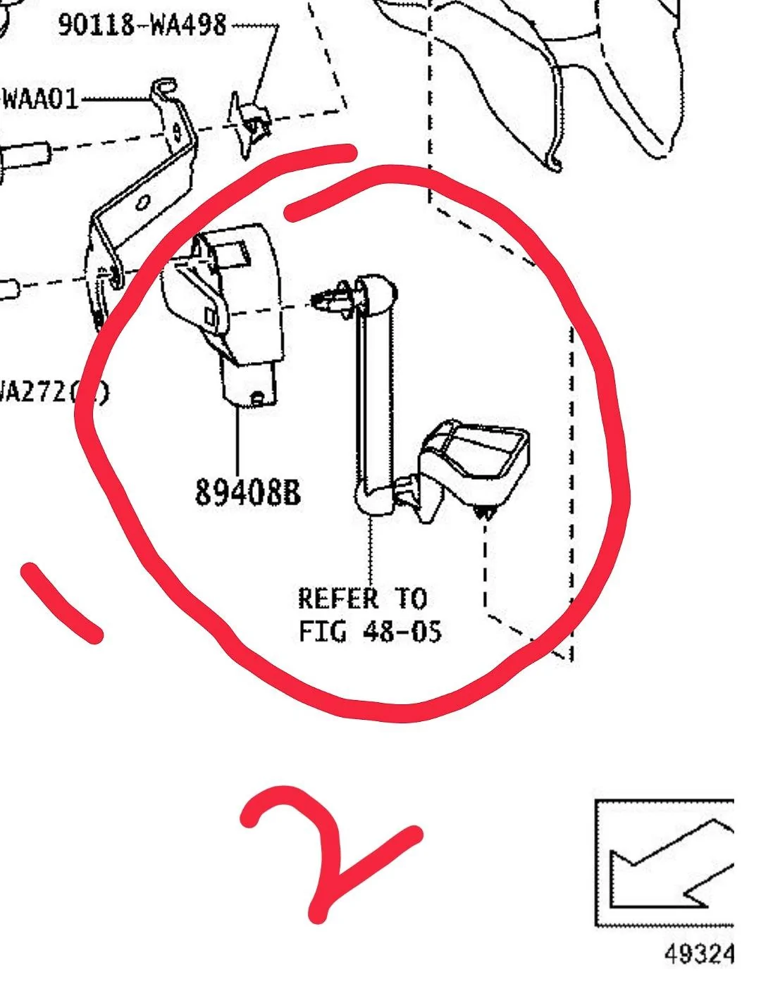

Guys.. Part is not available and needs to be ordered from Japan
Both cars have the same exact sensor broken
Just a heads up for anyone willing to dyno at a shop not familiar with the car
Chassis error code, headlights alignment issues and very stiff suspension

Parts ordered from Japan??!! Toyota part located?
Checked with a supplier from the US and was informed its not showing in US dealers inventory too
Part number shows no results
Needs to be ordered from Japan same as Kuwait...

Sorry my comment was a bad joke. Just assumed bmw parts equals order from Germany. But you said japan so I thought you found toyota manufactured parts on the car.
Haha yeah looks like the upper sensor is JDM lower part (plastic hand) still says BMW :D

yea, this is a common issue issue with shops not familiar with the suspension underpinnings of the car. but it really only takes the operator to pay a little attention of where they are hooking up at. easy problem that can be avoided with a little attention to detail
