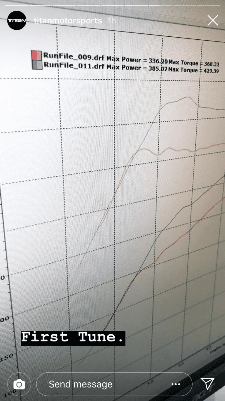

Featured A90 Supra MKV on the dyno
Discussion in 'General Supra Topics' started by Goose, Jul 23, 2019.

    did you do the run-in procedure as per the manual prior to dyno run
    awesome work nonetheless

    now the real fun begins!

    Can you tell us when you have this tune available?

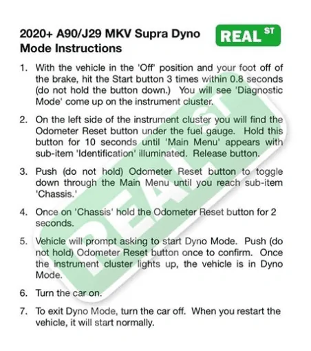

    Mk5nut, Saeedali78, DesmoSD and 9 others like this.

    Holy shit so if you were to convert that to crank hp with 10-15% drivetrain losses that's hitting approx 410 hp and 460 lb-ft?

    10% would be a more conservative estimate considering what we've heard about this transmission. But yeah, we knew the numbers were high from the C&D dyno (also dynojet), though quite a bit lower then what they saw. Which there was some speculation was from tranny slip, but the dyno didnt really show signs of that. Would be nice for someone to do a reliable 0-60 test on a car that's put 380ish torque to the wheels and see if they can back up the 3.8s. If not, the press cars may have had more aggressive tunes.
