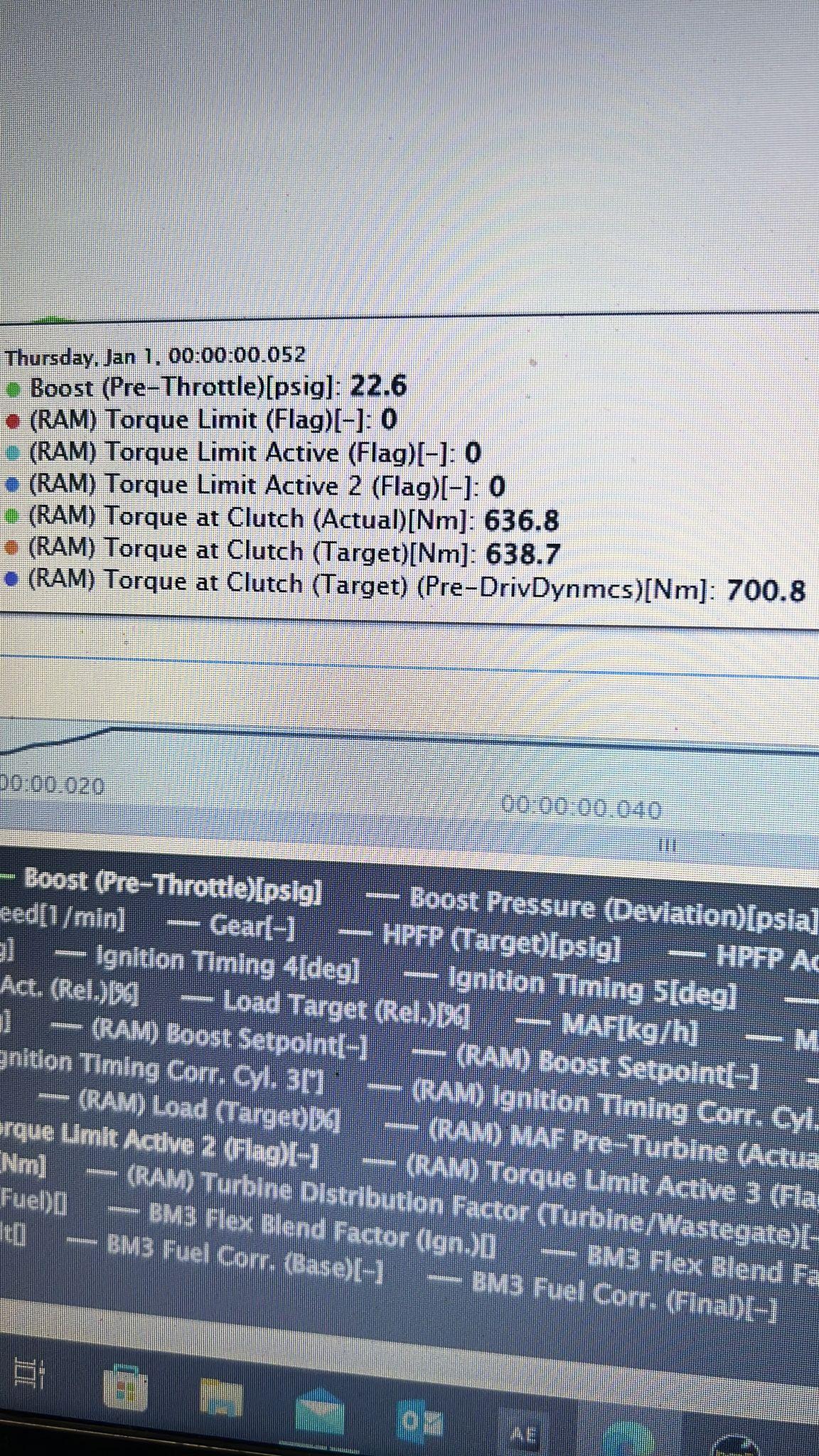

This gives me a lot of hope. What Torque numbers are you putting down?
What’s your Wtq?
Approximately 635wtq

I have not dyno'd yet, just slowly street tuning when i get the chance. I raced few friends of mine around 550whp and beat them about half a car length several times ?. The torque number based off the bm3 logs which isnt 100% accurate, i know.

that would be insane numbers for 93, that is more then e50 cars make, manual has less drivetrain loss but still haha
Yea hahah, im just going off what bm3 log register but soon i’ll take it to the dyno and show what it’s actually making. Correct me if im wrong!

That's nm and those are computed numbers.
638 newton meters is 470ft lbs.
