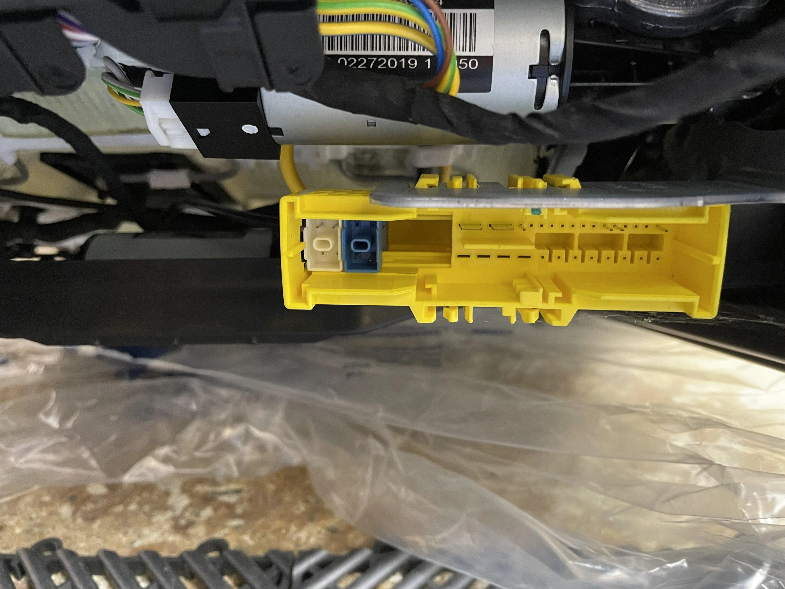

So this worked to clear the airbags errors, but it created Restraint system, Reduced driver assistance and Adaptive Cruise Control errors. It’s a 2022 premium. All I’m trying to do is leave the race seats installed and still be able to use cruise control when I’m daily driving. Any bimmergeek experts out there that could help me with this?
Did you plug the seat belt receptacle back into the yellow wire harness?

As long as the harness is connected to the seat, everything works fine. It’s only when the harness is disconnected. Haven’t had a chance to see if the seat belt attachment can be connected directly to the harness. Was hoping that someone had figured out a way to jumper the harness.

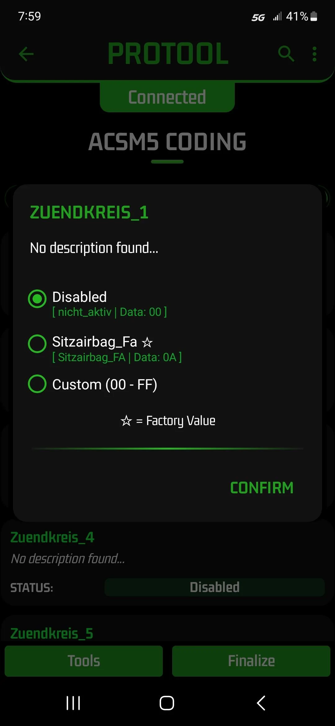

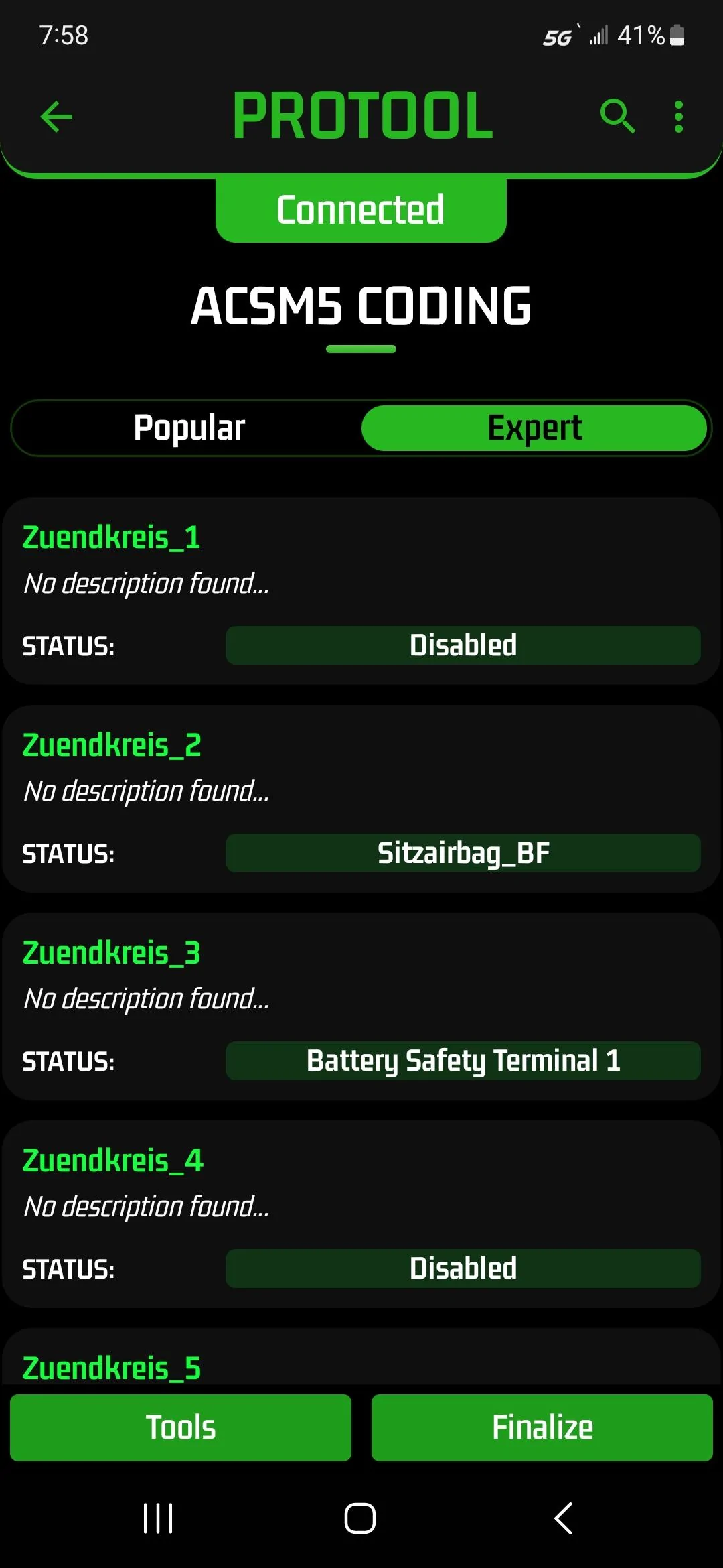

Re: Protool Master License. How do I get that? I have the app, but don't see the option to upgrade/change. Does it ask me when I connect to the car and attempt to complete certain actions?

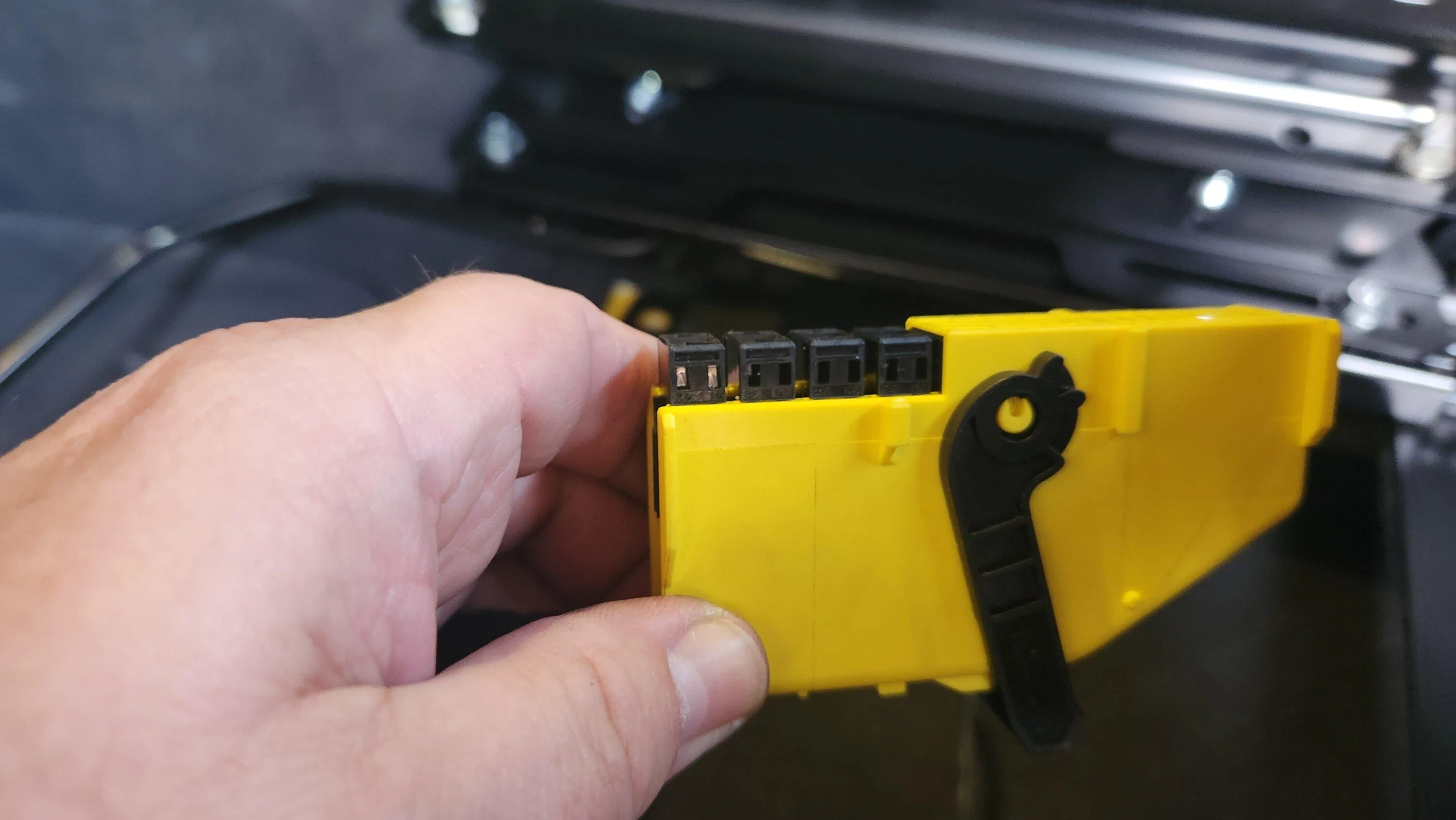

All of my plugs came out at once. Which one of these is for the seat belt? Only the first black plug looks to have any wires going to it, But I know both the airbag and seat belt plugs connected here.. ??
8,801
17,263
The black one on the far side.The seat belt wire is the white one on the female side:
So..... If this doesn't work? ,???

Yes, it's this thread, first post. The menus have changed, so maybe I missed something.
