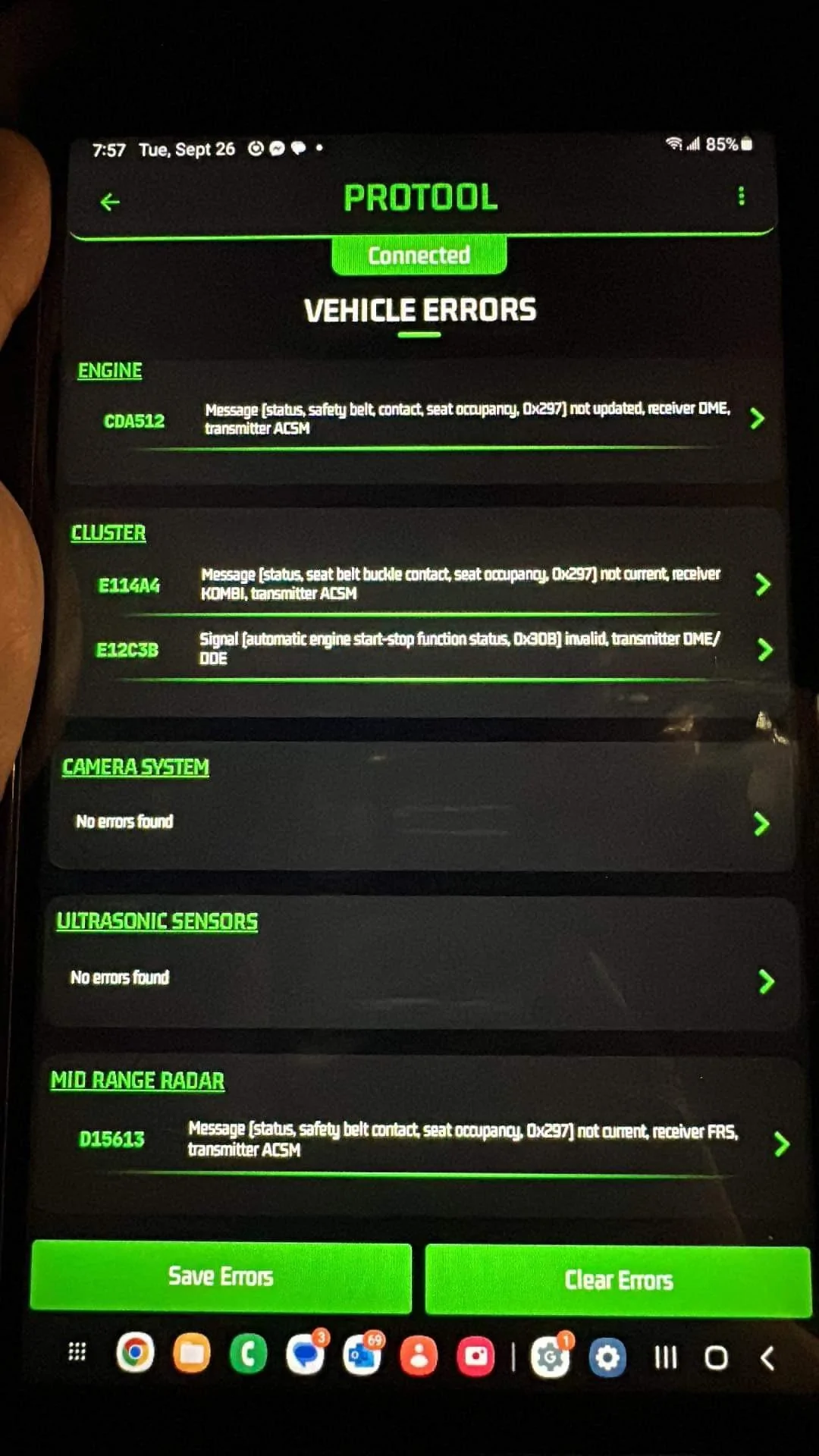

Getting this, flashing seat belt light
I scanned the car again and now got errors for cluster lol
This is never ending
Although this light flashes it’s less annoying then the driver restraint
I'll check this weekend and see what I did. Currently I drive with the light flashing.
Also, After you have it plugged in, Try turning GurtKontact back on.
oh your seatbelt light was also flashing? I put a sticker over it for now but are you going to try turning gurtkontact back on ?
I was just checking if that would remove your error when plugging it back in. But yeah, I've had the light flashing for over a year, but no major errors codes from memory.
Didn't bother me much, so I didn't look into a further coding solution.
Does your cruise control not work too? ??
Mine does, when you disconnected the oem seat from the harness coming from the floor did you pop out the specific 2 pin connector for the seatbelt receptical? If you connect those then cruise control will work. At that point you'll just get the "Driver restraint error" and everything should work as usual.

Revisiting this. Reinstalled OEM seat. Everything plugged in nicely. I am NOW getting the restraint system error.
Attempted to clear error code with pro tools. Unsuccessful.
You must go back into the coding and re-enable the airbag.
Then you will be good to go.????

Mega helpful! When your race seat was in, was the airbag error just a light on the dash? My hope is it’s like the CEL on my dash with the cat delete. Just a light. Computer/dash works fine. No errors on the screen.
