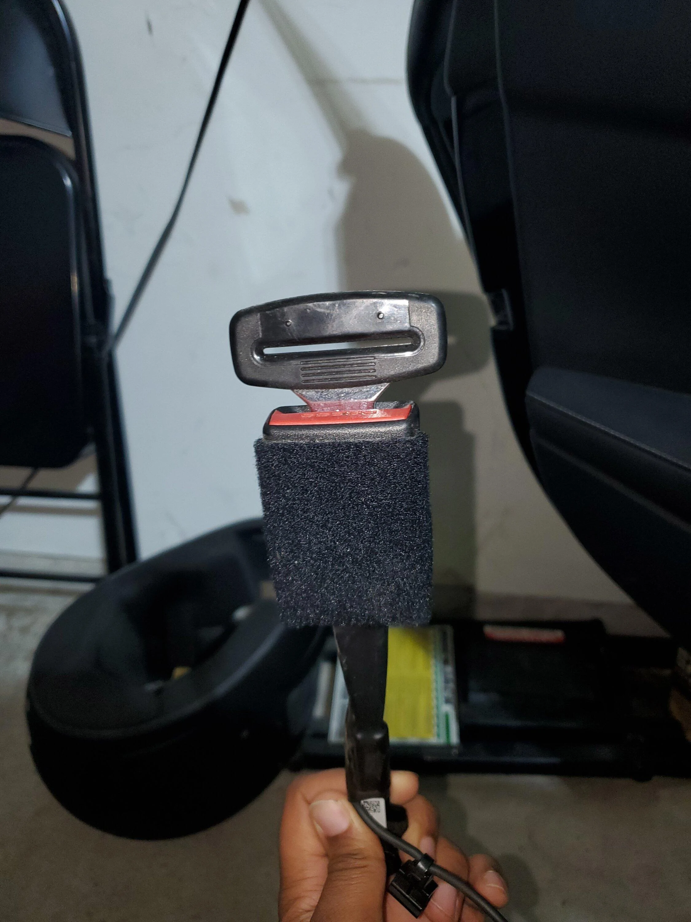

Unfortunately, If you want that light off too then yeah. I plug it in under the seat and got a extra buckle off eBay.
I know there's a company that's able to code it out. There should be an older post on mkv Supra Track FB page about who knows. But it's not free, they remote in.
Also it may be worthwhile to check on ProTools FB page. Found additional information there and was able to ask the developers questions.
I Haven't tested coding it out with Toyota's ISTA. But from memory it looked like I had many of the same control ProTools offered. So it may be possible. Someone will just have to dig.
Going through this post cause I have the blinking seat belt light after install and having Bimmer-remote code my seats in for me. Can you elaborate on how you got that light to disappear please?
