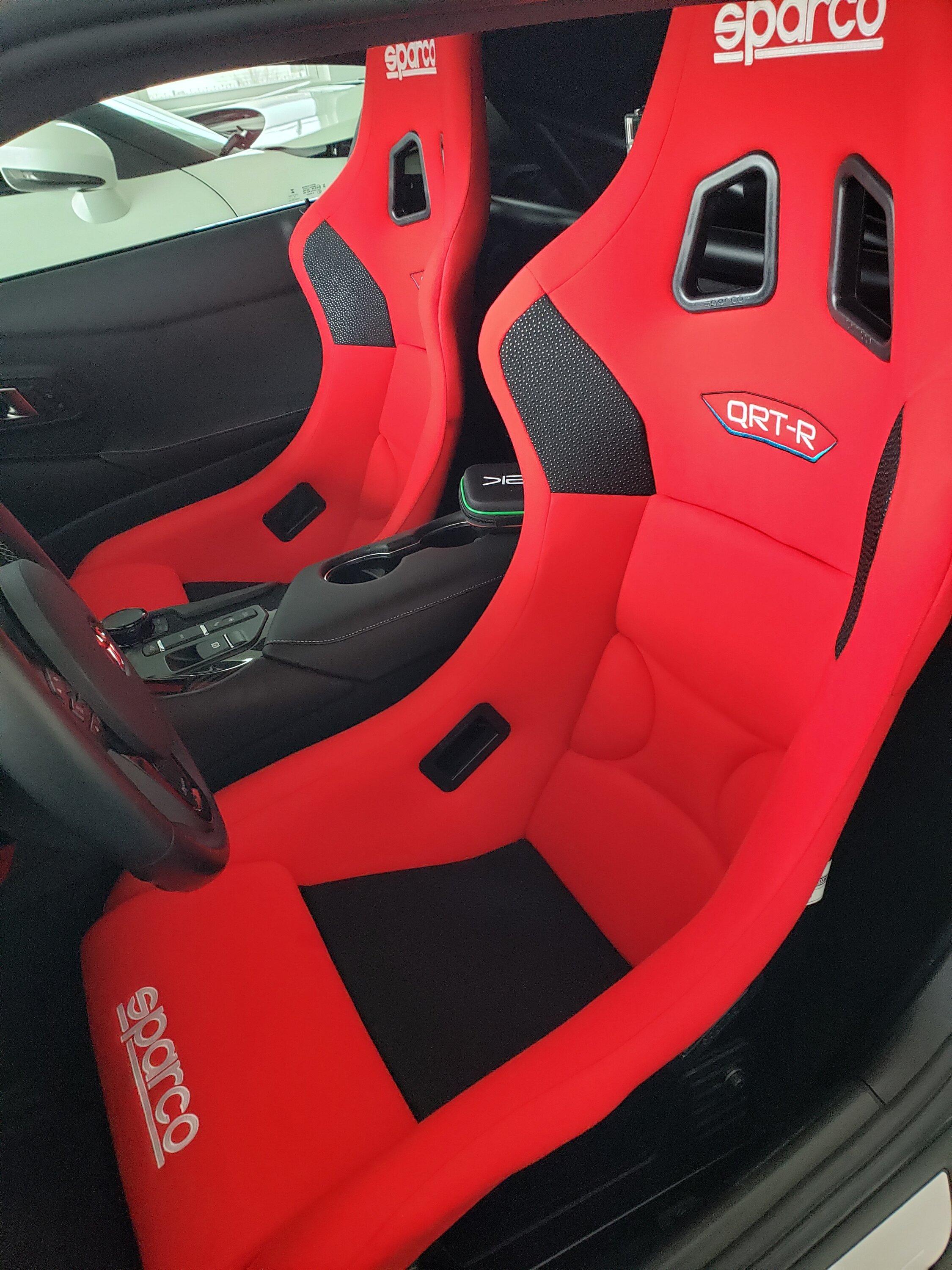

Just dropping by to say thank you for this post. Got both of my sparco qrt-r installed with no lights.
That’s my seat ?☝ - Looks even better with two of them in there…

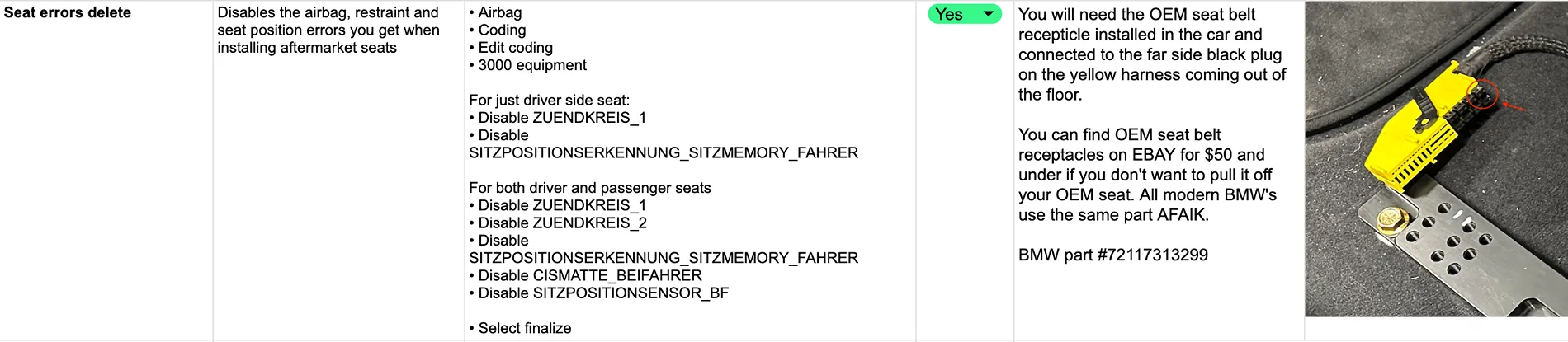

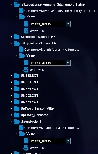

For people who do not use Protool, here is what needs to be done. I did it with Bimmer Utility.
If you only have the drivers side bucket seat.
Enter ACSM5, select expert mode
Select "3000 Ausstattung" (3000 Equipment)
Select Function
Disable (nitcht_aktiv) the following 3 functions
ZUENDKREIS_1
SITZPOSITIONSERKENNUNG_SITZMEMORY_FAHRER
SITZPOSITIONSENSOR_FA (FA is driver side, BF is passenger side)
xD_AmP

For people that have installed race bucket seats, I just confirmed that you can use Bimmergeeks Protool app to code out the airbag and seat position error.
Did it myself today in like 5 minutes.
Requirements:
Bimmergeeks Protool app (android only)
Protool Master License
OBD wifi adapter (Kies, Thor, or anything from Bimmergeeks) I used Kies
Steps:
  1. Put car into accessory mode by pushing start button without foot on the brake.
  2. Buckle seat belt (keeps car from going to sleep)
  3. Enter diagnostic mode by tapping the start button three times fast (without foot on brake!)
  4. Connect to car with Protools app
  5. Find airbag section in Protool
  6. Select "coding"
  7. Select "edit coding"
  8. Select "sector 1: 0001B29"
  9. Confirm data backup
  10. Select "3000 equipment"
Now, once in "3000 equipment"...
If you only have the drivers side bucket seat (I currently only have the drivers seat installed)
Disable the following:
ZUENDKREIS_1
If you have replaced BOTH your seats with bucket seats, disable all of the following:
ZUENDKREIS_1
ZUENDKREIS_2
CISMATTE_BEIFAHRER
SITZPOSITIONSENSOR_BF
Then select "finalize"
After that is done, close the app and turn the car off fully (once the green LED on the shifter turns off) and then restart the car.
No more dash lights or warnings!

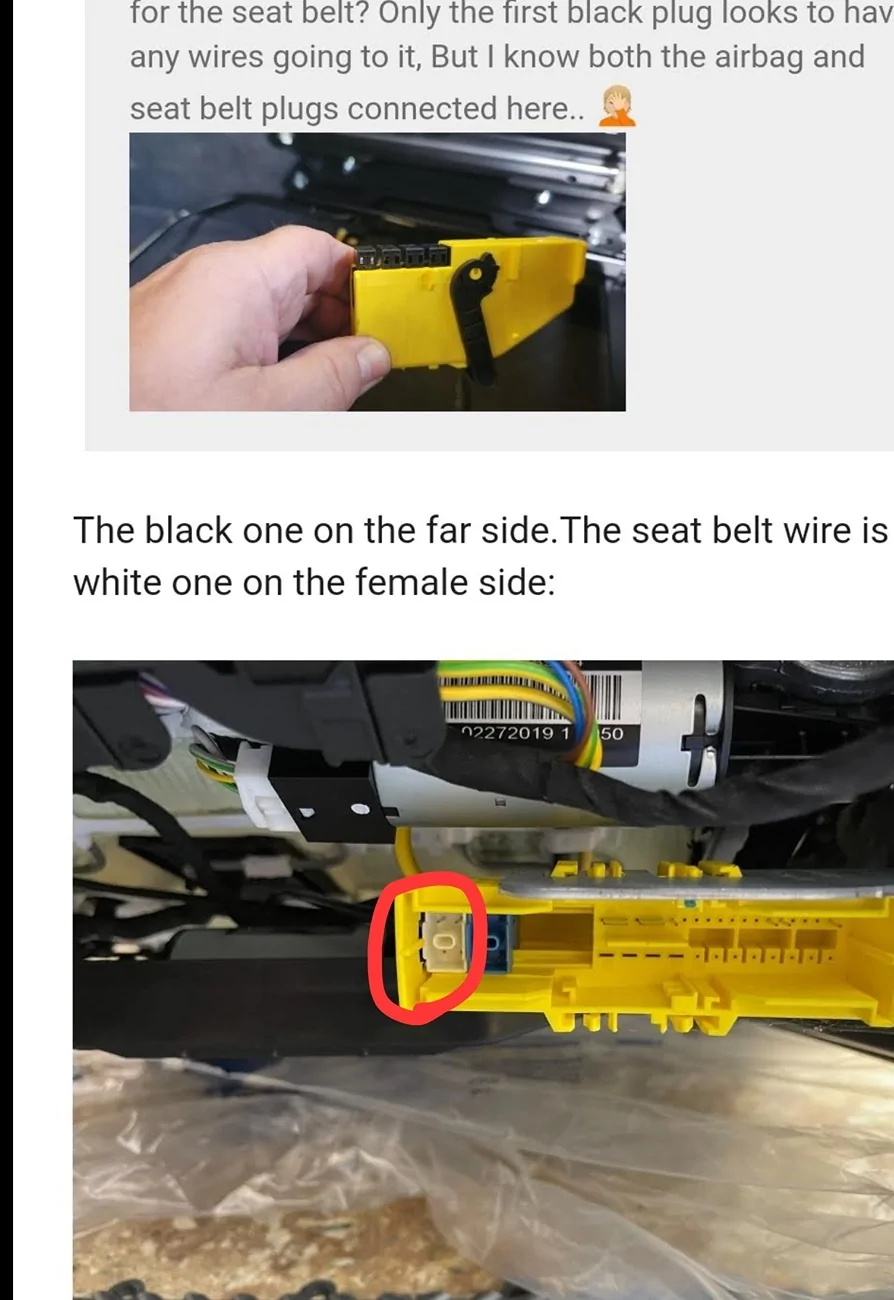

What do you have plugged into the large yellow seat connector? There should be one thing left connected.

Oh shoot, I didnt realize. Its just sitting there under the bucket seat. What should I have connected and how would I do that with oem seat out? 😅 I'm super new to this

No worries, you just have to make sure the white one is still connected.
If it makes you feel better, i did the same thing lol

Let me add to the thread. I have two bucket seats in the car with the airbag errors coded out. I recently changed my driver and passenger seats during which I unplugged the passenger side resulting in the passenger airbag warning coming back on.
To fix it I re-enabled SitzlehnenVerriegelung_Fahrer, finalized and did an ignition cycle, then re-disabled SitzlehnenVerriegelung_Fahrer. Error went away. After re-enabling it I got a driver airbag error but no passenger warning, after disabling it again both went away.
Hope this helps someone.

After doing some research, it looks like the seat belt receptacle cannot be jumped with a wire or resistor on Modern bmws.
"The creator tried various resistor values (1 ohm to 2,000 ohms) but still experienced either the screaming seat belt light or the airbag light returning (0:56-1:04)"
The reason this matters is because attaching the oem seat belt receptacle to your seat bracket is either minorly inconvenient or a huge pain in the ass, depending on your seat and bracket combo. The wire isn't long enough to attach everything out of the car, so you either need to do it with the seat all the way in, or teetering on the door sill.
Going forward, I will probably buy a spare receptacle with a dummy plug inserted, and let that whole assembly just rest under the seat. And then chop the connector off the OEM receptacle and leave it attached to the seat bracket.
