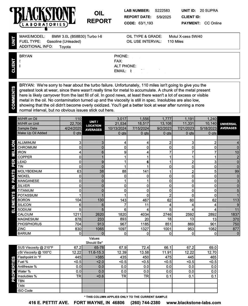

Since the entity under the bridge has probably already been rattled I'll just add some more actual factual data around oil usage.
Here is my latest oil report. As you can see it also has the last five reports as well.
Added info and context below the report
- My Supra is mainly track use, although I do drive it on the street to/from the track, when logging for tuning and for pleasure on weekends.
- Track use of a car will put more stress on it in one event than a street car sees in a year, or maybe even ever. Do I think my oil usage is one size fits all? No. Not at all. Only Boomer Blobs make stupid stuff like that up from things I state.
- As of the report above, my Supra has done about 65 track days. 2,353 laps, 53 hours of track time. 3/4 of those are with more power than OEM and about 30 of those have been 500whp+
- I have used Motul X-Cess 5w40 since 1200 miles.
- Not that I give two shiats, but Motul X-Cess 5w40 is in the approved list of BMW oils I posted on post #1 in this thread. Don't let Boomer Blobs dismiss an official BMW document because it doesn't fit their narrative.

Thanks for replying. Looks like you got an outlier for the calcium measurement on 7/15/2024.

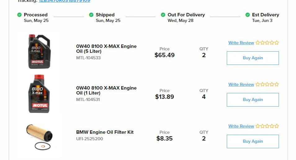

I ended up going with Motul X-MAX 0w-40. Will be doing UOA with blackstone and reporting back :)
