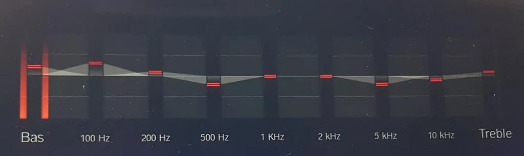

Anyhow, two 6” JL woofers and one 10” JL TW-3 now give me excellent mid bass and lows. 500 watt 3 channel amp behind front seat. Signal grabbed from the woofers with a high pass to the 6” woofers from the amp. Sorry for picture quality, I grabbed a quick pick before leaving it to be wrapped.
