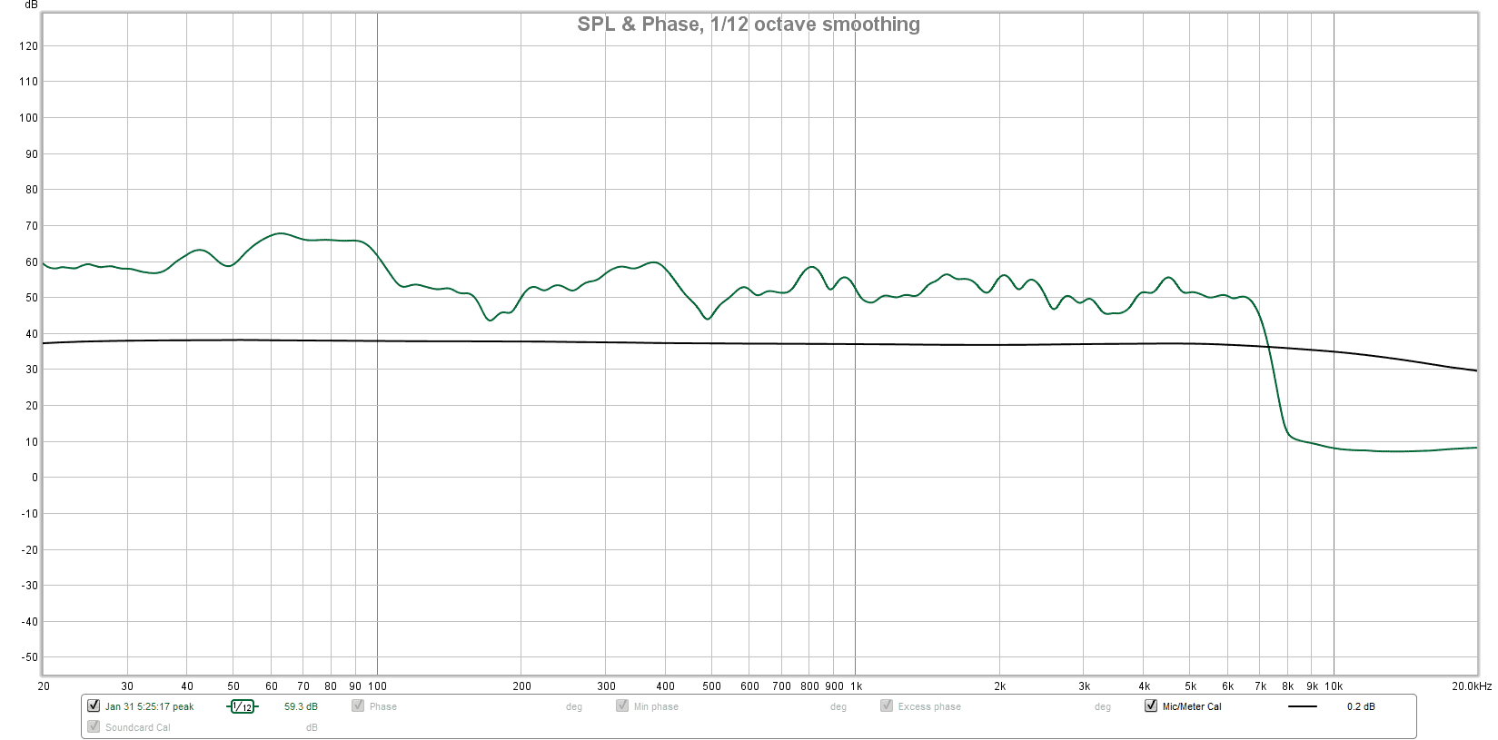

This what I set mine at for a natural clean sound
If you did that by ear alone... you've got pretty good ears! :D I've got much more to do (like find a better sine sweep file that's not passed at 8K for one thing) but about all I see different is in the 500Hz where there seems to be a bit of a suckout (I added a +1 click there). Everything else pretty matches up with where the default settings fail (i.e. boost bass, cut 100Hz a little, boost 200Hz a decent bit, etc.) :hmm:
Ignore the treble... I'll get that sorted and find my ear plugs so I can run something higher than 60dB... (sweeps give me a headache after a bit).

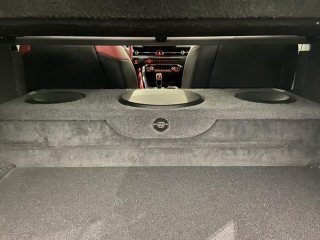

I just picked up my car from getting the sound work done and dropped it off to get it wrapped immediately after.

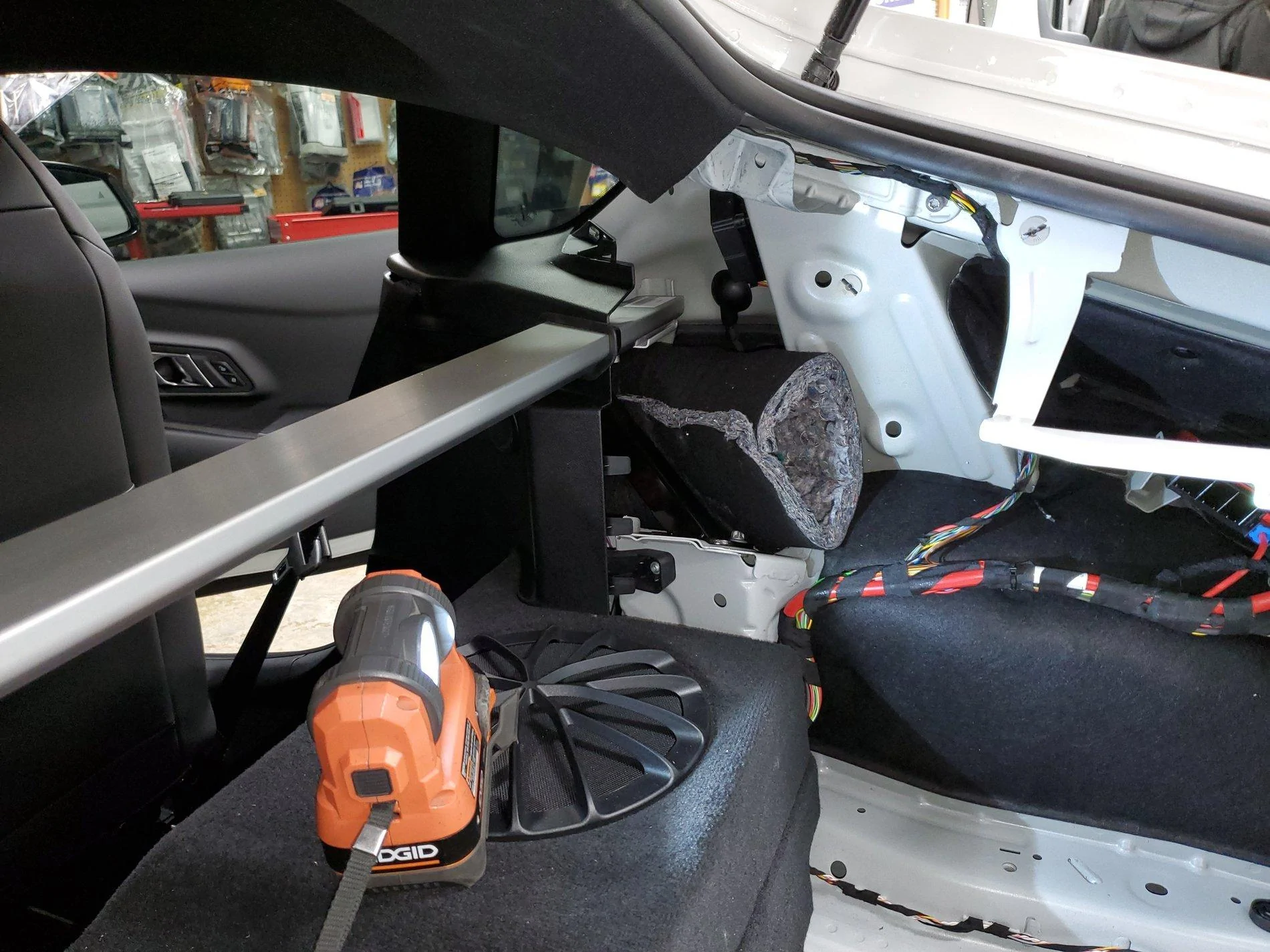

If you modify the central area where the 8” woofers are to put in a sealed box, you will have to relocate some electronics. Mine have been moved back closer to the battery so that they are now accessible without taking out half the car. The only issue is that the active sound during sport plays a LOW tone that resonates something only when stopped. Otherwise it just sounds meaner and not overpowering. Other than that, no rattles. I will need to have the installer chase that down once I get it back from wrap.
FYI - If your seats are removed, make sure the car stays powered off (negative post) or you will have airbag and seatbelt notifications that will need to be cleared. If the interior gets dinged, parts are to be here for the holidays, so be careful.
Anyhow, two 6” JL woofers and one 10” JL TW-3 now give me excellent mid bass and lows. 500 watt 3 channel amp behind front seat. Signal grabbed from the woofers with a high pass to the 6” woofers from the amp. Sorry for picture quality, I grabbed a quick pick before leaving it to be wrapped.
The signal is pretty flat for being in a car. I noticed that when I ran some sweeps before EQing. That is why it sounds so terrible to most. Flat typically doesn’t sound good. A JBL or similar house curve typically grades better on listenability.

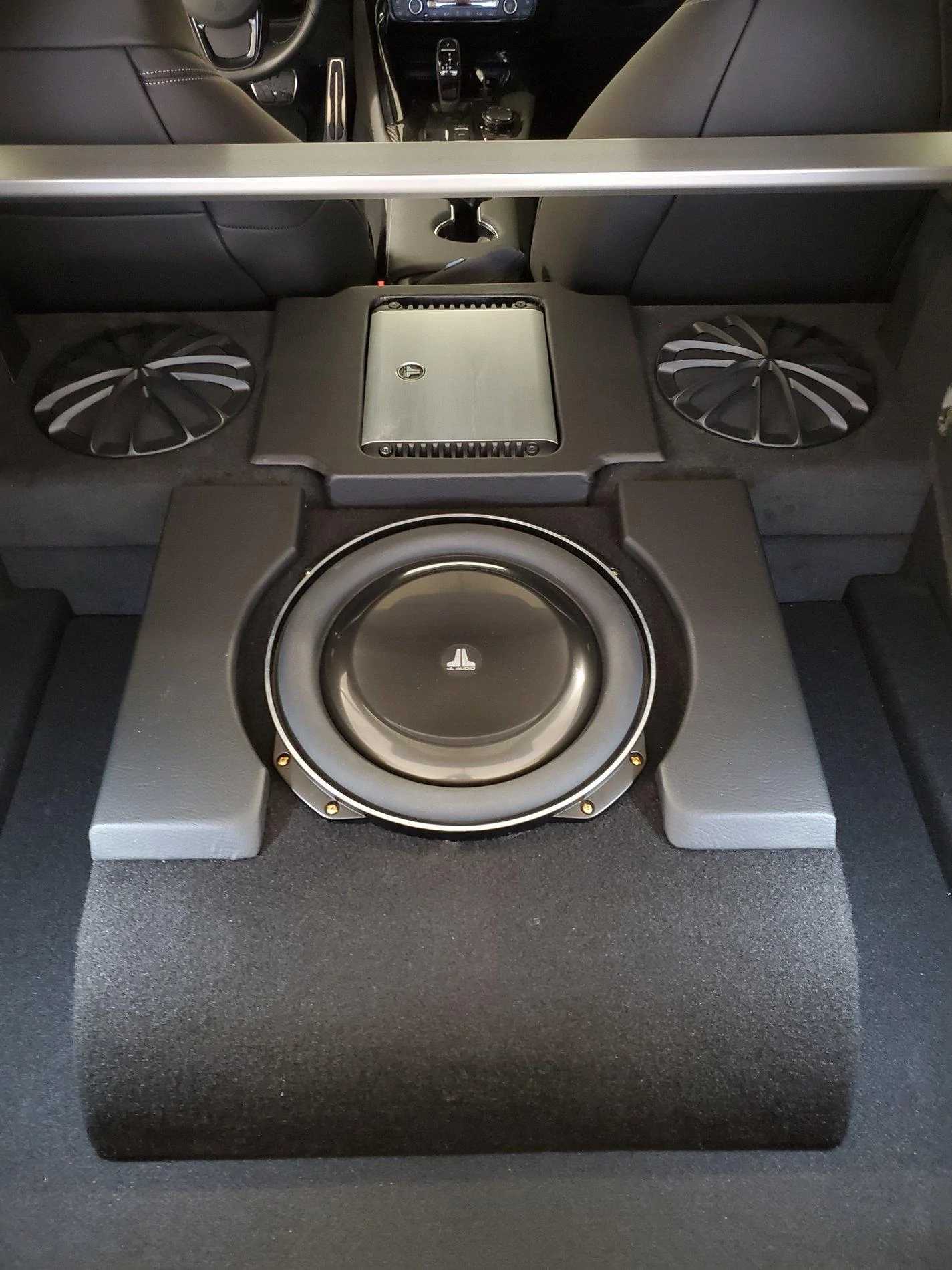

I added a JL 13TW5 and a JL 750.1. I got signal from the factory amp using the subwoofer signal. The problem I have is the LOC (LC2i) only turns on signal power to the amp when the volume is up pretty loud.

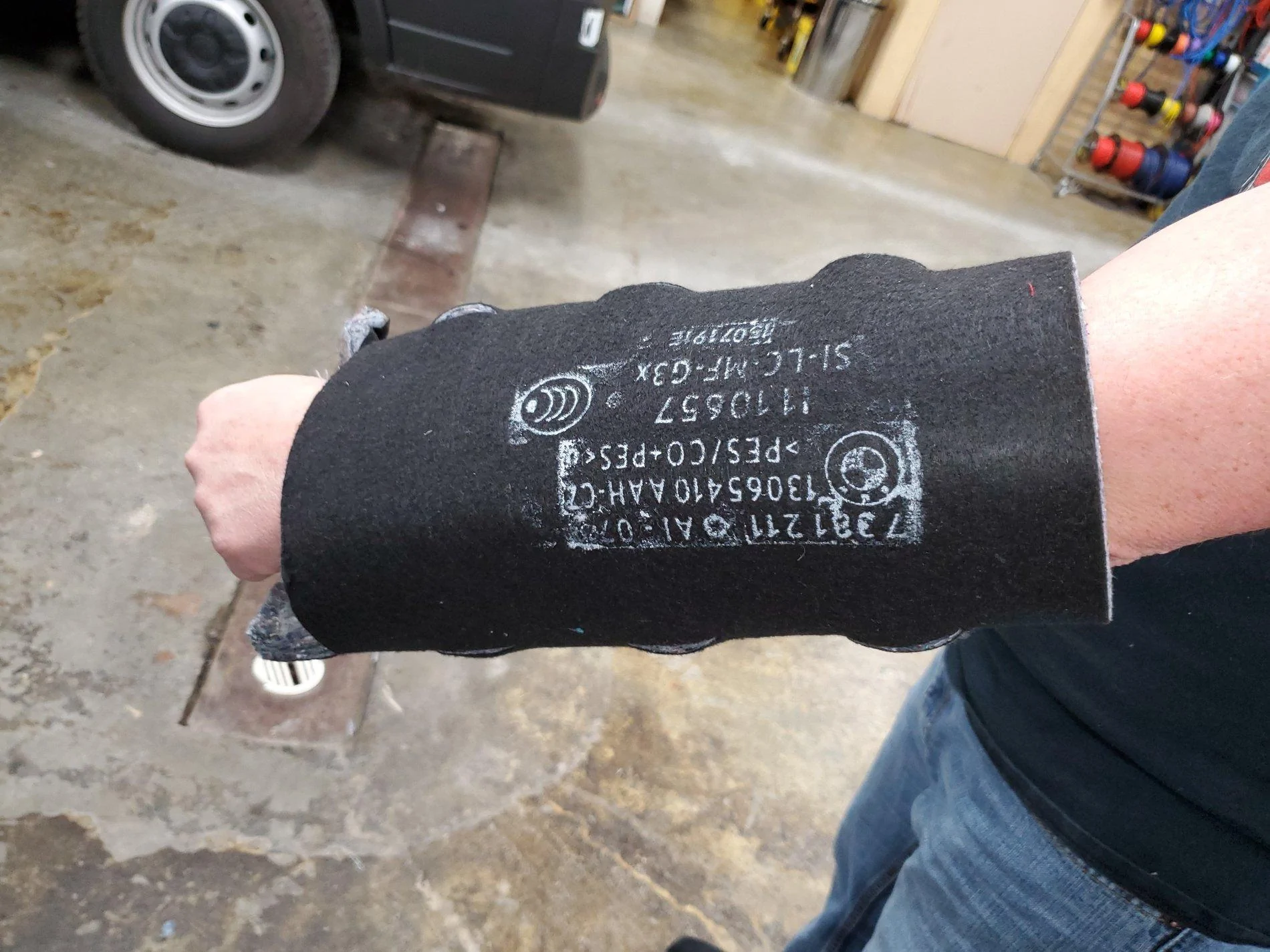

Oh and if you take your supra apart, you get free sound deadening gauntlets!

Jason, you said you grabbed signal from the woofers-can you tell me exactly how you did that? I used an LC2i but the amp only turns on when volume is up-its acting like there is not enough signal coming from the factory sub wires to trigger the loc at low volumes.
The factory sub channel cuts out around 200-220 Hz so they have a low pass filter on those outputs somewhere lower than that. The issue in using that for your signal is low end frequencies are not constant enough even when played loud to keep the LC2i from timing out.
What I did to fix it was to add a Wavtech iRAD to generate a remote signal as pulling one would have been a pain. The remote wire should leave the iRAD, go to the LC2i, then from the LC2i to your amp. That way your signal pathway to the amplifier starts up correctly and you don’t get any thumps on startup.
For the iRAD, you feed it Positive and Ground and it generates a remote signal based on some logic. For it to generate and kill the signal correctly, it needs to be programmed which isn’t too difficult.
EDIT: Install looks good. I had thought of doing similar. I just couldn’t live with losing trunk space as I work out of my car and it’s filled with work stuff. I also want to add a small spare, so I had to settle for cutting up my rear deck.
Yes. Actually it does have a bit of the JBL/Harman curve (~10dB slope). Part of the problem I think many have with the sound in the Supra, is that those trends are most appreciated at close to reference levels. Unfortunately, the system in the Supra isn't able to achieve those without significant distortion (especially in those "subs"). At much lower levels it sounds pretty accurate to me - with the car off - but once you add road noise, etc. the sound becomes too lifeless.
I doubt there was that much thought given to it, but it seems that the system was tuned as if the subs were to be fully sealed and given more power than they wound up with in the production version.
